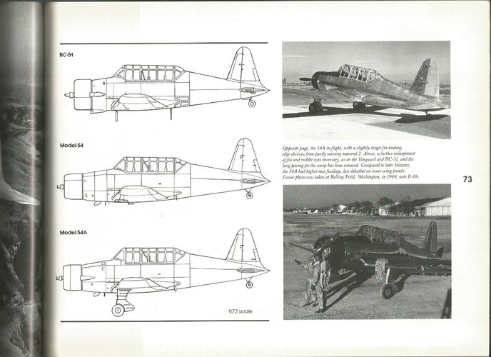

  • BC- for Basic Combat (e.g. BC-51, BC-54)

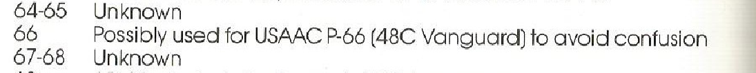

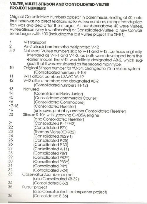

I search for pics and/or drawings of the Vultee V-85 "Vengeance" dive bomber version and the only V-89 "Vengeance" test bed for the Wright R.3350 engine.
Thanks for your help
This is a big mistake !!!!!
The V.65 you mention here is NOT a Vultee model, but a VOUGHT V-65. The Brazilian side is completely wrong.
Hi Maveric
Profuse apologies and thanks for catching my mistake. I see that this is actually the Vought model number of the well-known O2U Corsair, which I should have realized. This was the only mention I found of a "Vultee V-65" of the 30's and I ran with it. I have deleted my post. Regards, Harry
I had a go at compiling a list of Vultee Aircraft's Model numbers. That Vultee designation list will follow. First, I want to list the evolution of both Jerry Vultee's aviation career and that of the corporate entities which bore his name.

Vultee Aircraft Designations
Here, prior to listing Vultee Aircraft's Model numbers, I want to address some details, assumptions, and questions relating to Vultee's designation approach.
In my list (next post), I have arranged Vultee Model numbers numerically for ease of search (and compilation) but Vultee was apparently much less concerned with such orderliness.
There is an overlap between Vultee Model numbers and those of Vultee's subsidiary, Stinson. Unfortunately, the tendency for list-makers is to try to push those Stinson numbers into the Vultee system. To address this, I will be listing - as 'Vultee-Stinson' - any Model numbers which overlap. An example using unbuilt projects is the Vultee Model 78 Shrike export fighter (related to the built Model 84/XP-54) and the proposed Vultee-Stinson Model 78 navigational trainer intended for the US Navy. I hope that this approach does not just add to the confusion.
Vultee Designation Prefixes
Beginning with the original V1, many Vultee model numbers were given 'V' prefixes. As a result, the assumption is often made that Vultee Model numbers and 'V' prefix 'short forms' are simply interchangeable. But that is not necessarily true. Often, only Model numbers are referenced. Later list-makers have then attempted to retroactively rationalize the system by imposing 'V' prefixes on every number. To avoid that, I have stuck to listing types by Model numbers with a note on 'V' numbers appended. Take the latter inclusions with a grain of salt - at this stage, it is all but impossible to weed out after-the-fact 'V' prefix additions!
There is at least one example of a 'V' prefix being applied after-the-fact by Vultee itself - or, at least, by the marketing department. This was the application of 'V-77' to refurbished war-surplus Stinson SR-10 Reliants for the postwar civilian market. Here, Vultee may have been applying an un-used Model number for marketing purposes. On the other hand, we cannot discount the possibility of an unrelated wartime 'Model 77' design which has escaped our notice.
I have also noted - within individual entries - Vultee's on-again, off-again use of specific role prefixes. Where these overlap with USAAC/USAAF designation style - like 'XP' and 'BC' - there is plenty of scope for potential confusion within sources. Stéphane has listed and defined those prefixes in the original post. Here, I would only note Lark's correction on the 'XC' prefix which stood for 'Experimental Commercial'.
Vultee Style Presentation and Suffixes
As with the Model/'V' number muddle, there are also after-the-fact attempts to rationalize the actual style of Vultee designations. I too was tempted to impose a single style. Alas, the first prototype and production type make that impossible.
As near as I can tell, V1 and V1-A were the correct forms for these first Vultee products. That '-A' suffix indicated a heavily-modified production variant. Other suffixes follow - eg: V1-AD (for Deluxe 'A model) and V1-AS (for Special 'A model). But, for example, there was never a 'V-1A' (how ever much more rational that presentation may appear).
Thereafter, an additional hyphen made its way into Vultee designations - eg: V-11-A. Today, it is very common to see such Model numbers collapsed down to 'V-11A' and the like. And that style does fit with Vultee's later form for internal designations. However, it seems not to have been the contemporary style of presentation. That V-11-A was part of a raft of suffixes. These were (in alphabetical order):
---- A = V-11-A; the revised, second V-11 prototype
---- G = V-11-G; indicating Wright SGR-1820-G2 engine
--- GB = V-11-GB; indicating as revised, 2nd type V-11-G
-- GB2 = V-11-GB2; a further V-11-GB revision (for Brazil)
- GB2F = V-11-GB2F; 'F' for Float; experimental floatplane
-- GBT = V-11-GBT; 'T' for Turkey/Turkish; V-11-GB variant
-- SBS = V-11-SBS; 'SBS' for Scout Bomber Seaplane
--- ST = V-11-ST; meaning unclear, poss. 'Scout Torpedo'?
---- T = V-11-T; 'T' for Testbed; mod. V-11A engine testbed
--- TS = V-11-TS: 'TS' for Torpedo Seaplane; same as 'ST' (?)
Suffixes become somewhat confused with the next development - the V-12. The known models are the V-12-C and V-12-D which seem to suggest successive model types. Alas, there is no sign of any 'A' or 'B' suffixes. More probably, those suffixes indicated engine types. Under that supposition, the V-12-C would have been 'C' for Cyclone while the V-12-D would be 'D' for Double Cyclone.
To further confuse matters, Vultee's marketing department adopted the alternative designation AB-2 ('AB' for Attack Bomber) to promote the V-12 series aircraft (or possibly just the V-12-C?).
Later on, Vultee aircraft are given sequential sub-type letter suffixes. But, even then, there are some oddities. Eg: the second model of Valiant was the Model 54A as expected but an alternative designation was apparently VF-54A - with the 'F' prefix standing for Fixed main undercarriage type.
Vultee Designation Numerical Sequence
Quite logically, the first Vultee type is numbered '1', as in the V1 and V1-A. However, the second type is the V-11 series - with no sign of Model numbers being applied between 2 and 10.
The third type is the V-12. And note that all three designs are closely related.
The next Model numbers seem to be for the unrealized Model 20 and Model 32 of which we know virtually nothing. That seems to suggest that Vultee was applying its Model numbers in related groups by tens. The problem with that supposition is that the '30s' don't fit. The Model 33 (XOB-33) may well have been related to the equally mysterious Model 39 observation-bomber on floats. But there's no possibility that such plodders would be directly related designs to the ultra-sleek Model 35 export fighter.
After that, the application of Model numbers does seem to be somewhat random and often not ever sequentially applied. What is generally agreed is that the Vultee Model numbers run from 1 through to 90 where they conclude. After that, a new Convair sequence began (based on one of the many Consolidated series).
Vultee Designation Anomalies
Relating to the Vultee sequence ending at '90', hesham has noted that the earliest incarnation of what becomes the XA-44/XB-53 project began with Vultee's design department. This raises a question: Were these early draughts of the XA-44 ever assigned a distinct Vultee Model number? Here, hesham asserts that what becomes the Convair Model 112 was originally given a Vultee Model number somewhere in the 90s.
Another set of Vultee designation anomalies may fall entirely outside of that 1-to-90 sequence. These are a handful of 3- and 4-digit designations - known examples being XP-690, XP-1015, and XC-1031. There may also be an XP-236. For such anomalous designations, there are no known Model numbers within the Vultee 1-to-90 range.
At least two of those anomalous designations are related to the Model 35/XP-35 export fighter. These are the XP-1015 (sometimes seen as XP1015) and XP-236 (XP236). The latter was a Model 35 'configuration variation' - although intended for whom is not clear. The XP-1015 was aimed at the USAAC, being an enlarged, US-engined slightly XP-35 evolution. Accordingly, I have included mention of both XP-1015 and later XP-690 within the listing for the Model 35.
The XP-690 was to have been a twin-boomed pursuit design but, in the absence of a known Model number, I have made no mention of it within the list. I have mentioned the XC-1031 (XC1031) because of the suggestion that it might be one and the same with the otherwise barely-known Vultee Model 41. However, note that that Model 41 to XC-1031 association is based solely on them both being 'cabin types'. This association may well be accurate. But it is just as likely that one of the 'missing' Model numbers was connected with the XC-1031 ... or that the XC-1031 fell outside of the Model number list altogether.
I have also noted hesham's speculation that the Model 43 light fighter may have began as a hypothetical 'XP-1043'. This is pure supposition, of course, but not impossible. If we follow the logic of that approach, we might connect the 'missing' number '31' with the XC-1031. But, then, we must explain why the '15' suggested for XP-1015 numerically prefigures the Model 35? And what contractions are we to make of the XP-236 or XP-690?
Since we are in the realm of supposition, we should also consider the possibility that these 3- and 4-number 'designations' are not designations at all. Since XP-236 was a 'configuration variation', we might assume that all such anomalies represent 'configuration variations'. Other possibilities are that the anomalies represent immature incarnations which may (or did) receive 2-numeral Model numbers later. Or might the anomalies simply represent some numbering system for concept drawings? We simply don't know and require more hard, primary-source evidence.
My Vultee designation list will follow in the next post.

Vultee Model 20 - (??) no details
Vultee-Stinson V-20 - S-101 with Lycoming O-435A HO6
21-31 - (??)
Vultee Model 32 - (??) no details
Vultee Model 33 - (Project) Observation-bomber floatplane
- Model 33: aka XOB-33; no other details
- Model 33: Possibly related to the Model 39 (qv) (??)
34 - (??)
Vultee Model 35 - (Project) 1937 XP-35 twin-engined fighter
- Model 35: Single-seat, slim-fuselaged interceptor design

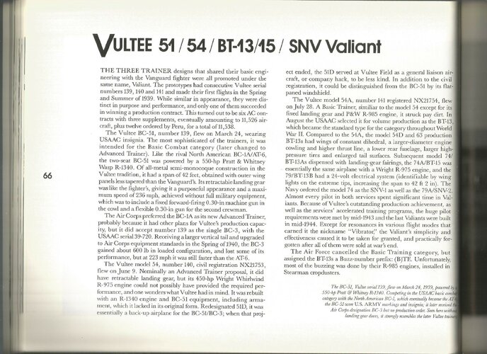

Vultee Model 51 - 1939 USAAC Basic Combat trainer, x 1
- Model 51: aka BC-51, unsuccessful comp. w/ NAA BC-2
- Model 51: All-metal const.; hydraulic flaps & main u/c
- Model 51: 1 x 600 hp Pratt & Whitney R-1340-S3H1-G
-- USAAC bought BC-51 prototype as sole Vultee BC-3
-- Palmer evolved V-51 into fixed u/c V-54 or VF-54 (qv)

Vultee Model 54 - Advanced & basic trainer types
- Model 54 : Advanced trainer design; aka V-54
- Model 54A: aka VF-54A; fixed & faired main u/c
- Model 54B: (??) hypothetical designation
- Model 54C: (??) hypothetical designation

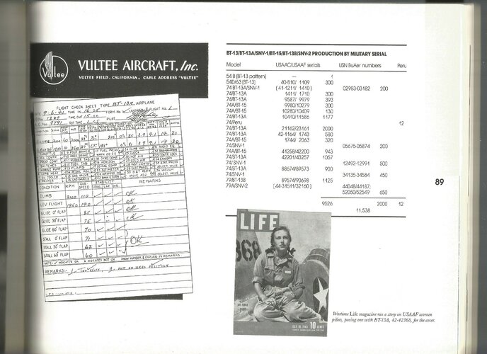

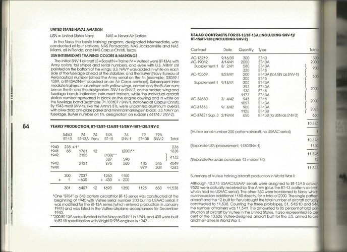

- Model 54D: USAAC/AAF BT-13 Valiant; USN SNV
-- BT-13 : 450 hp P&W R-985-T3B Wasp Jr.; x 300
-- BT-13A: 450 hp P&W R-985-AN-1 9-cyl.; x 7,037
-- BT-13A differed in military engine; no u/c fairings
-- BT-13B: As BT-13A except 24v (not 12v); x 1,125
-- NB: BT-13B may have been original Model 79C
-- BT-15 : 1 x 450 hp Wright R-975-11 9-cyl.; x 1,263
-- BT-15 : May have internal desig. Model 74A (qv)
-- XBT-16: 1942 BT-13A w/ Vidal moulded fuselage
-- SNV-1 : US Navy version of the BT-13A; x 1,150
-- SNV-2 : US Navy version of the BT-13A; x 650
- NB: SNV-2 may have been the orig. Model 79A

Vultee Model 61 - 1939 light fighter; re-desig. P-48X
- Model 61: Interim desig. for 2nd prototype Model 48
-- Flew Feb 1940 as prototype Model 48X (NX19999)
- Model 61: Poss. originally Model 48 alt. layout [2]

64-68 - (??)

Vultee-Stinson V-70 - Rebranding of Vultee-Stinson V-74
- Stinson V-70 : To avoid confusion with the V-74 Valiant

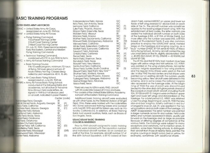

V-66 was a possibly used for USAAC P-66 (V-48C Vanguard) to avoid confusion
My dear Apophenia,
please add V-66,andfor some Info about Model-54.
My dear Apophenia,
My dear Apophenia,

I will not be adding the 'V-66'. I do not deny that this supposition has found its way into print. But nor do I find this postulation very convincing - after all, Vultee wasn't compelled to create 'match-ups' between its Model numbers and other USAAF designations.

I discovered that,the series 1000 which later delete this number to be
only two digitals was as following(my suggesting),
XP-1015 equal V-15
XC-1031 equal V-31
XP-35 equal V-35
XP-46 1,2 & 3 equal V-46

V-55 was a scout bomber project of 1939
V-56 was a single or two-seat,as a fighter or a light bomber,project of 1939
Hi hope this is the right place! I am trying to track a Vultee marked VP- JAG. This was located in Jamaica back in the early 50’s?
Hi William! Not quite the right place, but I've found what you were looking for on another web page, that of the late Joe Baugher.
According to his very well documented site, VP-JAG was the civilian registration given to former U.S. Navy Vultee SNV-2 Valiant (USN BuAer serial number 52262, manufacturer's construction number 79224). The airplane crashed on Jan 24, 1948, killing its owner, and the wreckage was sold for scrap. Please note that the "VP-" prefix was simply the international code for aircraft registered in Jamaica, so the "V" in it had nothing to do with Vultee, just a coincidence. Hope this helps!
Source page: https://www.joebaugher.com/usaf_serials/1944_1.html
