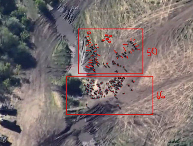

Clusters have upside of spreading the explosive out over a wide area, bout 50 meters radius for the old M26s, that gives you uniform coverage of the Tungsten Ball bearings, same as used in the Alt warheads, for a 75 meter effect radius with a high chance of one the clusters landing side the holes to shred what ever inside. With each bomblet having a 10 meter shred raduis.
So that basically a 50 meter targeting error allowance so you can basically shotgun an area and be extremely sure of giving someone a bad day.
Like theres videos of Ukraine putting a cluster into a Russian Trench...
The word Blender cames to mind as the bomblets got spread through the trench lines and positions.

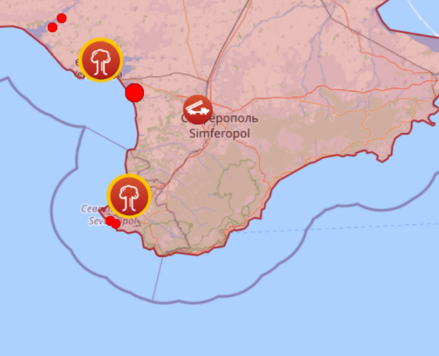

There's nothing on liveuamap yet, so either nothing or an intercept maybe.

Seems it has started to rain ATACMS, today. The above, and Dzankhoi - take three. Remains to be confirmed, but it would make limited sense.
