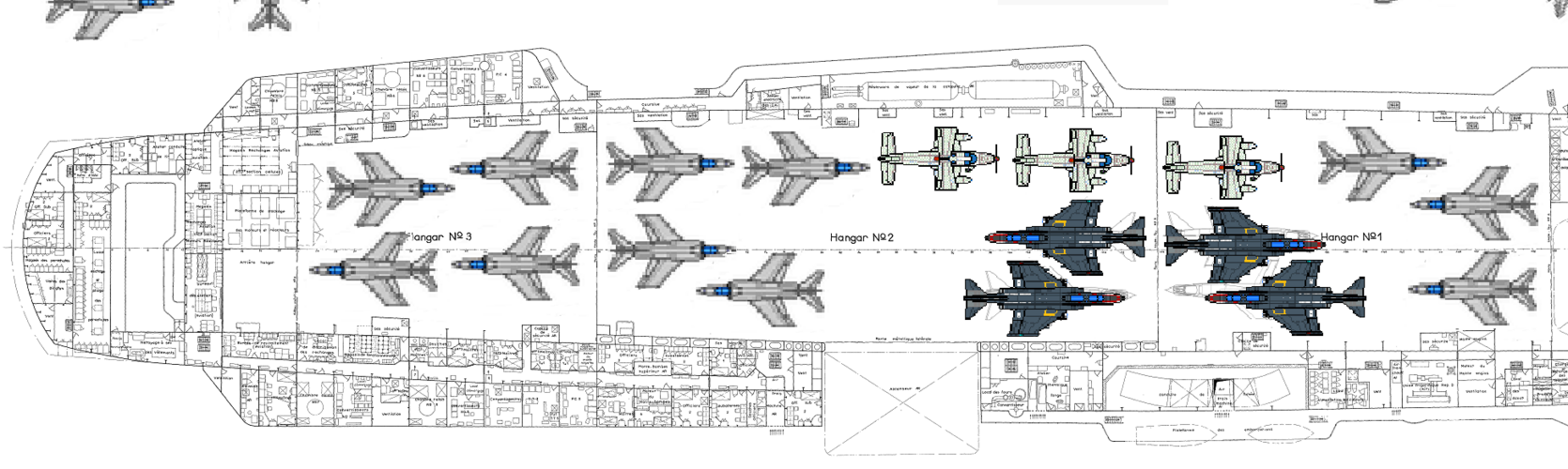

On a slightly OT note, considering that the Clems had very high hangers. It might be possible to rework this down and spend the metal weight strengthening the deck for F4s.
Though strictly the cheapest longterm option is to sell the Clems to help fund the PA.58s.

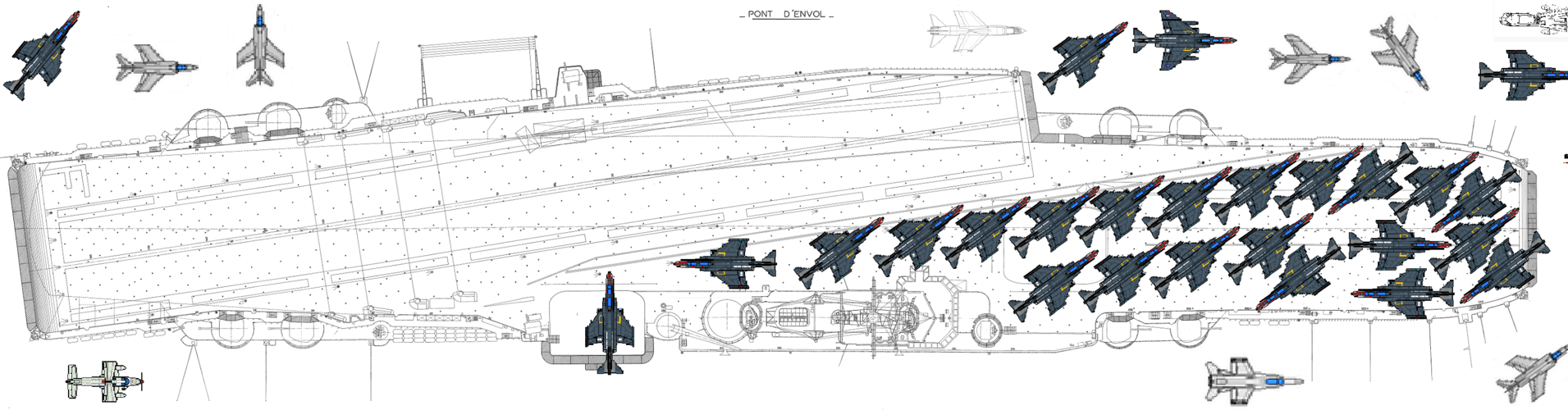

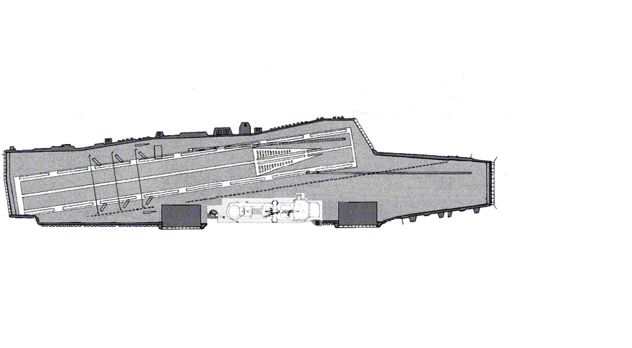

This image was and streching version for Clem
"here is a ~30 foot stretched Clemenceau... the stretch includes the forward part of the angle deck, this gives a angle deck length of ~615' including the round-down at the stern, compared to the ~580' of my earlier mod and the original ~560'.
I moved the angle cat forward to match the stretch.
The forward elevator and island were not moved in relation to the rest of the hull, therefore the forward edge of the elevator is now 245' aft of the bow at the waterline, and is at the 30% point of the 820' waterline length.
So instead of a 869'4" overall length the new version has basically a 900' length, with a corresponding 55' increase in the length of the angle deck over the historic ships. We also have two BS-5A 199' catapults, along with two deck-edge elevators.
However, Clemenceau's boilers were rated for 640 psi @ 842 degrees F, compared to the British 400-440 psi @ 600-750 degrees F and the US 575-600 psi @ 850-900 degrees F for the Essex & Midway classes.
The higher pressure & temperature of steam means it would be possible to replace the catapults with the US C-11-1 (operating pressure 520 psi), which is actually a bit shorter than the BS-5 (240' total installed length with 215' stroke vs 268' total length with 199' stroke).
Clemenceau's elevators were rated at 33,000 lb capacity, and were ~54' long & ~34' wide.
The F-4J weighed 30,770 lb empty, and was 58' long, and 38' 5" wide (~28' folded).
This meant that the elevators would be marginal, and you would need the folding nose of the RN's Phantoms to fit onto the elevators.
The hangar was 499' "usable length" (I have seen 590' listed, but that was including the forward elevator and the engine shops aft), 72'-79' wide, and 23' high.

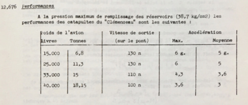

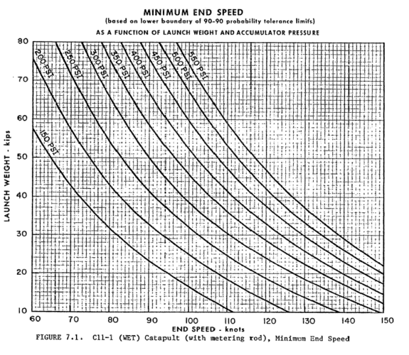

I have been trying to make sense of the early catapult evolutions (bxs-1, bs4, bs5, c-11, c-7) and it is all quite confusing.
The Clems had a bs5 with 157 ft stroke that was operated up to 550 psi accumulator pressure, but at least before the F-8 refit, the performance was very similar to the bs5 with 151 ft stroke at lower pressure (350-400 psi?) and much lower than the length difference to the C-11 (520 or 550 psi?) would indicate. Lots of details in the excerpt from a french training doc from 1962 here: https://forummarine.forumactif.com/t4957p50-porte-avions-et-catapulte

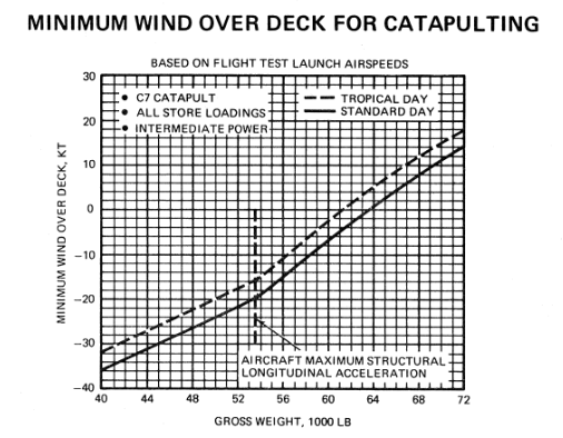

For performance
The numbers often quoted are 10-15 kts higher than this, and F-8 (and F-18) operation would also be very marginal with this, so probably some improvement later on. Unclear though where it came from, maybe wet accumulators as mentioned in the doc.
Anyway, as the table shows, the bs5 could be operated at 550 psi (38,7 kg/cm2) already and C-11 would not help in that regard. Seems the higher pressure had already been tried on the bxs-1 and the C-11 was also not modified for higher pressure.
For performance

Well, the interesting thing is: The C-11 was about 25 kts "stronger" than the short bs5.
A higher pressure bs5 should add 10-15 kts, a shorter C-11 should mean about 15 kts less. Which puts the Clems right between the two and into the region of the bs5a (longer waist cat of Ark Royal) and could launch standard F-4s at light weights (~25 kts wod for 4 sparrows and internal fuel).
The 75m catapults in the PA-58 would equal the C-7 in pressure and stroke length. So this carrier could catapult, for example, Tomcats.
The missing link in this is how the RN and probably also the MN and the RAN improved the bs4/bs5. But I could not find any information on the acculumator pressure and characteristics in Ark Royal (or CVA-01, for that matter).

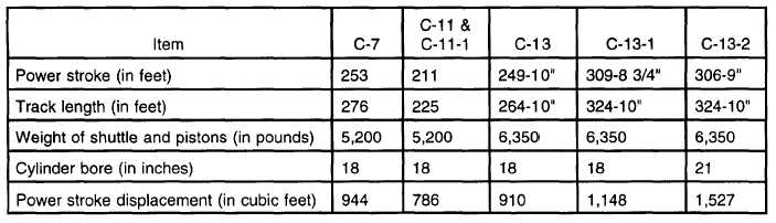

(ft)(ft)(ft-lb)(LT)
Launch Assist ItemsPwr StrokeTrack LengthMax ECat Wt
UK BS4103.0160.017,000,000275.0
UK BS5151.0220.030,000,000
UK BS6250.0320.038,197,700 *
US C7253.0276.042,000,000352.0
US C11211.0225.036,096,827 *
US C11-2150.023,500,000
US C13-0249.8264.854,000,000
US C13-1309.7324.869,422,255 *
US C13-2306.8324.875,000,000478.0
US C13-3246.060,744,473 *
US Notional 1953 Design135,349,047 *650.0

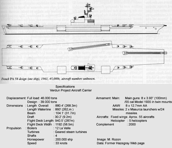

CdG & Rafales, cough - truncated Nimitz catapults, cough.
I have long thought that work done on Verdun was not lost, just put on shelves - and dusted off 20-25 years later, circa 1980, for CdG.
Their basic concept - minus nuclear propulsion of course for the Verdun - are rather similar: of pushing a Clemenceau hull shape and dimensions to its limits and 45 000 tons.
Including a larger deck for 75 m long catapults; for larger, twin-jets aircraft (Phantoms in 1958, Hornets in 1978).
A good case can be make that the largest practical aircraft on a Clemenceau would be an A-7E Corsair II. Wikipedia tell me - Max takeoff weight: 41,998 lb (19,050 kg) overload condition.
In a sense, it would be like the USN sticking with Essex, Crusader for interception and A-7E for strike; eschewing any twin jet or aircraft heavier than 20 metric tons.
Rafale and Hornet were marginal on Foch (both were considered in the late 80's) - few AAMs and partial fuel only.
Including a larger deck for 75 m long catapults; for larger, twin-jets aircraft (Phantoms in 1958, Hornet in 1978).

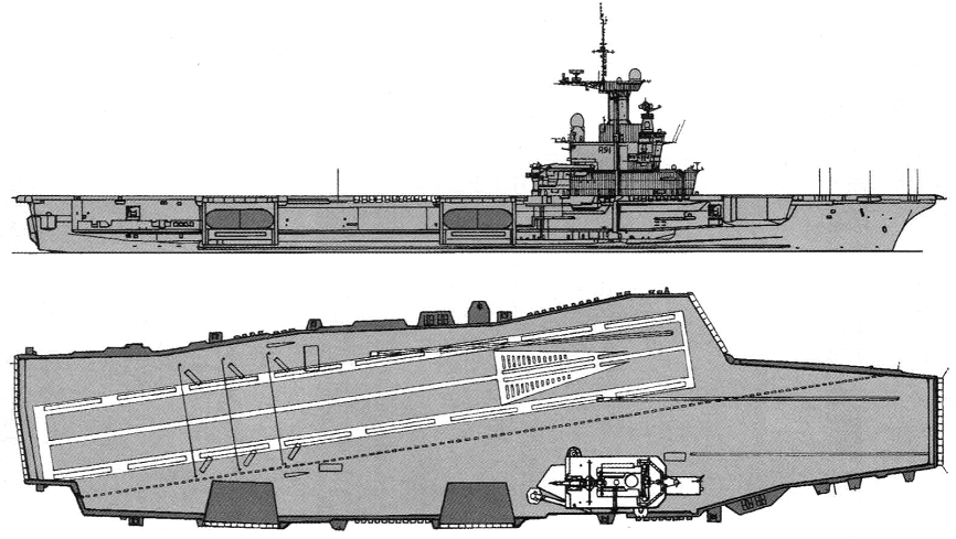

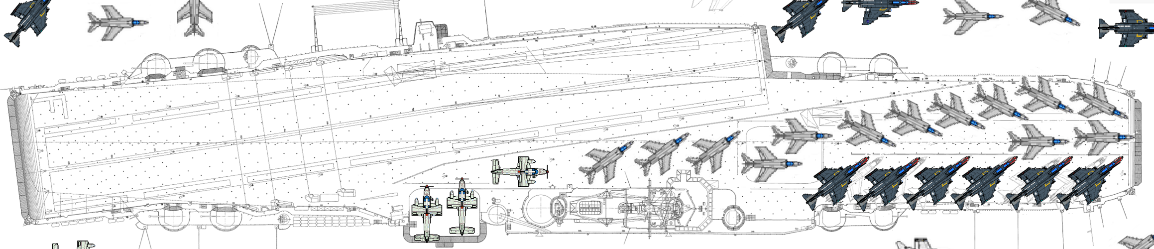

Using this two

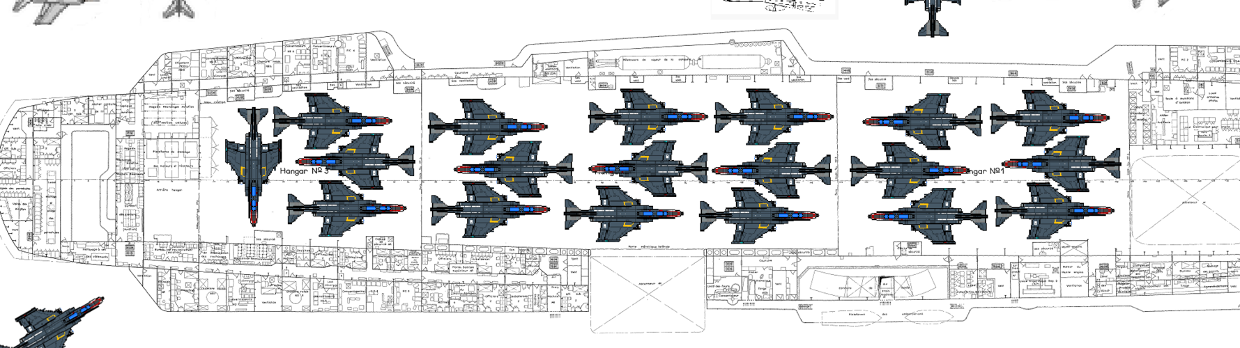

I made this
Only top view
The problem with cats and planes is in the myriad of details.
The catapults evolved and depend on inputs, so tables are only valid for a very specific version. Here, for example, the wet version of the C-11-1 depending on steam pressure:
The C-13 used very high pressure, the C-13-2 (short version C-13-3 in CdG) has a larger cylinder bore, but operates at lower pressure than the C-7. Add to this the very benign characteristics of the swing wing, and a C-7 can launch an F-14A at 63k lbs (4 phoenix, internal fuel) with zero wod. Better than the F-4. And the Hornet is a much hotter plane than both without swing wing or blc.
The issue of the catapults is closely related to Verdun and other projects like Hermes refits or CVA-01. Don't know whether it merits a thread of its own, I'll just add this:
Returning to the table above and comparing with the bs5 from the McD F-4K report, the catapults have similar performance even though the british boilers provided much lower pressure:

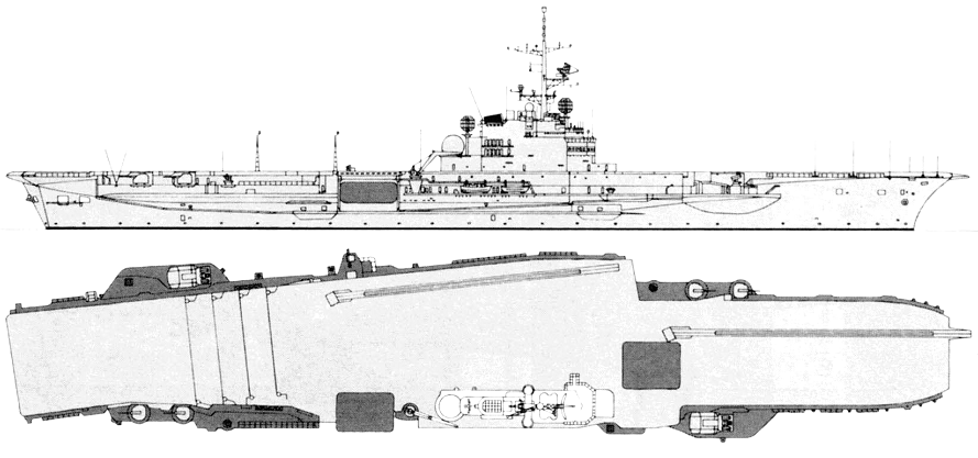

The above is my work, the end result of some 15 years of tinkering with Clemenceau.
Note that I am strictly an amateur with no marine engineering/design training whatsoever (I am, however, a former USMC avionics tech on A-6Es & F/A-18As). ;)

Not quite an Aéronavale one but this is one that Richard did years ago ;)

While I unfortunately don't have direct takeoff performance figures for the F-4K, if comments I've seen about a "30%" improvement in takeoff speeds are correct then you could get the F-4K off the deck of these ships in just about any armament configuration you could think of.
The F-4J, which forms the basis of the F-4K, ranged on takeoff from 46,833 lbs, with a stall speed of 138 knots, with just four Sparrows, all the way up to 56,000 lbs with a stall speed of 151 knots with 8 500-lb bombs and two fuel tanks. Applying that 30% reduction gets you down to a stall speed ranging from 96.6 knots to 105.7, and the alternate loads listed get only modestly above 56,000 lbs, so we can safely assume the 56,000-lb/151-knot figure to be our upper limit.
http://alternatewars.com/SAC/F-4J_Phantom_II_SAC_-_August_1973.pdf
C-11s, for their part, could throw 70,000 lbs at 108 knots at the high end. So we've got quite a bit of margin here; one benefit of the Spey Phantom's extra thrust is higher max weight.

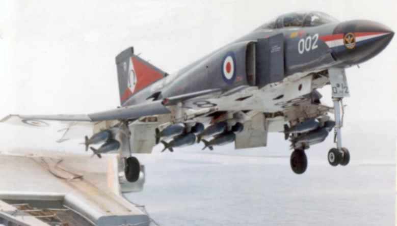

@CV12Hornet Minimum catapult launch speeds for the Phantom FG1 are available here (page 183): https://www.avialogs.com/aircraft-m...597-ap101b-0901-15a-phantomfgmk1aircrewmanual
Basically launch speeds range from 140-150 knots in most operating conditions for launch weights of 51,000-56,000lbs (full internal fuel, centrerline tank, and 1,500lbs missiles for A2A or 6,000lbs bomb load for A2G).
Subtract 25kts wind over deck and you need a catapult that can launch those weights at 120-125kts.
Unfortunately, most of the document is paywalled, so I'll have to take your word for it.
Also unfortunately, I don't have an actual speed curve for the C-11, but that launch speed at that launch weight is probably achievable by the C-11.

No claim to beauty or very good accuracy, but here's an idea of a Clem full of Phantoms for maximum spotting.o_O
Great drawings. Could you redraw with an operational spot such as in the pic below?
My rough estimate is you could fit 8 F-4s in the starboard bow parking, 4-5 in the bow catapult parking, 1 on the front elevator, 3 along the island, 1 on the aft elevator, 1 right behind the aft elevator, and 1 in the wires… total 20 F-4s on the flight deck.
le-porteavions-foch-navigue-en-mer-adriatique-le-16-octobre-dans-le-picture-id1052797578
In the hangar I would remove 1 F-4 from each hangar bay to allow for movement in and out towards the elevators. Remove 1-2 more F-4s to allow for helicopter stowage. That would mean up to 14-15 F-4s in the hangar.
Total max theoretical air group would therefore be ~35 F-4s. However it is customary to leave some space margin, so more realistically up to 30 F-4s would be the maximum… less if you trade off some F-4s for other aircraft types (such as Alizés).
Say 24 F-4s, 6 Alizés, and 4 helos.
I haven't tried an all F-4 operational spotting as the strike weight of the F-4 would seem unrealistic for the Clems.
What I have tried is this: The heaviest actual loadout I have found was 10 F-8, 24 Etendards and 6 Alizés. This gets already quite dense, although in theory using US Navy spottings, it translates into roughly 28 Phantom spots / 70 % use.
But the hangar and the starboard bow park fit Phantoms just as well as Crusaders. Replacing the Crusaders 1:1 looks like this (Crusader outlines can be seen under the F-4s; density ~75%) :

RIPPER
pa-58-3-gif.168043
pa-58-1-gif.168039
This are image of post 4
Are they diferent projects?
the so called Joffre, have an enlarge and more angle deck. A full displacement, have 1000t more
Any one have more info,.
Thanks
