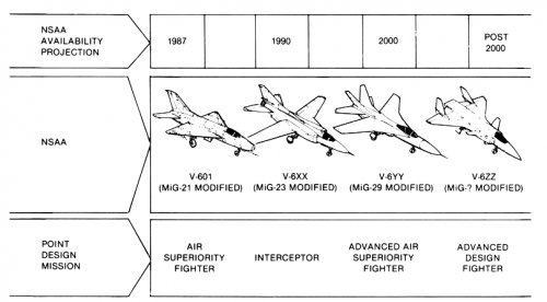

I have some vague recollection of a plan for Vought to build MiG-21s? Possibly as Aggressors?
Building MiGs in the USA :eek:, this should be a bit expensive. For the Agressor role only a few dozens would be required.
I think this drawings could be connected to intel/development of foreing technology.
Look at this:
The Vought Mig-29 is similar to this RAM-L posted by Deino while the V-6ZZ is similar to Vought's advanced fighter configurations studied in the 80's for US Fighter programs (Advanced VTOL and ATF)
Maybe Evan's opinion could be very informative here ;)
Look at this:
Building your own MiG’s for aggressor training doesn’t make any sense, especially if you already have sources to procure the aircraft. From the looks of the incorrectly drawn MiG 29 this document comes from the early 80’s, at that point and time the US could acquire Mig-21 from Pakistan, Egypt, and China. Also the United States did eventually receive ex-Egyptian Mig-23’s. Basically it’s a waste of time and money.
That V-6YY/RAM-L was based on drawings in the E European press, which were in turn based on drawings in a UK publication, which in turn were based on sketches in AvWeek. The problem was that all anyone had to go on to begin with were plan views...
LowObservable: can you shed any light on what these Vought projects were about?
I'm sure it was connected with a plan to low-rate manufacture copies of clandestinely obtained aircraft for aggressor use, around the time when the Kfir was bought as F-21. Can't recall where I might have read that though.
I remember something about that idea. This is clearly early 1980s - the final configuration actually looks like some Vought Tandem-Fan STOVL projects of the time.

Perhaps this represents a design study that merely attempted to predict the future capabilities of yet-to-be deployed Soviet fighters?

How about this:
I will grant that the US could obtain sufficient MiG-21s and 23s to establish whatever agressor squadrons they wanted. However, maintaining them is another thing. Could these Vought project numbers be for a Vought bid to maintain them and replace Soviet parts such as brakes, ejection seats, and such so the pilots would not need to borrow diapers from NASA? Vought would probably want a project number for bookkeeping purposes, as would the USAF.
By this same token, with experience gained by Vought from handling the MiGs, they would be in a better shape to interpret data obtained on the Ram L and Ram K aircraft. Perhaps they would even do some paper reverse engineering, and perhaps reverse engineering portions of the aircraft. Again, this would probably call for a project number for bookkeeping and contract purposes.
I read the original article yesterday in Janes Aviation Review. I was correct; it was about Aggressor aircraft, and the plan was to build copies of MiG airframes with US avionics. The dates are when US Intelligence predicted the availability of the airframe, and the last picture is a theoretical MiG-29 follow-on.

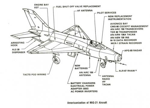

V-601 was an "Americanized" MiG-21 for Naval Adversary Aircraft
Proposal was for 24 new aircraft deliveries on a similar delivery schedule to the original F-16N and TF -16N aircraft (1986-89). The aircraft would be crated and shipped to Vought for modification and reassembly.
1983 proposal included: Structural work to support new avionics and ejection seat.
Adding UHF, IFF, VHT, TACAN, ILS, Intercom, New altimeter, standby gyro, ADI, Fire warning system in engine bay, airspeed indicator, EGT system, Oxygen regulator and seat pan disconnect, Clock, Escape system, Fuel shutoff system, 28 VDC to 155 VAC inverters, Nicad batteries and charging system. Wiring for TACTS pod.
A year later the proposal added: Radar with look-down capability, INS, second VHF, Com control system, Improved TACAN, Crash recorder/beacon, Load/strain recorder, Chaff/flare dispenser, Arresting gear system, provisions for a RHAW system.
Additional changes at a later date: deleted VHF radio, deleted ILS system, retain the original crew escape system.

Bill S said:
V-601 was an "Americanized" MiG-21 for Naval Adversary Aircraft.....
Thanks Bill!
