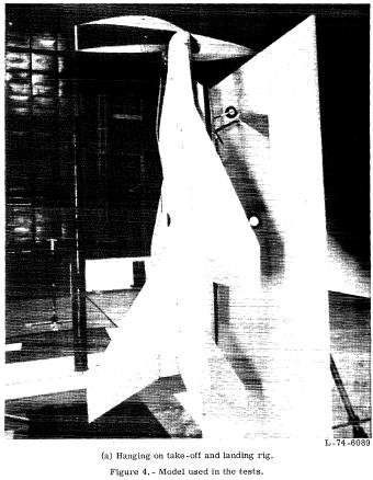

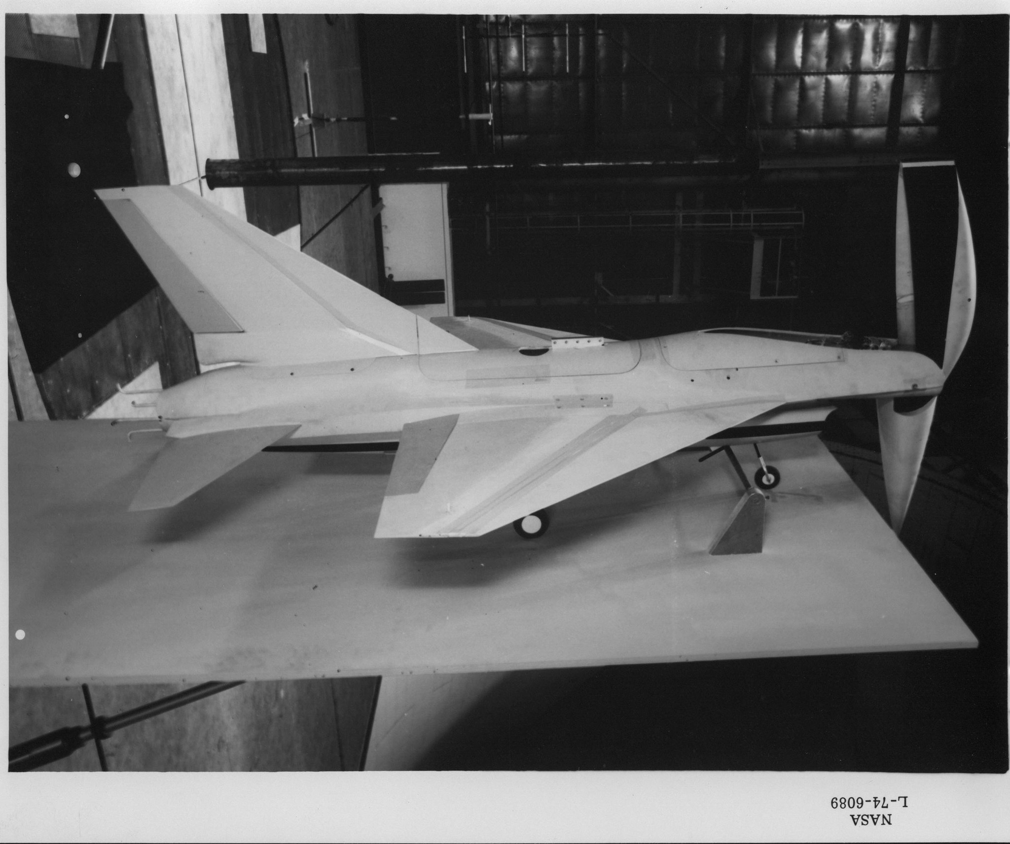

Interesting, thanks Hesham.

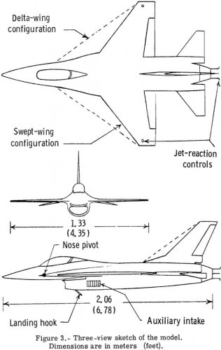

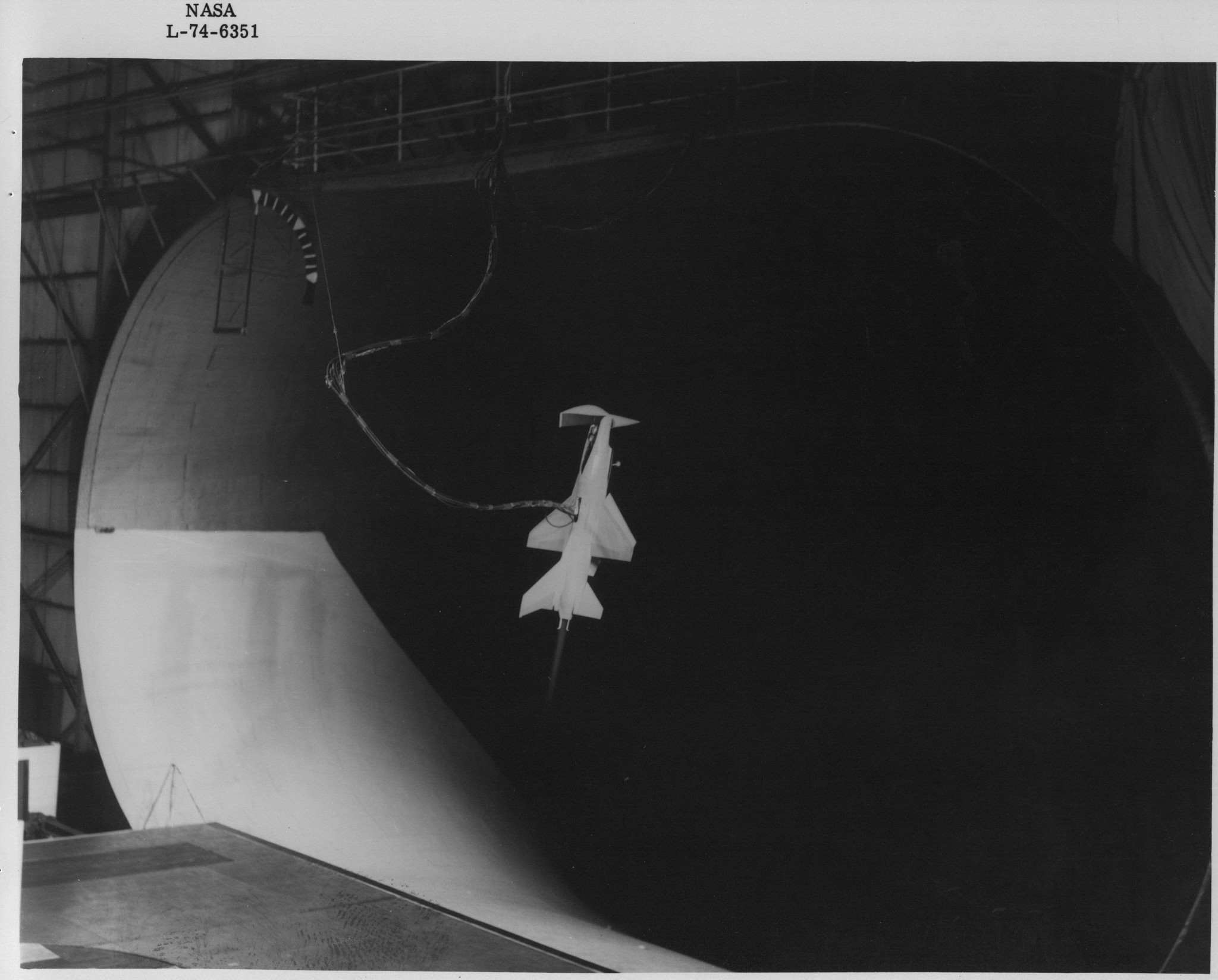

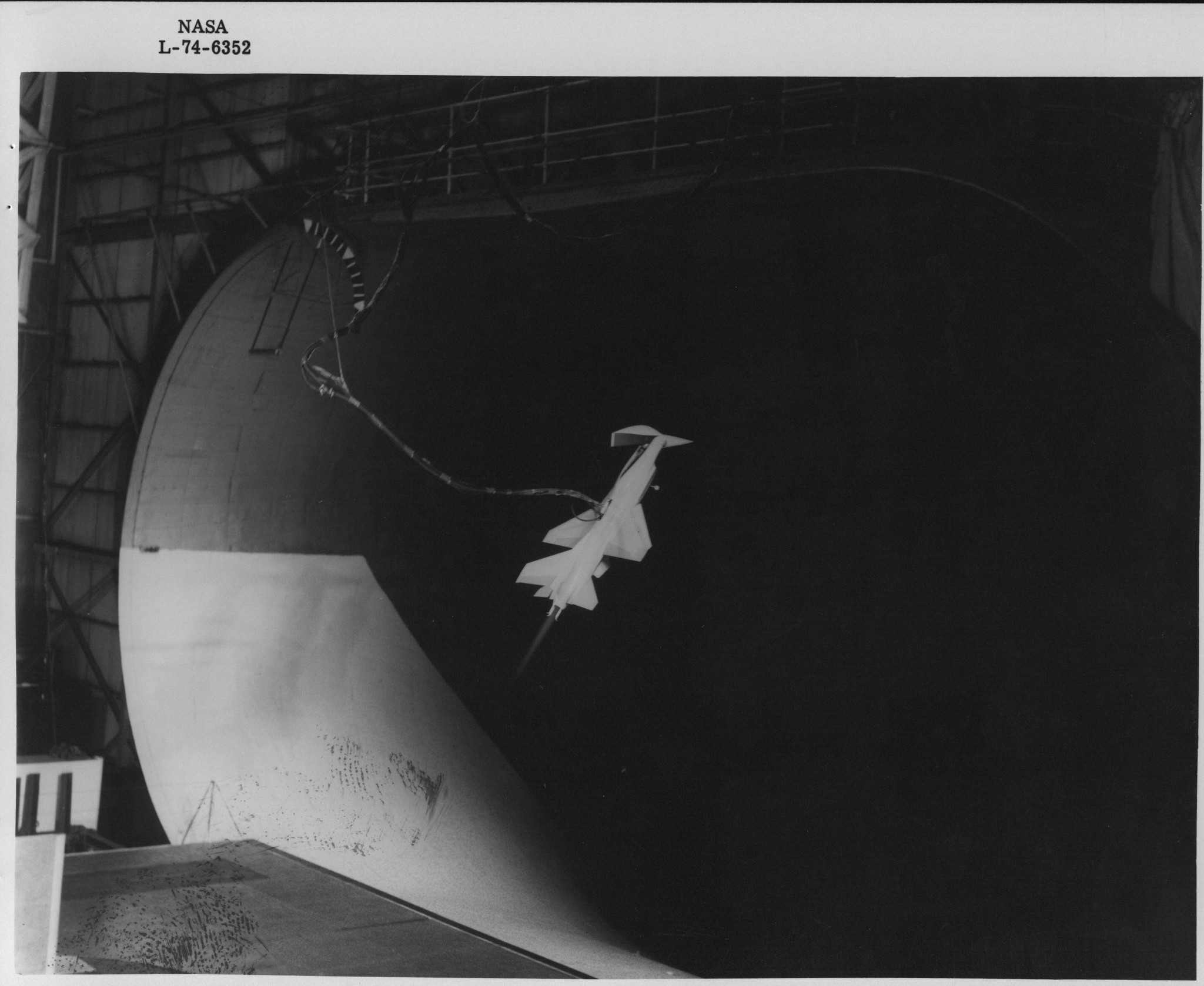

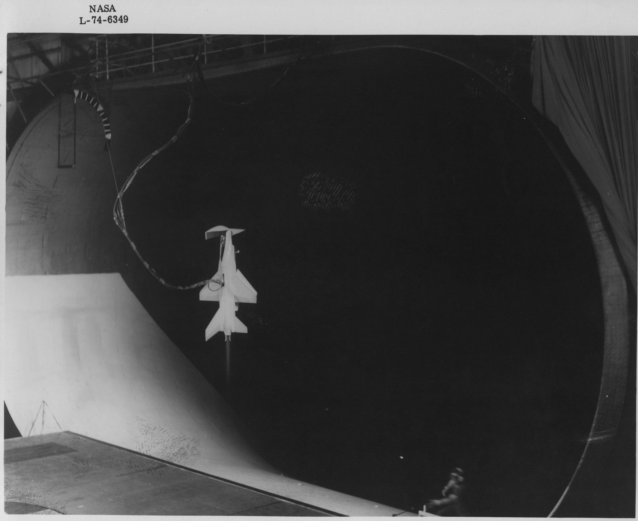

From the text, this model just seems to be testing the pivoting forebody as a possible way around the shortcomings of the X-13 Vertijet. The tailed-delta appears to have won out over the 'least mod' version of the F-16.
The 3-view (Fig.3) on page 19 shows more details of the airframe, reaction controls, etc. Attached is a more compact, reorganized version of that Figure.
BTW, for anyone interested in the LTV XC-142A, there's a drawing of the 'free flight' wind tunnel testing of that V/STOL aircraft on page 25.

Right Apophenia , it seems that this model haves nothing
to do with the F-16...

RTFNTR
The model used in the investigation was a modified version of an existing research model generally representative of current fighter configurations.
They just took spare model to make the tests.

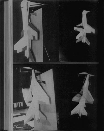

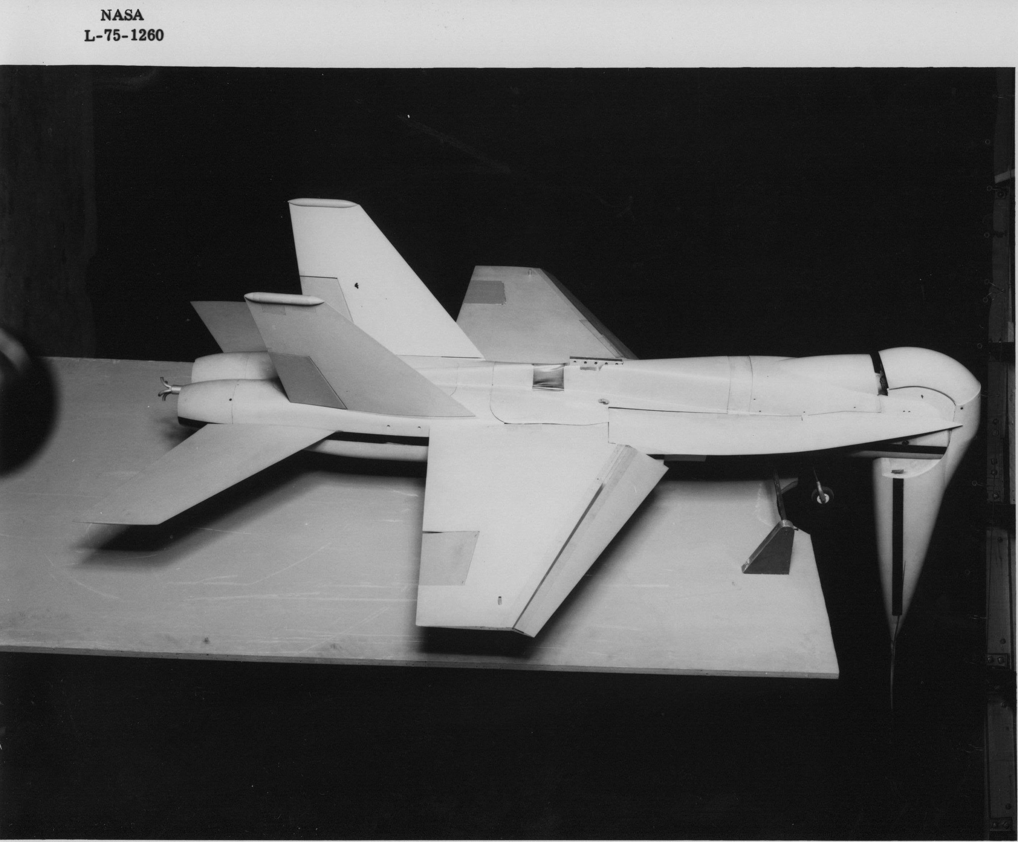

Here it's again, from Aviation Week 1975, the F-16 was used
as basis, as well as the F-17.
Re: Tilt-cockpit VTOL tailsitter F-16 and F-17
Thanks Jens. Interesting to see the different pivot points chosen for the two models.
The same F-16 photos were reproduced in the NASA pdf but your AW&ST versions are of much better quality.

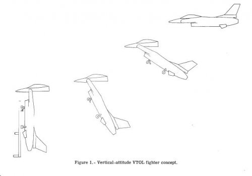

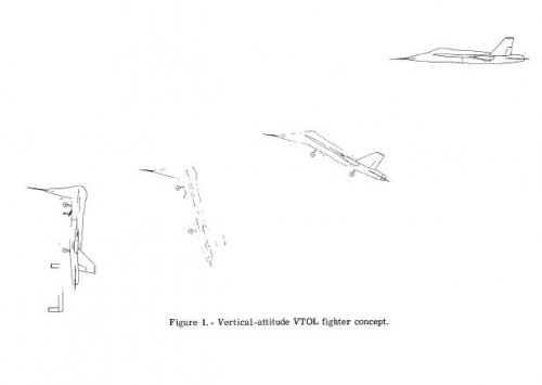

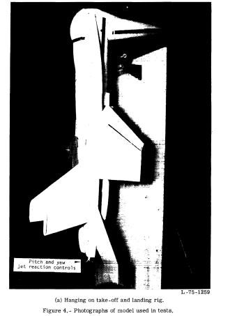

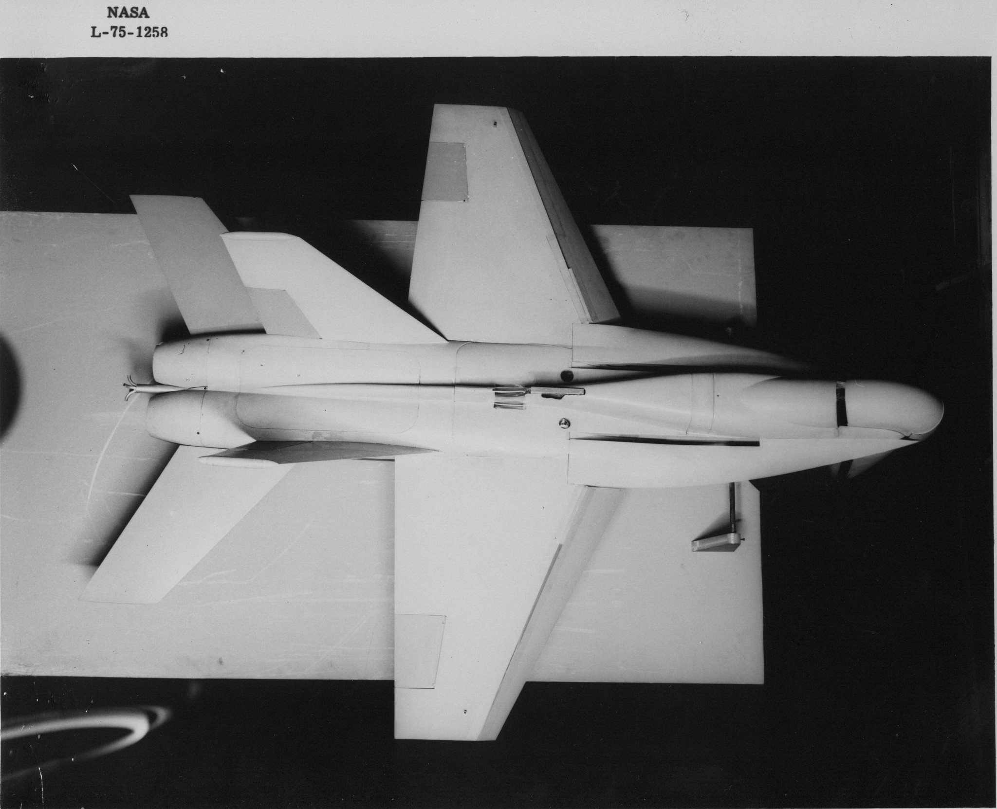

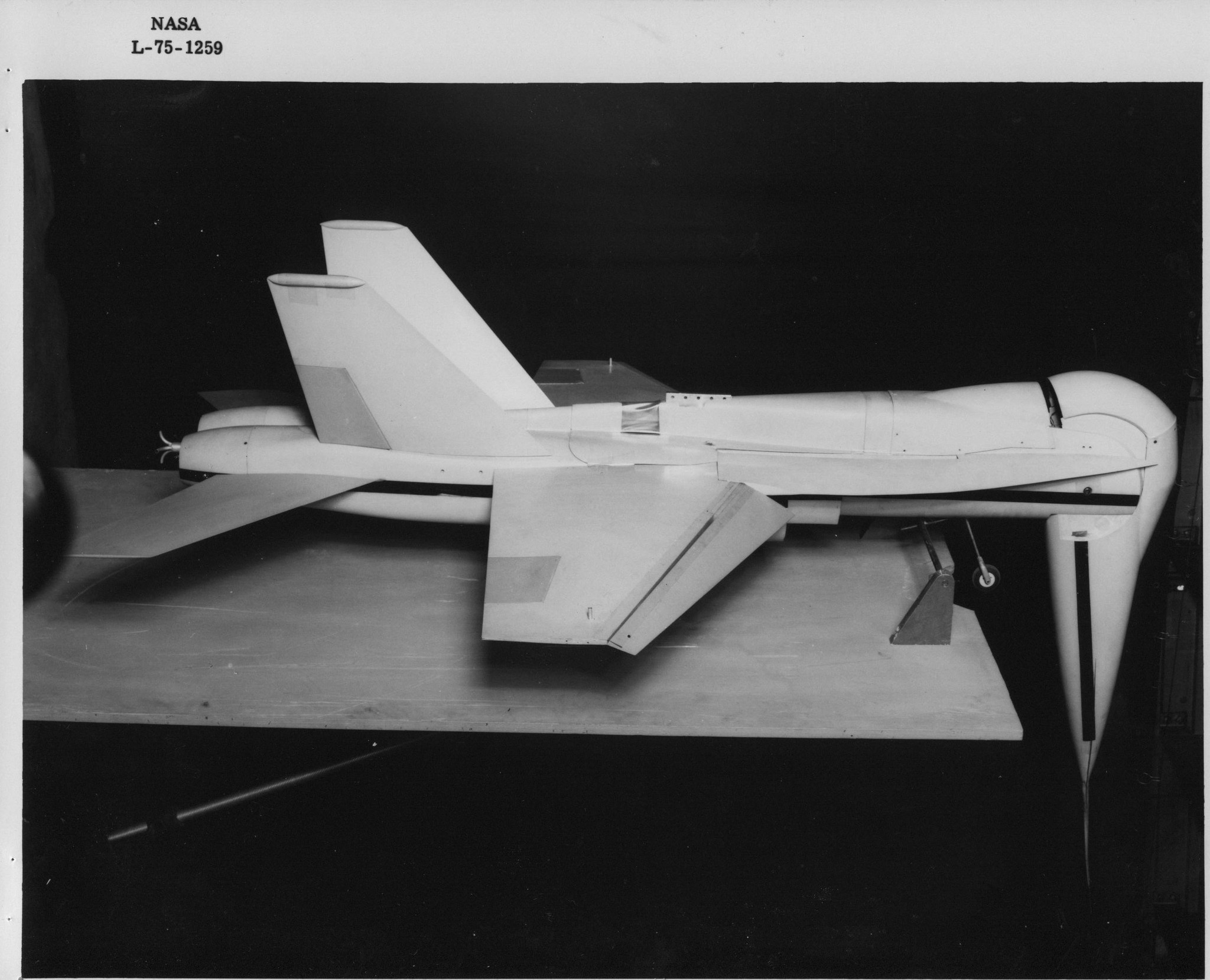

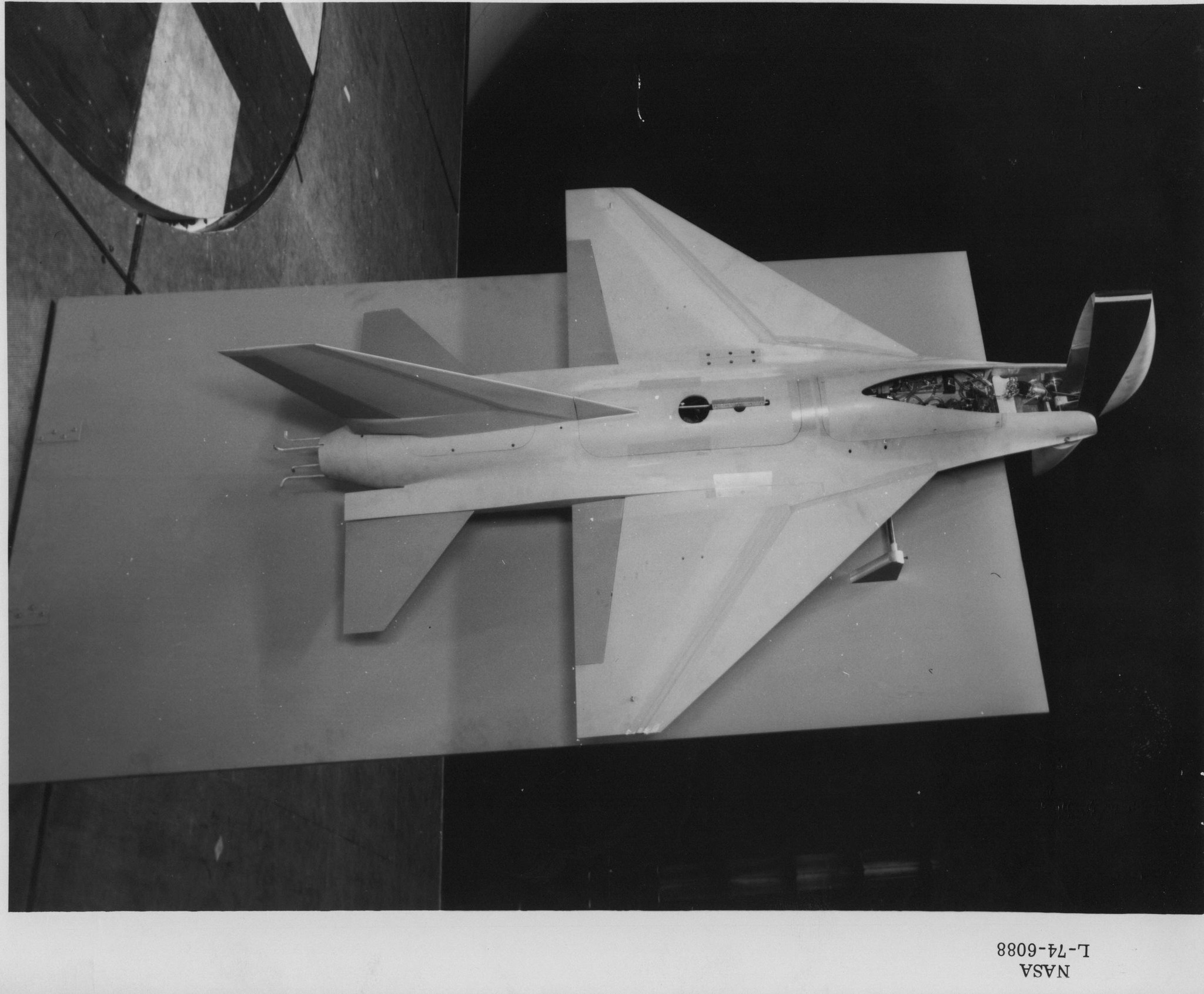

and also from NASA reports,the F-16 and F-18;
http://ntrs.nasa.gov/archive/nasa/casi.ntrs.nasa.gov/19760003954_1976003954.pdf
http://ntrs.nasa.gov/archive/nasa/casi.ntrs.nasa.gov/19750022036_1975022036.pdf
