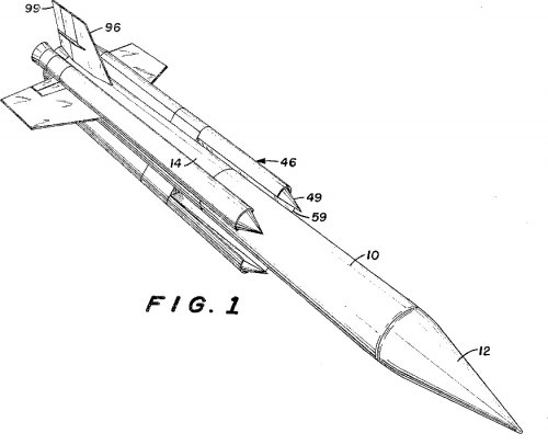

This appears to be the patent for the missile. The attached image is extracted from it. The fuel used is 50% boron. Would this be a significant contributing reason as to why the missile was not funded for further development and flight testing? If my memory serves me, boron was highly carcinogenic and made for a very smoky exhaust in the High Energy Fuels program for the Valkyrie.
The propellant grain, in one planned embodiment, is composed of 50% boron, 4% aluminum, 25% ammonium perchlorate, 15% binder and 6% nBF additive. The propellant grain surface is conical to accommodate the burn rate characteristics of the wire
Also, I do not understand why the extended range version of the missile would be 4 inches shorter (though with a booster 148 inches long) and weigh almost 4700 pounds (3.6 times) more for only twice the range. Granted, I'm no engineering person, so there's probably some blatantly obvious reason that I simply don't know of.
Almost certainly, especially considering, after the aforementioned carcinogenic effects of boron were discovered, the Air Force quickly shut down plans to manufacture boron-based fuels:
http://www.airfields-freeman.com/CA/Airfields_CA_Mojave.htm#boron
