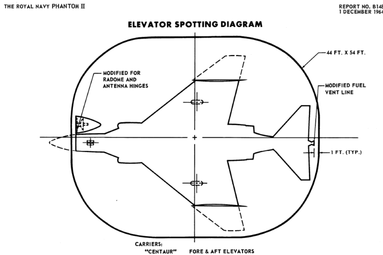

As the Centaur class came up in the Super tiger thread, I was wondering about their catapults. As far as I can see:
Albion and Bulwark: no steam catapults
Centaur: 2 139ft bs4 (Hobbs)
Hermes: Probably a change with the 1960s refit; Hobbs just gives (assuming after refit): bs4 175 ft and 151 ft, both 50k lbs @ 94 kts
Or: two 103 ft bs4 initially, 1 lengthened to 145 ft ?
There is much more detail available for Eagle and Ark Royal, but the Centaur class looks a bit lost.
But ok, you can put a Phantom on the elevator of Centaur...

Where does the graphic come from?

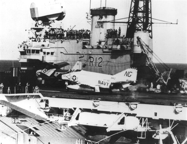

An Americqn F4 visiting a little Brit slat top. Oliver Reed reacting to a suggestion that he might like a try.
