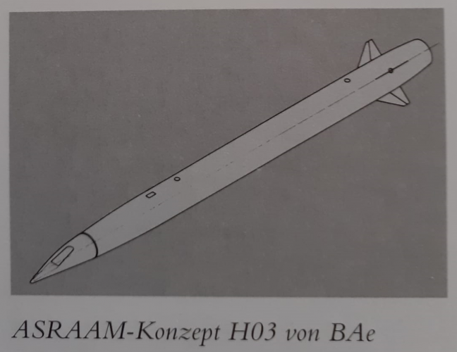

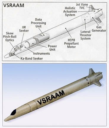

It had a passive radar seeker and an IIR one. The later VSRAAM was similar but had an active Ka band seeker.
BAe proposed a near-term version of SRARM that was about the size of ASRAAM (but with a different airframe derived from BAe's FLAME proposal for ASRAAM https://www.secretprojects.co.uk/threads/taildog-sraam-asraam-family.5619/page-4#post-578076) and a later version that was scaled down in size with TVC. No lateral thrust system for SRARM and more range compared to VSRAAM. Could also be used as an AAM.

Did the smaller version have a warhead? IIRC VSRAAM didn't and relied on its impact on the target for effect.
Yes it did. The original concept for FLAME did not have one but, like Rapier, it got a small one for AR, to go off after it punched through light armour or to mash up a radar antenna.

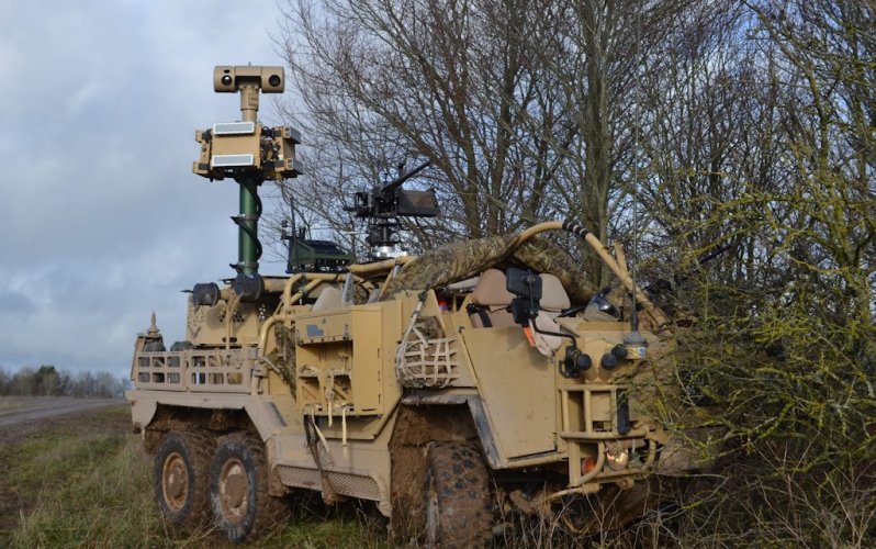

Personally, I'd rather see the UK develop a NOMAD style unit based on new Supacat HMT600 (with the armoured enclosed dual cab) chassis with radar (Blighter style on mast or Saab Giraffe 1X), EO/IR, RWS and 2-4 CAMM rounds on the back as a standalone system that could be deployed forward of Land Ceptor batteries and operate independently...but also connected via networks. Stick it alongside the HMT600 with Moog RWS equipped with 30mm and 8 Starstreak/LMM and you have a useful capability. More likely to get some export sales from that as well...
Seems like I wasn't far wrong with this...

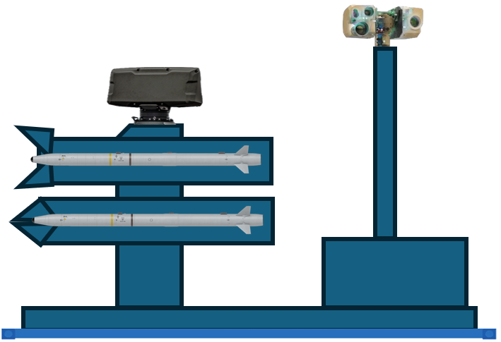

I'd still like to see a few things changed...
- Needs a radar on it, preferably a small 4 panel AESA set up on the mast below the EO/IR (not for medium range search/acquisition, but to contribute to the air picture alongside Giraffe AMB...Giraffe 1X would be lovely...but I'm afraid at £2m+ per unit is too expensive for this use case...a 4 panel would definitely pick up cruise missiles and fighters/helo at the likely max engagement range (think 20km max)
- Needs an RWS for local self protection...the 4 panel radar would pick up drones for engagement by this...
- Needs one of the 360 deg EO/IR systems the UK has recently contracted to replace ADAD (SPYNEL-X)
- If its going to use Asraam, it needs a box launcher with internal rails (like NASAMS) for environmental protection
- The MooG FMP will also carry APKWS pods...which like the RiWP would be useful to have around...unfortunately its elevation limit is 30deg, so I suspect attaching canisterised CAMM is a non-starter (I'm pretty sure the soft vertical launch canister won't work at 30deg elevation max...). But 3 Asraam and a 4 round APKWS (or other laser guided rocket) box would be a good set-up.

Also, why no sensors? Even if it has some sort of optical sensor on the launcher between the launch rails, that's still not enough I think.
Uses a datalink from an off-mount radar.
I suspect this has, like Raven, an EO/IR sensor on a mast. Wouldn't be that hard to add 4 Blighter A400 radar panels (which we've seen on UK trials masts previously).
We can't see the CAMM datalink, which would be the one they'd use, in the images to date...mind you we can't actually see the EO/IR mast mounted sensor...which surely must be there. Any production unit would surely need the datalink though...
The only thing that could improve it...would be if you could mount the mast, with EO/IR, data link and radar panels, actually on the centre or rear of the MooG FMP...giving 360 deg field of fire (well perhaps not directly rearward...).

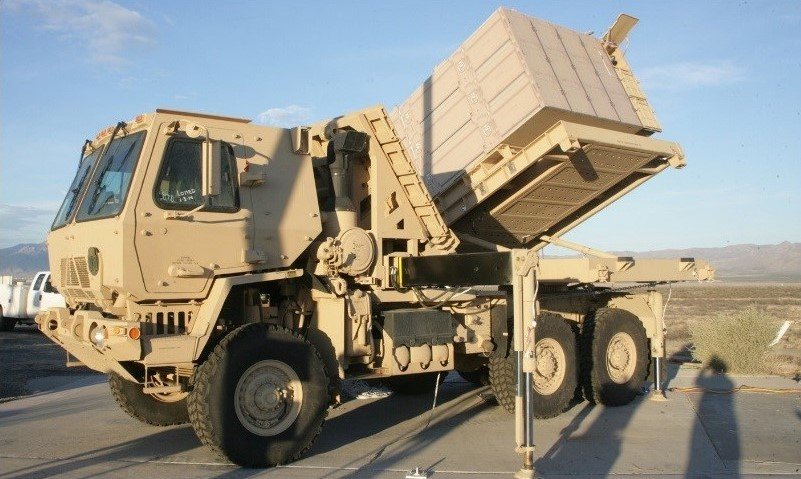

It's noticeable that the IFPC Inc 2/Enduring Shield launcher has fully encosed AIM-9X Sidewinder, though I suppose they may pop the front hatch open prior to launch - OTOH the palletised launchers* don't seem to be trainable, so they may rely solely on datalinked LOAL.
* The only pictures I can find of a trainable Enduring Shield launcher are truck mounted, and it's visibly different from the palletised launcher.

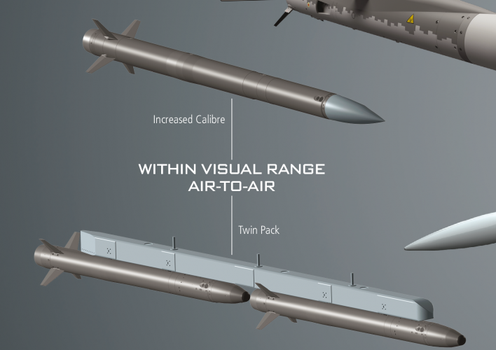

This concept got nicknamed Fat-SRAAM in the GCAP threat, posting the image again as a reference. It's unclear whether the two refer to the same missile being both fatter and wider than ASRAAM or two different concepts, one a fatter ASRAAM and one a much smaller missile.
If both notes are referring to one concept, faster-accelerating and more compact ASRAAM would also do great for VSHORAD, certainly.
From the mockups they presented at the Tempest mock up launch the 'Fat-SRAAM' was only marginally shorter than standard Asraam. The smaller ones were just a little under half the size. The MBDA 'MHTK' mini-missile was also present (in A2A and A2G versions) so the smaller Asraam was not there for missile defence. We've not seen those concepts in some time to my knowledge though (they may be with the GCAP mockup on stands, but I've not seen them there or on MBDA stands)...unlike SPEAR, SPEAR-EW and the Stratus ones....
Only 4 missiles fit because otherwise the launcher wouldn't be able to elevate far enough.
Ah, thanks. I'd guess the twin packs would be Meteor sized and fit the self defence bays on Tempest as they were at the time. It seems worth retaining as a dogfight missile, and then the fatter missile could try to compete with MICA in the medium range category.

Not sure if I can tell, even from the closeup pics of these renders that I have here.
Though I really hope it's not a frangible lid as that would require some sort of a nose cone, thus negating the biggest advantage of a surface launch ASRAAM, which is the common missile stockpile.
I would suspect that any canister for an IR missile or other relatively fragile seeker would have an opening lid of some sort. MML had a hinged flap on its AIM-9X and Hellfire canisters, for example.
