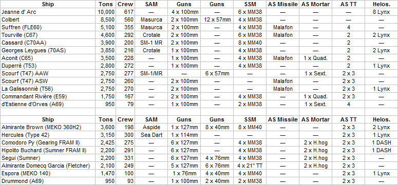

Link to Post 287 which included a table showing the armaments of Argentine and French warships.
Link to Post 297 which was "An Analysis of the British and French Warships Armed with Surface-to-Air Missiles in April 1982".
We've Analysed The SAM's Of British And French Warships - Now It's Time To Analyse Their Guns
This Is The Table From Post 287
Most Of The Information Is From Jane's 1982-83
All the 100mm guns on the French ships are in single mountings and all the 57mm guns on French ships are in twin mountings.
Of the 23 British destroyers and frigates that fought in the war:
  • 5 were armed with two 4.5" guns in one twin mounting. (2 County class, one Leander class and 2 Rothesay class)
  • 12 were armed with one 4.5" gun in a single mounting. (6 Type 21, 5 Type 42 and one Type 82)
  • 6 didn't have any guns. (2 Type 22 and 4 Leander class)
On the other side of "La Manche"
  • 17 out of 20 cruiser and destroyer size warships available in April 1982 had one or two single 100 mm guns and the rest had six 57mm in 3 twin mountings.
  • The 9 E59 class light frigates carried had two single 100 mm guns.
  • The 12-15 A69 class corvettes that were available in April 1982 were armed with one 100 mm gun.
  • Not in the list are Clemenceau and Foch which were armed with eight 100mm guns and Jeanne d'Arc which had four.
I'm assuming that the 100mm gun wasn't as good as the British 4.5" in the shore bombardment role and was a much better AA weapon. I'm also assuming that the British and French fire controls systems were of equal quality. Are my assumptions correct?
If my assumptions are correct the MN "had the edge" over the RN in close range AA defence in both qualitative and quantitative terms.

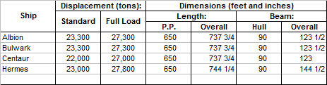

This is Part One of What is Intended to be a Two-Part Response
These are the dimensions of the Centaur class aircraft carriers according to Jane's 1962-63.
Externally...

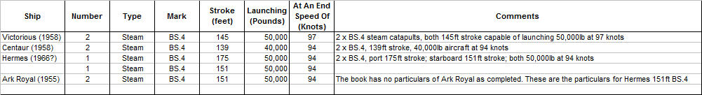

The other important external difference was the steam catapults. According to Hobbs the capacities of the BS.4 steam catapults fitted to British warships were.
However, Hermes was completed with a pair of 151ft stroke BS.4s. The port unit had its stroke increased to 175ft during its 1964-66 refit. As noted in the comments Hobbs didn't say what the performance of Ark Royals BS.4 catapults was and I've assumed that they were the same as the 151ft BS.4s fitted to Hermes.

The particulars for the BS4 from “Farnborough and the Fleet Air Arm”
1953 - first installation 40,000lb at 78 knots
Upgraded to 50,000lb at 94 knots
Upgraded to 50,000lb at 105 knots.
No dates given for the upgrades.
Ark Royal’s cats were 151ft stroke.
Ark completed in Feb 1955 as the first carrier fitted with all 3 new inventions: steam catapults, angled deck and optical landing sight. She was followed by USS Forrestal in Sept and HMAS Melbourne in Oct 1955.

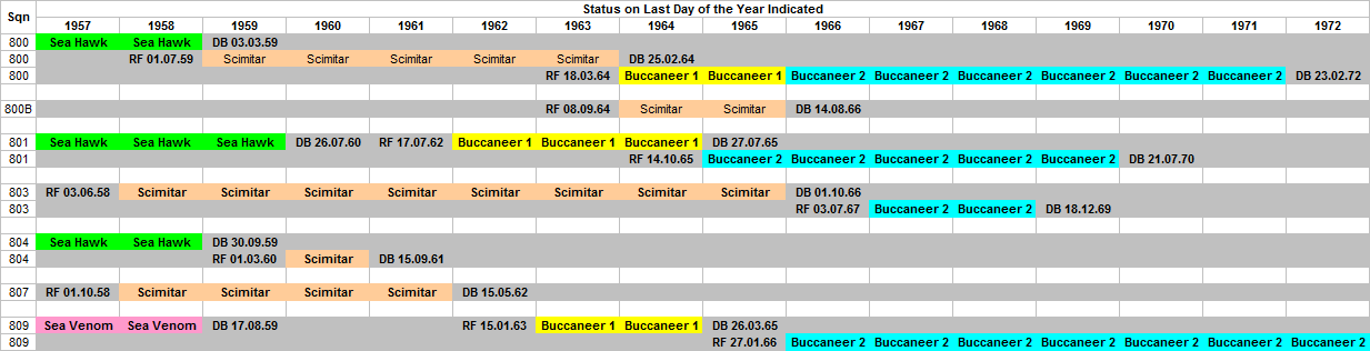

In the Royal Navy first-line squadrons are usually given "number plates" in the series 800-899 and second-line squadrons are usually given "number plates" in the series 700-799.
This a timeline of the Fleet Air Arm's Buccaneer and Scimitar squadrons with "number plates" in the series 800-899
Of the four 800 series Buccaneer squadrons that were formed:
  1. 801 reformed on the Buccaneer S.1 in July 1962 and after a short spell on Ark Royal (from February to March 1963) was on Victorious from August 1963 until the squadron disbanded in July 1965. The squadron re-formed on Buccaneer S.2s in October 1965. The squadron was aboard Victorious from May 1966 until mid-1968 when it transferred to Hermes and was that ship's Buccaneer squadron until it disbanded in July 1970.
  2. 809 reformed on the Buccaneer S.1 in January 1963 as the Buccaneer Operational Flying Training Squadron. It was downgraded to second-line status as 736 Squadron in March 1965. The squadron proper never operated from an aircraft carrier. However, a detachments were aboard Victorious in 1963 and Ark Royal in 1964. It reformed again in January 1966 with 6 Buccaneer S.2 (later increased to 8). The squadron served on Hermes until mid-1968 and after a spell ashore was Ark Royal's Buccaneer squadron from 1970 until it disbanded in December 1978.
  3. 800 reformed on the Buccaneer S.1 in March 1964 for service in Eagle. It embarked in December 1964. The squadron re-equipped with the Buccaneer S.2 in late 1966. It continued to serve aboard Eagle until it disbanded in February 1972. (The associated but separate 800B Squadron existed from September 1964 to August 1966 and operated Scimitars from Eagle in the air-to-air refuelling role.)
  4. 803 reformed on the Buccaneer S.2 in July 1967 as the Buccaneer Headquarters Squadron and disbanded in December 1969. The squadron proper never served aboard an aircraft carrier. However a detachment of 4 aircraft served aboard Hermes from August 1968 to April 1969.
Marriott wrote that Centaur couldn't operate Buccaneers and Hermes couldn't operate them until after her 1964-66 refit, but I'm not sure that this was true. I think that the more likely explanation is that there weren't enough Buccaneers to go around until 1966 by which time Centaur had been paid off and Hermes had been refitted.
The first squadron to embark a Buccaneer S.1 squadron was Victorious (in August 1963) which had 145ft stroke steam catapults that were shorter than Hermes' (both 151ft 1959-66) and not much longer than Centaur. According to the table in Post 365 the steam catapults in Hermes were were just as powerful as those in Victorious and Centaur's were 80% as powerful. As far as I know the arrester gear of all three ships in 1958-59 was just as powerful and their flight decks were stressed to take aircraft of the same weights.
According to Lewis in British Naval Aircraft since 1912 the loaded weight of both marks of Buccaneer was about 45,000lb and the loaded weight of a Scimitar was 34,200lb.
So I think that my claim that Hermes could have operated Buccaneers in her 1959-64 configuration is correct.
However, it looks like I'm wrong about Centaur. If Hobbs data was right her steam catapults weren't powerful enough to launch a Buccaneer. On the other hand it seems strange that Centaur a ship with machinery that was as powerful as her half-sister's wasn't given catapults as powerful as Hermes' during during her 1956-58 refit. Plus Buccaneer was under development at the time of the refit and it seems strange that they weren't made powerful enough to operate that aircraft.
Part three will be about the modifications that may be needed to make Centaur "Buccaneer Capable" if I'm wrong. I'll also discuss how long the modifications might take and how much they might cost.

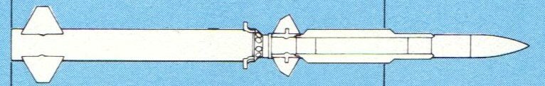

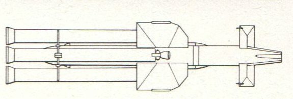

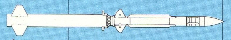

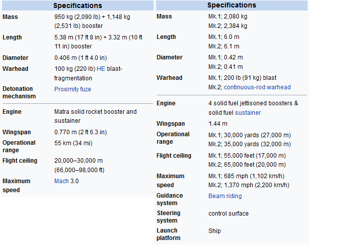

Admittedly, MASURCA was SARH when Sea Slug stuck with beam riding until the end. Which guidance was the best / more practical, I have no idea.
https://en.wikipedia.org/wiki/Masurca
They were quite similar, including a weight of 4000 pounds, no less.
What will it take to convince you that comparing MASCURA & the FLE60 class to Seaslug & the County class is exactly like comparing apples to pears? That is there's no comparison!
The correct analogues to MASCURA and the FLE60 class are Terrier (upon which MASCURA was based) and the Guided Missile Frigates (DLG) that the USN built in the 1960s & re-designated Guided Missile Destroyers (DDG) or Guided Missile Cruisers (CG) in 1975.
E.g. The Belknap class, FLE60 and County class Batch 2 which were completed at about the same time.
  • Magazine capacities.
    • Belknap had a magazine capacity of 60 missiles which were a mix Terrier (later replaced by Standard ER) and ASROC.
    • FLE 60 carried 48 MASCURA missiles of equal performance to Terrier and 13 Malafon anti-submarine missiles for a grand total of 61.
    • The Counties could only carry 30 to 36 depending on the source.
  • Air surveillance radar.
    • Belknap had SPS-48.
    • FLE60 had DBRI-23.
    • Both of which were far superior to the Type 965 AKE-2 on the Batch 2 County.
  • Guidance radars.
    • Belknap two (SPS-55).
    • FLE60 two (DRBR-51 respectively).
    • The County only carried one (designate Type 901).
  • The only things that I can say in defence of Seaslug are that it had a faster reaction time than 1960s Terrier and that one of the reasons for the low magazine capacity relative to MASURCA and Terrier was that the missiles were fully assembled for a faster rate of fire. However, the American rate of fire wasn't much slower in practice because they discovered that final assembly was relatively quick and easy. Or I think that's what Friedman wrote in The Postwar Naval Revolution. I haven't got the book out and checked.
What are its dimensions and weights in comparison to late 1960s Terrier and Standard ER missiles? I suspect that the missiles are rather similar and the boosters are different.
