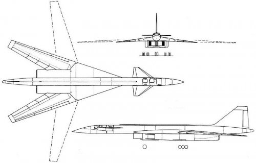

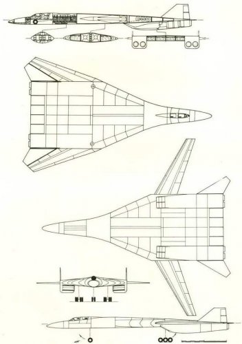

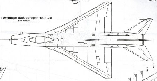

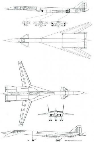

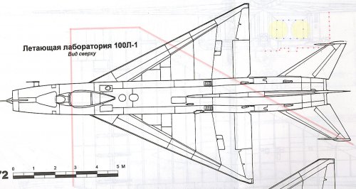

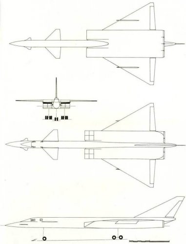

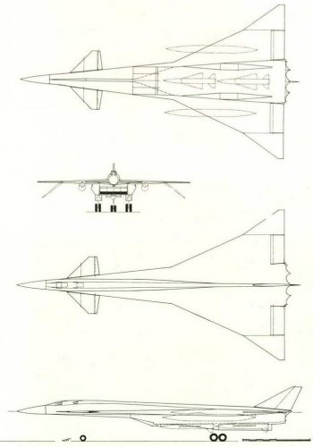

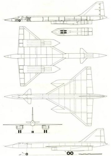

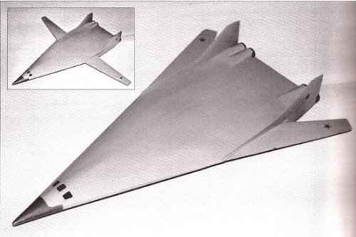

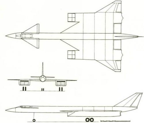

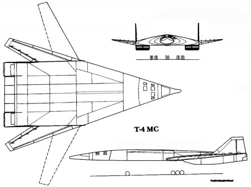

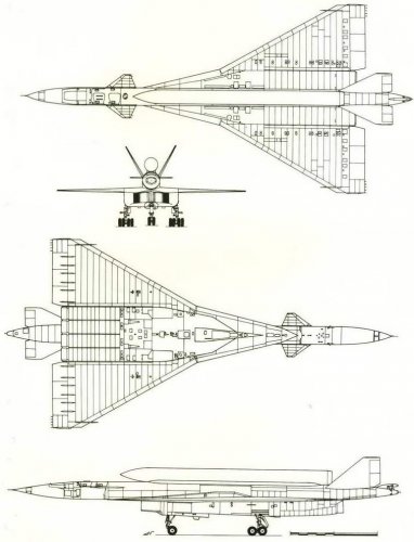

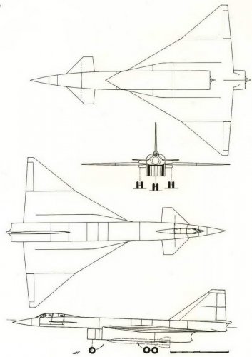

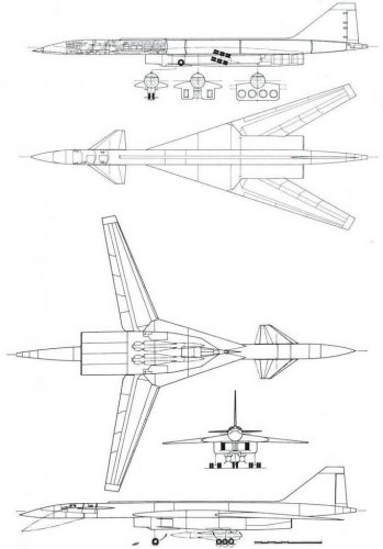

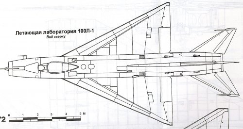

These drawings were obtained from a book I ordered several years ago from Avia Press. Sorry, I can't identify specific sourse.
They were shown in a book on the T-4 Sotka, and only shpwed the over head view.Thw book was in Russian so I can't give any details.
I would like to know if these are testbeds and were they built. I'm sure they are not stealth aircraft.

Find an unknown T-4 version at:
http://www.buran.ru/images/jpg/t-4b_2.jpg
Any ideas about what is it?

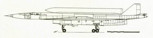

The use of aircraft T-4 as the Aerospace Complex (1973)
source:I.Bedretdinov"T-4"

That's not too far off from the US concept of launching a Minuteman from an XB-70.
Thanks a lot Borobik, is that object in the back of the T-4 a ballistic missile?

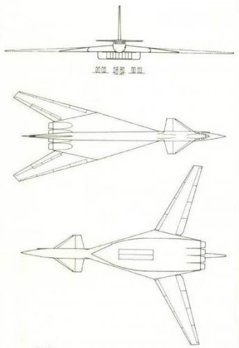

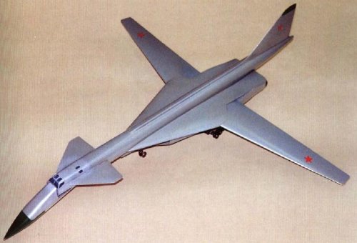

For anyone interested in the Sukhoi T-4/T-4M/T-4MS there is a beautiful book in Russian by Ildar Bedretdinov on the subject. It goes into full details on the design evolution process and has numerous images of the built T-4 prototype and subsequent projects.
I have a rough English translation of it I can provide to anyone who bought it and can't read it :)
Russian language T-4 article: http://www.popmech.ru/article/3274-ubiytsa-avianostsev/

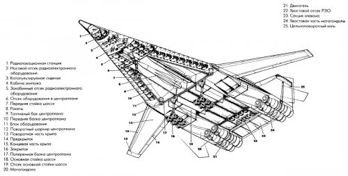

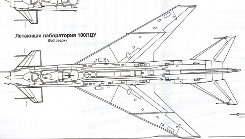

On orginal scans from elider there are visible in background lines of very detailed drawing of T-4 . These drawings ARE from a book "Udarno-razvedyvatel'nyi samolet T-4, Ildar Bedretdinov".

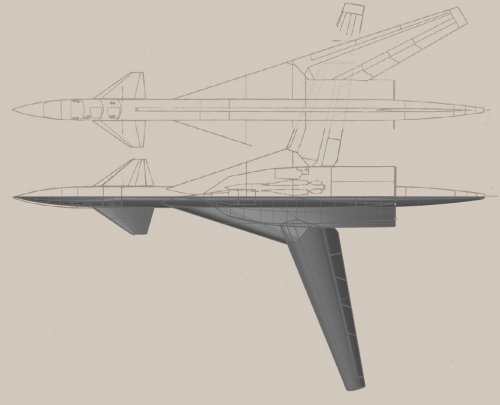

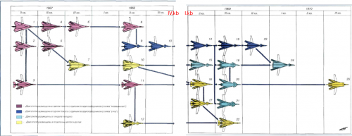

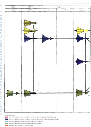

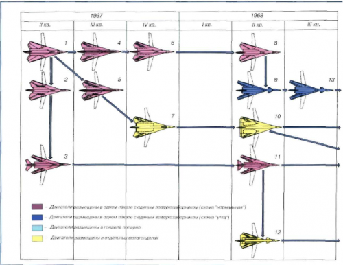

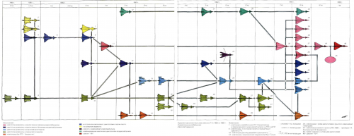

From the same source.
Thnaks a lot my dear hesham -san and Jozef-san. This is a perfect chart!! :D
http://www.secretprojects.co.uk/forum/index.php?action=dlattach;topic=6033.0;attach=573225;image

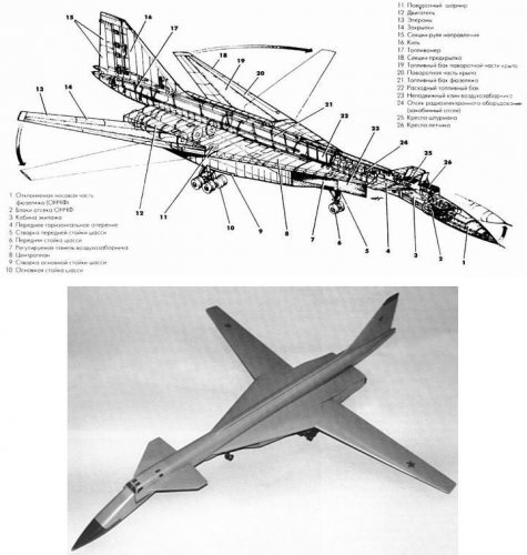

Hi PlanesPictures,
please can you collect the first two drawings in one piece,and thanks.

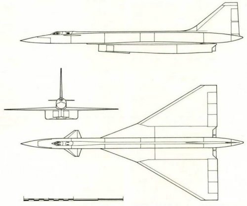

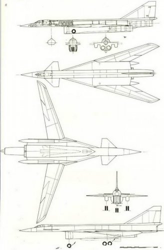

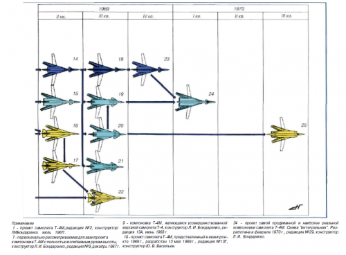

small part from both images are missing or no?

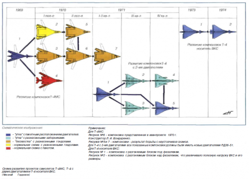

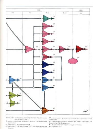

1968 IV.kb. and 1969 I.kb. One year has four kb ("kvartals")
No - they are two separate charts, the T-4M evolution to final configuration and then the T-4MS evolution, with about 6 months between them.
T-4MS is on picture 3.png. T-4M on pictures 1.png and 2.png. On picture 1.png is missing 1968 IV. kb (on right side) and on picture 2.png is missing 1969 I. kb (on left side). Probably no new versions in this time were presented and therefore this period was not presented.

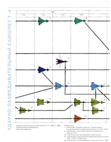

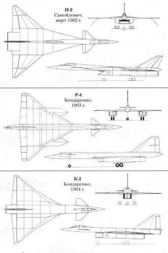

  • Projection of the T-4 plane Design (No. 46 in the diagram on page 21). (Nikolai Gordjukov).jpg
  • Finding the layout of the T-4 plane resulted in the creation of 46 machine layout options..jpg
  • Projection of the T-4 plane layout with Fljugarkom (No. 13 on page 19). (Nikolai Gordjukov).jpg
  • Projection of the T-4 plane in the first sketch project (18 on the diagram on page 19).jpg
  • Projection of the T-4 plane-response to the SR-71. Third quarter, 1964 (No.jpg
  • Projection of the T-4 aircraft represented in Avanproekte (No. 10 in the diagram on page 18).jpg
  • Projection of the duck layout with CDU. Developed by. Ivashechkinym in February 1962 (No.jpg

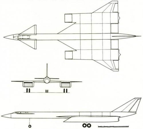

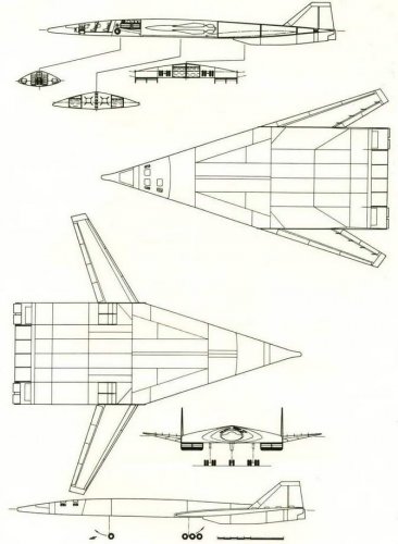

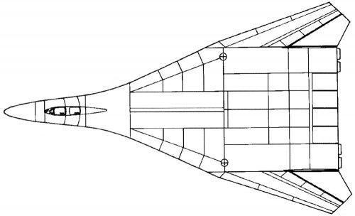

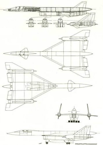

Hi!
  • A T-4ms aircraft project on a normal scheme with a lamp (No. 2 on the diagram on page 136).jpg
  • A project of the 4ms (two-hundred), with an integral layout and an adjustable wing geometry.jpg
  • A project of dual attack plane with the changing geometry of the wing T-4.jpg
  • The aircraft-SCC project is based on the T-4 (No. 2 on the diagram on page 136).jpg
Materials of the book: Udarno-razvedyvatel'nyi samolet T-4, Ildar Bedretdinov (2005), see also "Reply # 16
