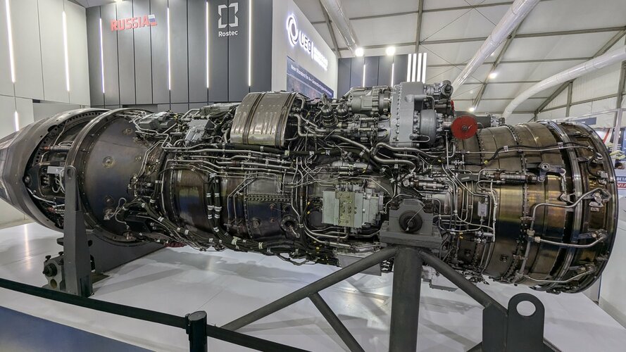

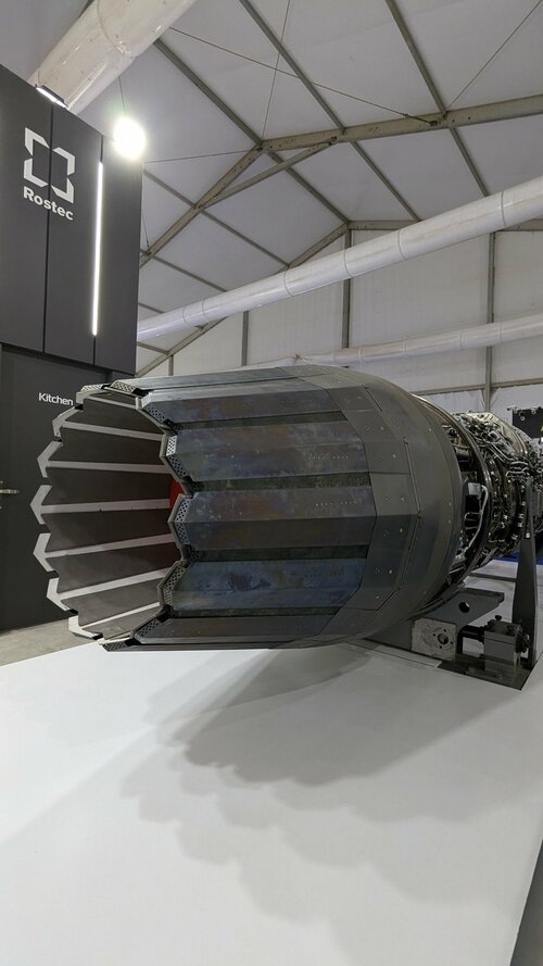

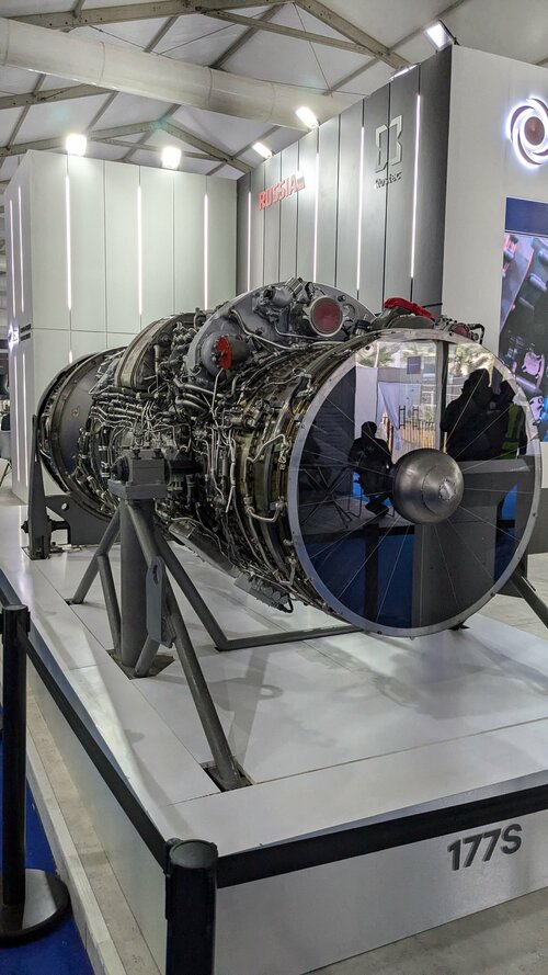

Engines are there as its one of the main items of interest to India , for many projects ,as it is retrofitable to Su35 , there is potential for huge reengining business

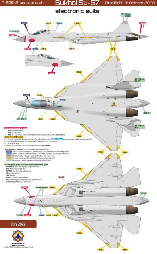

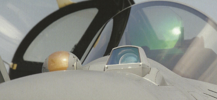

@Ainen which aperture provides MWIR frontal can you provide source thanks?
It's two.
First is OLS-50M by NIIP (101-KS-V, Vozdukh, i.e. air2air). Main air to air sensor.
Second is 101KS-P, wide angle imaging sensor tuned for low level flight and austere landing(F-15M/STD analogy here from the picture above).
I'll look for text source when i'll get to my proper laptop, iirc one of the books.
For now - traditional visual guide.
To be fair though, do we know for sure that the frontal IRST is dual band MWIR and LWIR?, it seem like the system is MWIR similar to EOTS.
Same as above, specific link needs books to check. I'll try to get home in 1-2 days.

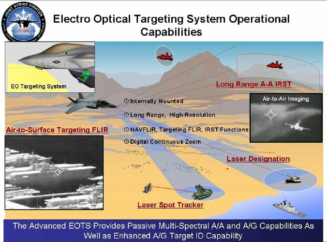

It's quite unlike EOTS though(a dedicated a2a targeting/sensor and maybe more), as EOTS "analog" for 57 is the external 101KS-N pod.
@Ainen I misread your original statement. I was assuming you were answering in the context of sensors aiding directly in air to air combat. But yes 101KS-P makes sense but OLS-50 in MWIR? Wouldn't it make more sense in LWIR?
2) Also the idea of a spherical coverage in UV/MWIR doesn't make alot of sense unless the MWIR sensors are really really bad. Any competent MWIR sensors providing spherical coverage would provide good MLD, negating any need for UV sensors.
3) I believe picture from Mariwoj is conjecture with heavy dose of fanboyism and then some. Unless you only cited to show where 101KS-P is then that's correct. Thank you.

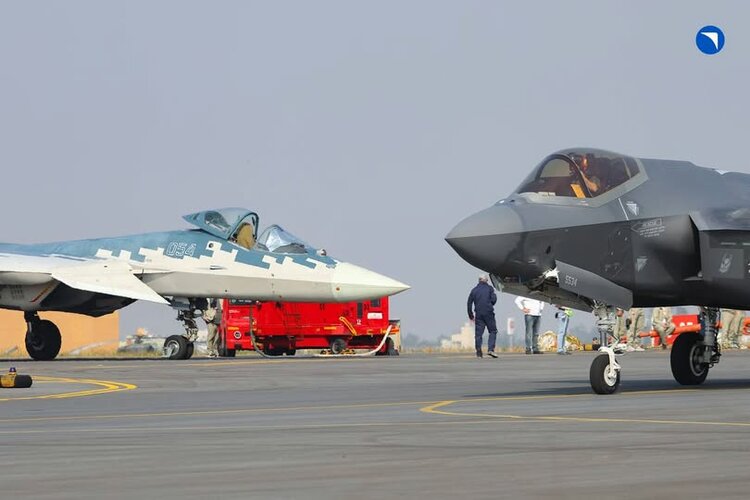

The question that wasn't asked here, were both the F-35 and Su-57 flying at the same time in the airshow? I am hearing reports the F-35 didn't fly, is it because they don't want the stealth compromised?
Disclaimer: "Why" are my explanations, not coming from elsewhere. I am not an engineer by education or profession.
OLS-27/35 (or, for instance, Rafale OPF) are mwir, too.
If the goal is (weapon grade) WVR targeting and not just long range detection with compact sensor, mwir is better - better resolution, excellent performance in clear atmosphere(matching and complementing pilot's view). It also matches missile sensors and lrf.
UV sensors are wide/constant FoV, providing persistent observation(6 appertures in 4 blocks).
IR is 3 balls, doing proper line scans (there are videos with them doing high speed rotation, doing IRST things), and they have other duties. In operation IR balls may need to stare and track, abandoning scan duties - for their DIRCM and likely HMD purposes. Doing so leaves airspace unobserved, and skipping launch warning isn't nice.
Finally, Su-57 is built around mixing(fusing) as much spectral bands as possible; more is merrier, overcoming band disadvantages, if you're ready to pay for it.
Unlike the normal fighter norm, Felon isn't built on "reasonable minimum" basis.
It's a very faithful representation of available English sources (apparently he reads Russian, too).
It matches E. Gordon book (Butowski books and articles), If you're interested, I strongly suggest the former book for cross reference and further details.

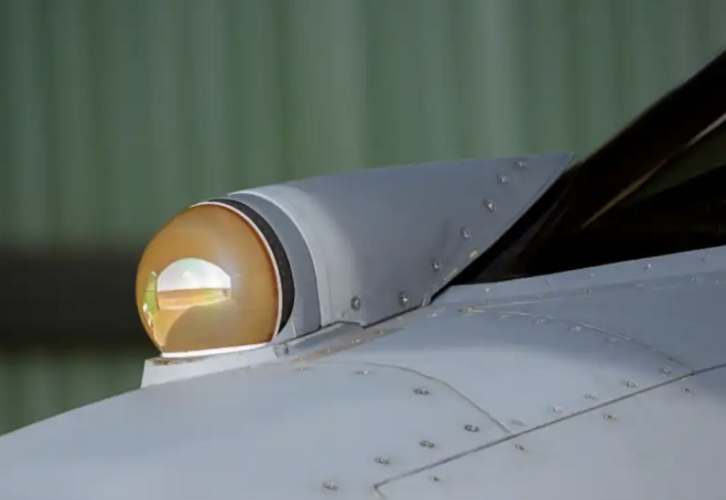

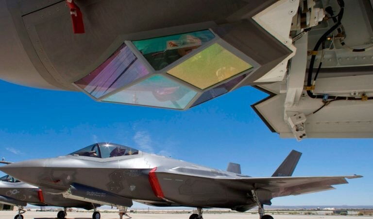

dual-band frontal irst(mw/lwir),
Front IRST unit of Su-57, 101KS-V most likely not dual band because windows transparent to LWIR are usually germanium which is a dark color and opaque in visible spectrum, or for dual-band MWIR/LWIR, zinc selenide which is yellow color also mostly opaque in visible spectrum. While the 101KS-V bulb is clear and transparent in visible spectrum which probably means MWIR only system.
The L-band IFF antennas aren't unique to Su-57, similar to Band 2 arrays on other fighters.

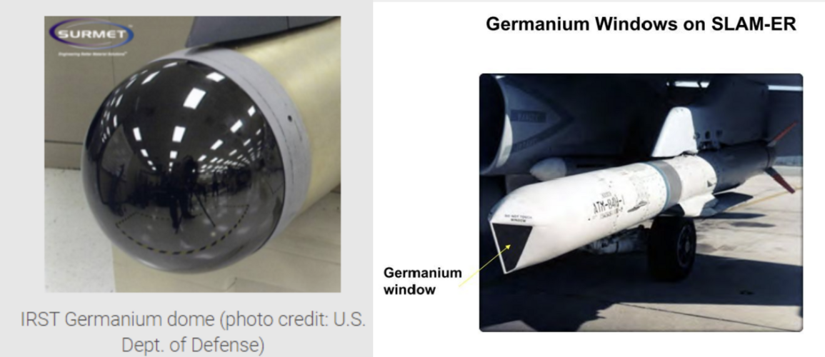

Agree, here are some photo of IR dome to illustrate your point better:
Gray opaque one is Magnesium fluoride, often used on missile seekers since it is only transparent to infrared at very short wavelength
Germanium dome on LWIR system like Pirate, IRST-21, AAS-41
Zinc Sulfide or Zinc selenide dome often used on system that operate in both MWIR and LWIR spectrum since it has very wide transparency window to infrared radiation. Often have opaque yellow color. For example: FSO and Skyguard
Sapphire dome, often used on MWIR system since it has better transmittance than Zinc Sulfide but narrower transparency bandwidth. It won't let LWIR go through

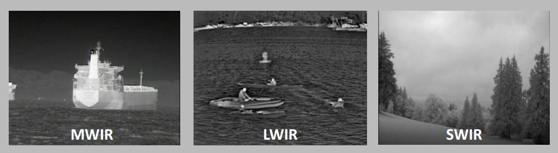

LWIR sensor can see target with cooler temperature but MWIR sensor can see target better in clutter (cloud, background surface ..etc)
In short, for target at higher altitude then LWIR is often better, for target at lower altitude then MWIR is often better

Now the question is in what configuration Algeria will receive them.
They will certainly not be the same aircraft as have been produced for VKS so far.
- with renewed MIRES and successor of 101KS?
- with a new cockpit with one "three-piece WAD"?
- with izd. 177?
