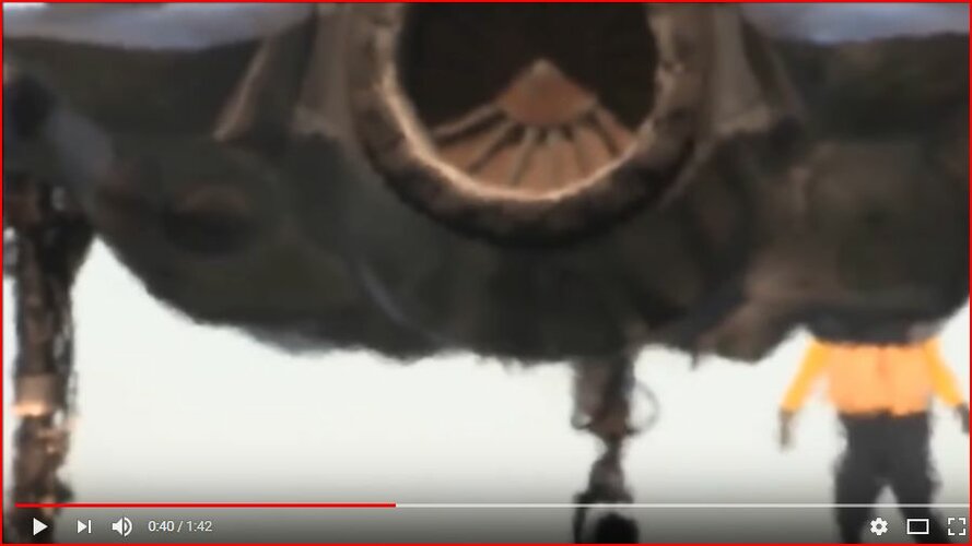

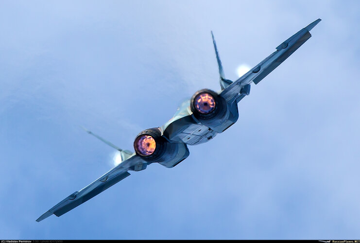

Looked very cool, at any rate.
Managed to find two of them. These go way back and were made by some 3D artist that is probably familiar to some here or at Paralay. So entirely non-official. But yeah, looked cool with them being canted and all, to facilitate the Su-57s TVC scheme. Regarding that Rockwell concept above, did they explain their rationale for doing it that way?
