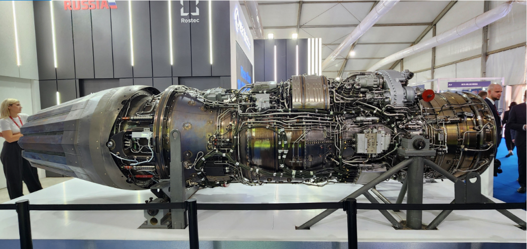

Izd. 177's specs have been publicly shown in Dubai:
https://www.secretprojects.co.uk/th...rmance-and-2nd-stage-engine.38521/post-860929

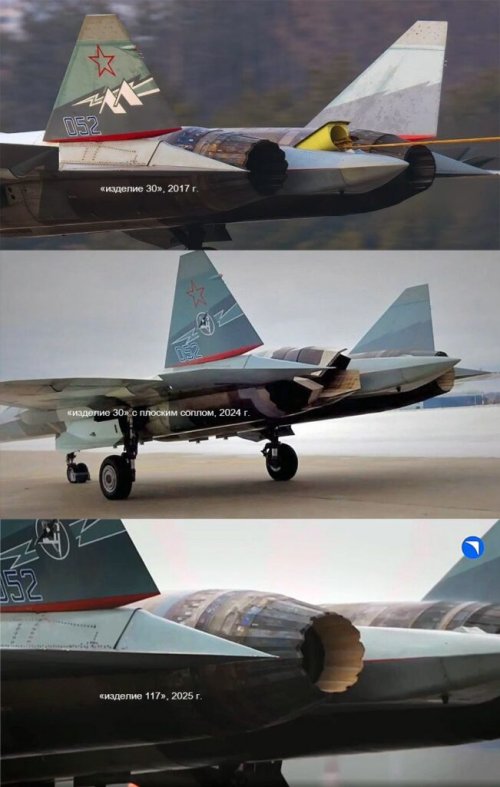

No 2D TVC on this one for some reason:
Yes,interesting detail and interesting citation :

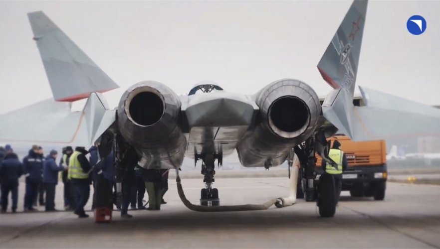

177 engine definitely has TVC nozzle:
We can see two actuators, the hinge over which the nozzle rotates, and the nozzle here is fixed in neutral position.
And you can see similar nozzle "arrangement" during pre-flight checking and engine startups on all the Russian Sukhois with TVC engines:
And since the Russians are exporting and using Flanker models with TVC, I doubt there will be the version of the engine without TVC. Su-34 doesn't need TVC, but it is questionable if they will use 177S/177 at all for that jet?!
The new nozzle appears to be an attempt to improve the aft end LO characteristics of the Su-57. If the both nozzles are pivoting up and down independently on their rolled vector axis in response to the flight controls, it is likely that they will be reflecting RF signals in multiple unpredictable directions, making any stealth shaping useless in improving the airframe signature in flight.
It is not an attempt, the nozzle definitely improves the aft end LO characteristics of the Su-57, and in standard flight envelope Su-57 doesn't need to use TVC.

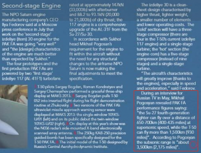

And according to the highest ranking Sukhoi people, Su-57 can supercruise with 117 engines:
https://www.ruaviation.com/news/2013/6/17/1751/
"We planned to reach a certain level and I believe that we have successfully solved this problem in the network of the first stage. Some parameters appeared to be even higher than expected. For example, we have obtained outstanding characteristics in the area of supersonic cruise and super-maneuverability», - the First Deputy Director General of Project and Research Scientific Center of Sukhoi Design Bureau, Mikhail Strelets, said."
While the 117 engine is not dedicated supercruising engine, in combination with the Su-57 excellent aerodynamics that is optimised for prolonged supersonic flights, it seems that Felon can supercruise while having over 1500 km range!

A prosaic question: isn't the absence of TVC on Izd. 177 related to the upcoming T-75 flight?
I also thought that and it is logical by the way.It seems that 177 has TVC but we will see.
According to this Chemezov says 177 will indeed be installed on VKS(?) Su-30, 35, 57, not clear if new, retrofit or both. 2 x 14,500 kgf izd. 177S for Su-30SM (and maybe Su-34?) and 2x 16,000 kgf izd.177 for Su-35 and (early?) Su-57 sounds very logical to me.
Good idea and plan. With TVC there is no need to install 177/177S into Su-34/M(NVO). 177 for the Su-30SM2,Su-35S and for sure Su-57's produced and delivered so far.Installing can be done during overhaul process.

LEVCONS deflection would be frontal hemisphere. Using TVC while minimizing LEVCONS would have positive effect on RCS and thus preferred.
I think you didn't understand what I was saying.
The effect of the TVC on supersonic trim reduction is significant, but the nozzle deflection is minimal, just a few degrees, even for the planes that don't have the LEVCONs.
Su-57 LEVCONs have just a few degrees of positive deflection (in relation to the airframe), and that is most likely correlated with the highly relaxed longitudinal stability of the plane. Modern fighters usually fix their longitudinal instability at 3% of the average aerodynamic chord length. With further relaxing of the longitudinal stability, the Su-57 enjoys a significant improvement in the lift-to-drag ratio. Relaxing the longitudinal instability not only increases take-off and landing characteristics and maximizes low-speed lift characteristics, but could also enhance transonic lift-to-drag characteristics and improve supersonic lift-to-drag capabilities. Yet, an increase in longitudinal instability will also increase the burden on high AOA pitch-down controls, which in a pure tail configuration would be absolutely inadequate.
According to the T-50 patent, during supersonic flight, LEVCONs don't have negative deflection in relation to the airframe; instead, they are in a neutral position, perfectly aligned with the wings (airframe), which is the best solution from the RCS standpoint.
For that reason, I think the Su-57 needs less nozzle deflection in supersonic flight compared to pure tail designs like the Su-35S or F-22.
Agree, minimal TVC deflections would not have any substantial effects on the LO performance during egresion, the typical situation where rear-aspect RCS may be relevant. It is questionable to what extent deflection of aerodynamic surfaces is not a bigger factor than TVC in that regard.
