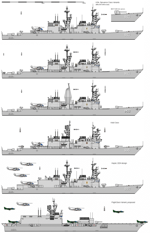

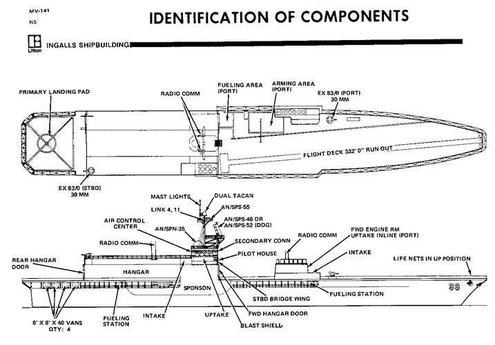

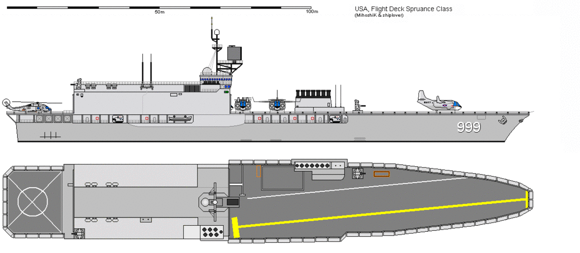

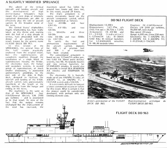

Commander Ghirandella air-capable Spruance DD design here:
https://www.secretprojects.co.uk/th...ys-about-the-vstol-carrier.43369/#post-670464
And I found these images in my files.
This design is 4 meters wider in beam than the standard Spruance/Kidd/Tico hull, at 20.72 meters rather than 16.8m. It did look to me as if a wider hull would be necessary for the extra weight and the flight deck.
I don't know how useful the Harriers would be, but the all ASW helicopter airgroup looks really useful. Although I'd probably go all of one type.

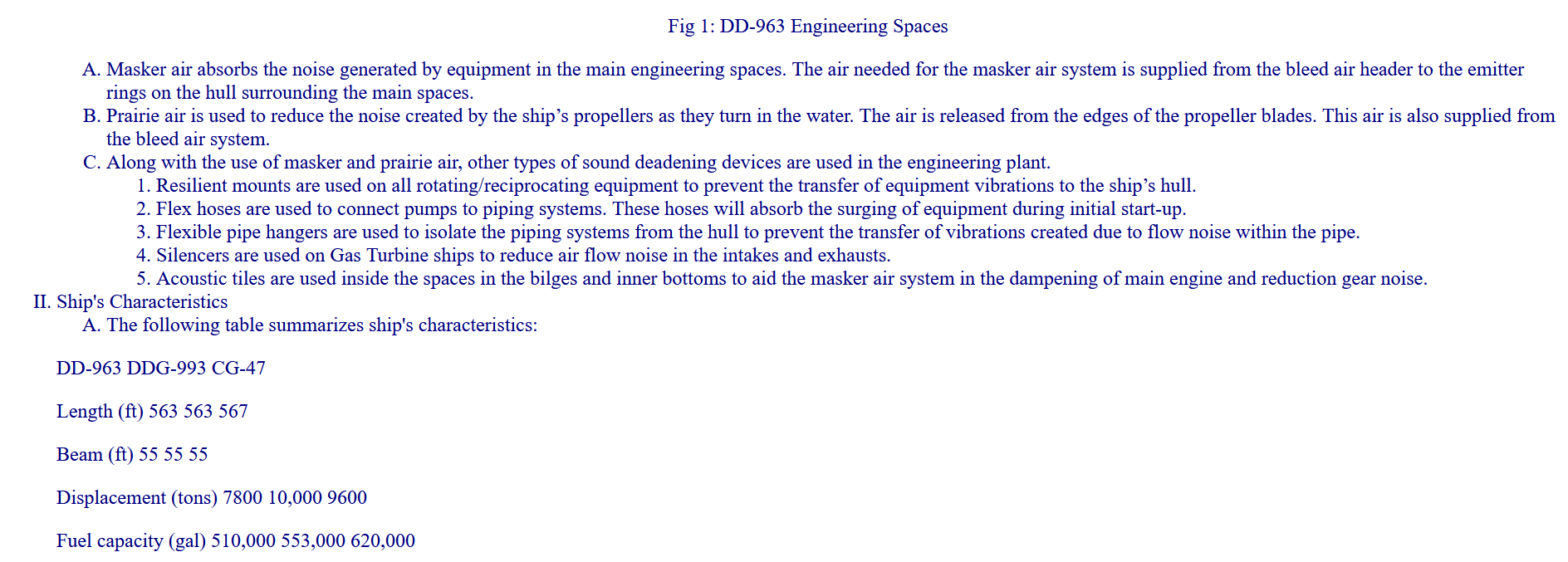

From here the USN lists Kidd at 10,000, 400 more than even CG-47. VLS Tico may displace different amount. -993 were clearly some heavily built ships

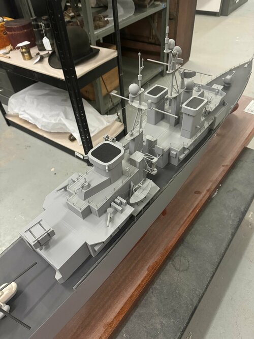

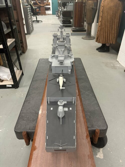

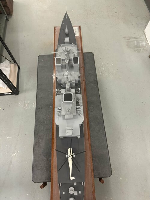

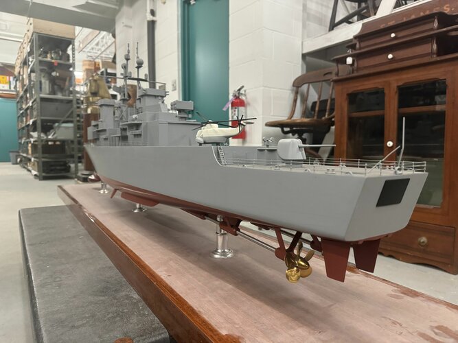

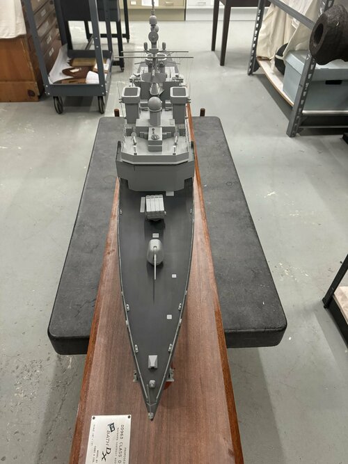

Oh I nearly forgot. As far as a Spruance-derived helicopter destroyer goes, has this been posted yet?
https://preview.redd.it/iyropl0wvoq...bp&s=2cda8782085db73f4bbfcca680e2033c916c4706

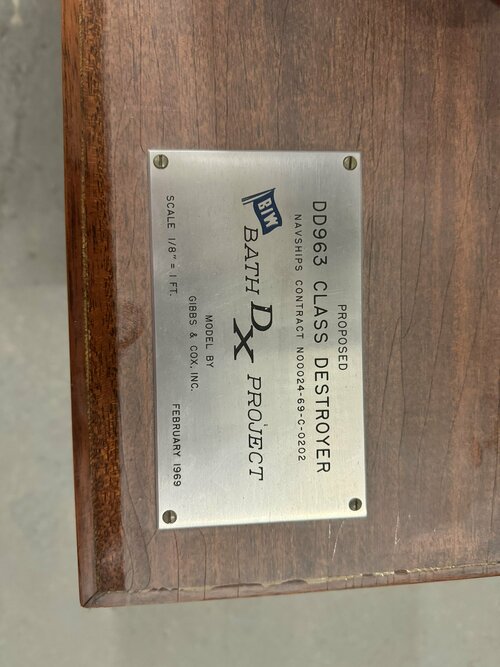

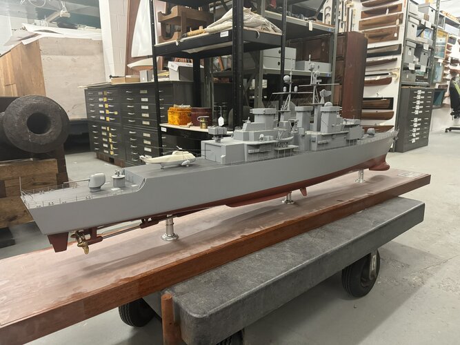

The Bath DX model ended up at the Maine Maritime Museum. I reached out to them, and they were nice enough to send photos back. Give them a visit :)
https://www.mainemaritimemuseum.org/
Electronic Greyhounds has more info on the BIW DX submission, but I don't feel like digging it out. Ping me if you want it though.
That's amazing. Thanks for getting that.
If possible, knowing more about this design would be amazing.
Finally have a few minutes of spare time.
Let’s first examine the origins of the Spruances, the DX program @acelanceloet , feel free to correct my inevitable mistakes. You’re the expert here.
As I understand it, the Spruances evolved out of the DX program, which was authorized sometime in the late 60s. The FY67 destroyer has fallen through because Vietnam ate all the money.
McNamara was the new SecDef, and he subscribed to the Total Package Procurement (TPP) system for defense acquisition. The DoD would identify what they needed, give requirements to the industry, and whoever won would get the whole contract. Losers get nothing.
DX was supposed to be the new ASW destroyer, but with the giant asterisk that it must be able to be converted to a AAW destroyer. This would be DXG. DXG would be a technically be a double-ended Mk26 ship, but the forward launcher would be devoted almost entirely to ASROCs.
The plan was first to procure DX hulls, then build DXGs. I want to say a roughly 30-18 mix, but don’t quote me on that. And it varied from year to year.
Three companies submitted proposals, Litton Ingalls, BIW (design by Gibbs & Cox), and General Dynamics. Litton Ingalls submitted the Spruance we all know and love, BIW submitted the above, and GD submitted a very compact design. Apparently 3 other companies submitted designs, but I can’t figure out who they were.
Litton ended up winning, because they offered a better contract, and had the industry and salesmanship to close the deal. Electronic Greyhounds describes it as Litton offering a "better vision for the future." I get the impression they were leading Navy on, as demonstrated by Spruance production.
Anothe reason I suspect BIW lost, the Litton design would make a superior DXG. When the DXG program was canceled, they had created provisions for the aft Mk26 launcher to come at the expense of either the aft gun or helipad. The Litton design could keep both systems, simply replacing the Mk29. Meanwhile, you clearly can't do that with the BIW design.
Also to clear up any potential confusion, Kidds are Spruance AAW conversions, not DXG.

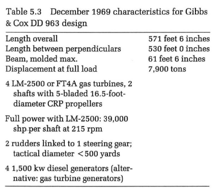

Electronic Greyhounds lists the following specifications for the BIW design:
The book also remarks that the BIW design would've been a better candidate for Aegis conversion, as it offered a wider beam.
