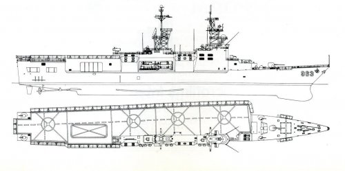

Commander Ghiradella's Air-Capable Spruance was a proposal for a modified flight deck Spruance-class destroyer that appeared in the article "Maintaining a Western Carrier Capability" in the journal US Naval Institute Proceedings, July 1978. Some references incorrectly identify this design as the Grumman/Sante Fe Air-Capable Spruance proposal or confuse it as a proposal for USS Hayler DDH-997 (Destroyer, Helicopter) or Flight Deck Spruance. Thank you TomS for your help in identifying this drawing.
Length Over All (LOA): 606 feet
Beam (hull and sponsor): 66 feet
Overall beam (width) with the ducted uptakes and angled fight deck: 87 feet
Fight deck length: 470 feet and can support simultaneous takeoff of 5 medium-sized helicopters
Weapons: 1- 5 inch/54 dual purpose gun
4-30 mm General Electric GAU 8 (a) guns
1 Harpoon launcher (An ASROC could be substitute)
1 Basic point defense missile system
Elevator measures: 62 x 26 feet
Embarked aircraft: 12 medium-sized helicopters or 8 medium-sized helicopters and 4 Harrier-type aircraft

Artist impression of Commander Ghiradella's Air-Capable Spruance drawn by "shiplover" from Shipbucket. Incorrectly identified as Grumman Sante Fe Air-Capable Spruance Design.
