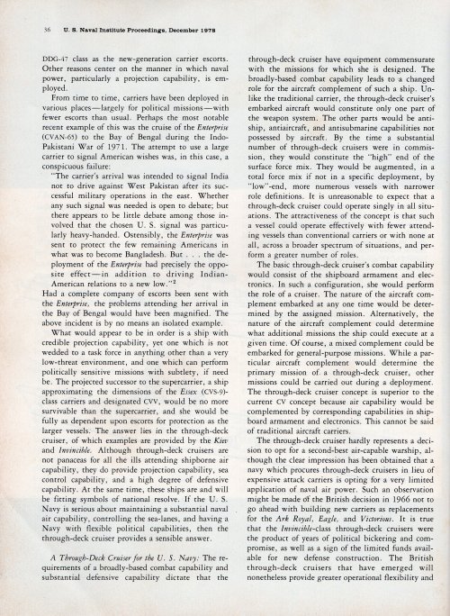

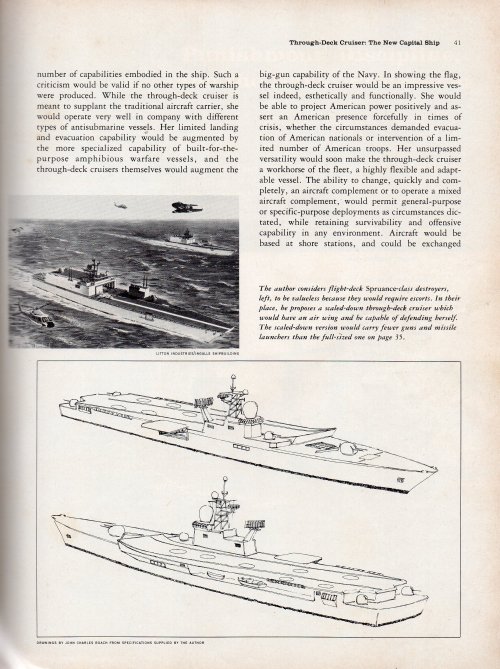

"Through-deck cruiser: the new capital ship", Michael A Cairl, US Naval Institute Proceedings, December 1978

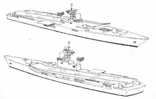

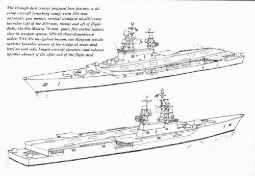

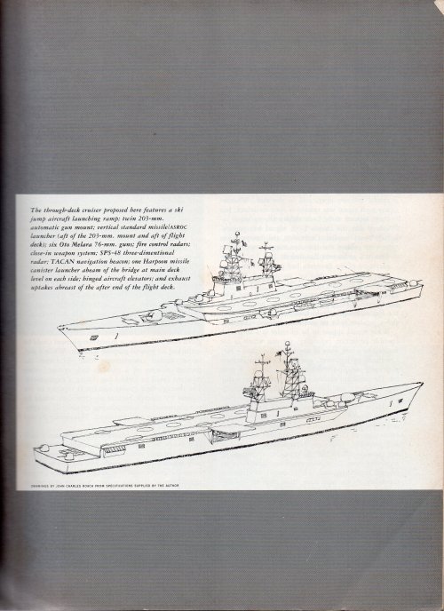

Yet another late 1970's proposal to replace expensive US Navy supercarriers and their escorts with presumably cheaper ship types. This time it's a hybrid warship called a "through-deck cruiser" capable of operating V/STOL aircraft that would not require escorts.
Ahhhh... gotta love the high expectations that they had for V/STOL aircraft in the 1970s. :)
General Characteristics
Length: 886 feet (270 meters)
Beam: 102 feet (31 meters)
Speed: 27-28 knots
Displacement: 45,000 tons (41,000 metric tons)
Embarked aircraft: 25-30 helicopters or V/STOL aircraft

Anti-ship missiles, guns, V/STOL aircraft...dude clearly had Kiev on the brain when he came up with that one!
The most impressive thing I actually find about the design is the turret with twin 203mm cannons. Related to the Mk.71 MCLWG in anyway?
I like the concept and design
An aircraft carrier which contributes greatly to its own defence, with minimal expensive escorts!!!
Hell its a true multi-purpose aircraft carrier!
Sign the RAN up for two please

IMHO the stupidest feature of this design was the fitting of the twin 8" gun. Why put a high value unit into harms way but putting them into Litoral waters to undertake bombardment, making them more vulnerable to coastal defence and enemy aircraft.
The rest of it's armament makes sense to me, if the SAM system is a point defence system such as ESSM, Sea Wolf, Mica, et al. I also like the all round fire of the Oto 76mm, useful as an AA gun, potentially an effective CIWS and good anti surface firepower, to counter small craft attacking the ship (a la USS Cole). I realise that some of these roles are undertaken by the escort, but I believe in preparing for the worst case scenario. (Hope for the best, prepare for the worst).

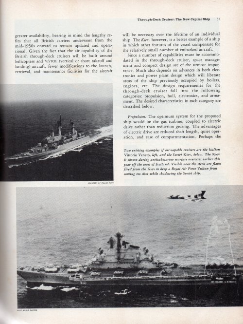

As pointed out earlier, the through-deck cruiser proposed by Cairl seems very similar to the Soviet Navy Kiev-class in displacement and dimensions.
General characteristics:
Length: 273 m (896 ft)
Beam: 32.6 m (107 ft)
Draught: 10 m (33 ft)
Embarked aircraft: 26-30
* 12-13 Yak-38 VSTOL
* 14-17 Ka-25 or Ka-27/29 helicopters
It is also interesting to remember that Cairl proposed the through-deck cruiser at a time when the nuclear powered supercarrier and its battlegroup were deemed to be too expensive to build and operate. During this period, the US Navy was investigating the sea control ship, CVV, and the flight-deck Spruance-class. At a time when it was believed that two conventionally powered CVV ships could be built for the price of one new Nimitz-class supercarrier. The Carter Administration also killed the nuclear-powered strike cruiser and the CGN-42 class equipped with Aegis on a Virginia-class hull as too expensive.
It was also proposed at a time when there were high expectations for V/STOL aircraft and that advances in technology would allow V/STOL aircraft to do the job of carrier-deployed CTOL aircraft.

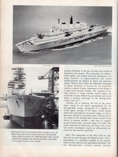

I wonder what Cairl would make of the Indian Navy's conversion of the Kiev-class Admiral Gorshkov to INS Vikramaditya or the Royal Navy's replacement of the Invincible-class with the Queen Elizabeth-class.

Or even the removal of the Invincible’s Sea Dart system despite its minimal impact on the flight operations part of the ship c to other ‘through-deck-cruisers’ and hybrids and its successful use in the Falklands (HMS Invicible’s Sea Dart).
The reality often forgotten by those wanting to conceive of ship designs is that ships need to sail in various ways to do various jobs and almost always work in groups as taskforces. So when you focus on a single hull design it may make sense to add a big surface to air missile system. But when at sea to get the most out of that system the ship needs to be deployed in a certain way which is often very different to the deployment needed to operate aircraft from a flight deck. So if you operate the ship to support flight operations the missile system (or gun) because useless and vice versa. So the hybrid capability becomes a failed investment. Making the added expense of two hulls much more attractive as it enables you to deploy the two types of systems to their maximum.

The through-deck cruiser suffers from the same fatal flaw as the CVV, it is sold as a cheaper alternative to the CVN.
A VTOL fighter might have made sense for the United States Navy on a small ASW/escort carrier protecting merchant convoys crossing the North Atlantic to the United Kingdom from Soviet submarines and Soviet aircraft carrying anti-ship missiles in the event of war in Europe.
