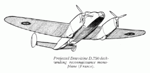

Don't know about this particular project for Spain, but the Dewoitine D.750 was a distinct pre-war program for a twin-engined naval recce monoplane:
index.php

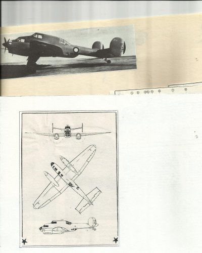

D 750
Yes prewar plane. first flight may 06 1940
2 Renault engines 12.r
From an old "Aviation magazine"
