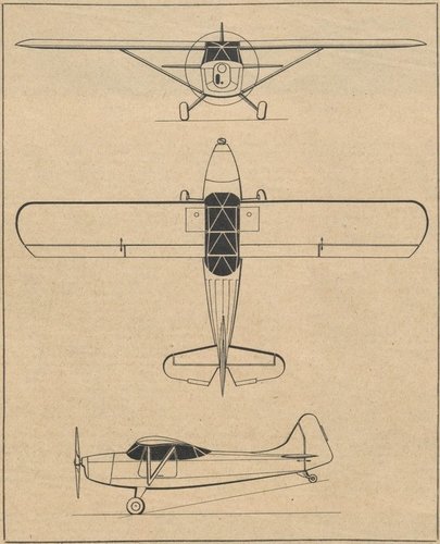

Hallo,
Brochet MB-40 :high wing light aircraft powered by one 65 hp Cont A65 engine.
Brochet MB-60 :tandem two seat high wing cabin monoplane developed from MB-50.
Brochet MB-73 :was MB.70 with 85 hp Cont. A.65-85 engine.
Brochet MB-76 :was MB.70 with 90 hp Cont C.90-14F engine.
Brochet MB-83 :was MB.80 converted with 90 hp Cont. C.90-14F ENGINE.
Brochet MB-84 :was MB.70 converted with 65 hp Cont. A.65 engine.
Brochet MB.130 twin engined light aircraft
The completing;
MB-1C was a glider of 1934
MB-10 was single seat glider.
MB-20 was a parasol wing motor glider monoplane which became Avia-50 before completing.
MB-21 was appeared in 1951, a M Darnaud proposed installing a 60 hp Salmson 9Adr in a 2-seat tandem MB 20 derivative.
MB-30 was single seat open cockpit pylon-mounted high wing monoplane.
MB-31 was originally built under contract as the Letord-Brochet 'Libellule' powered by a single 32 hp Menguin HO2. engine.
MB-40 was began as a 1936 for M Thierry Prieur as another Letord-Brochet Project. Work was begun on two airframes which were to be 45 hp Salmson radial-powered MB 30 derivatives,two members of the Aéro-club de Suresnes completed one of these airframes with a 65 hp Continental in 1949 as the MB 40 we know .
MB-50 was developed from MB-30 with various engines.
MB-60 was a tandem two seat high wing cabin monoplane developed from MB-50,powered by an 80 hp Salmson 5-cylinder radial engine.
MB-70 was developed from MB-60 with 45 hp Salmson engine.
MB-71 was MB-70 with 75 hp Minie 4DC-32 engine.
MB-72 was MB-70 with 65 hp Cont. A.65 engine.
MB-73 was MB.70 with 85 hp Cont. A.65-85 engine.
MB-74 & MB-75 as below in reply # 4
MB-76 was MB.70 with 90 hp Cont C.90-14F engine.
MB-80 was MB-70 with wide fuselage and 75 hp Minie 4DC-32B engine.
MB-81 was MB-80 with Hirth 500-B2 engine.
MB-82 ------?
MB-83 was MB.80 converted with 90 hp Cont. C.90-14F engine.
MB-84 was MB.70 converted with 65 hp Cont. A.65 engine.
MB-90 was a biplane with tricycle gear for towing gliders,Project.
MB-100 was MB-80 with modified tail and cabin,and 100 hp Hirth HM504A-2 engine.
MB-101 was MB-100 with tropical flying modifications.
MB-110 was four seat enlarge MB-100 and more powerful engine.
MB-120 was MB-80 lighter wings modified flaps and Cont. C.90 engine.
MB-130 was twin boom high-wing light pusher aircraft Project,with 160 hp engine.
MB-130/II was a agricultural low-wing monoplane Project of 1955,with chemical tanks.
MB-130/III was a twin-boom low-wing light pusher monoplane Project,powered by one 145 hp Continental engine.
