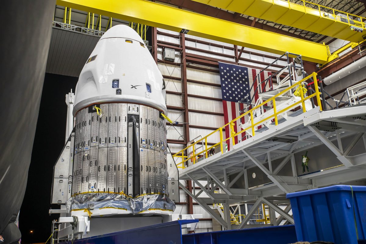

Consistent with the culture of “learn from flying,” several other changes have been made to Crew Dragon Endurance for this mission; in the highly unlikely event of all three of Dragon’s flight computers failing during reentry, Dragon now has a fourth fully redundant computer that can control the vehicle. This ensures that landing success and accuracy remain the same under extreme failure scenarios, further increasing Crew Dragon’s safety.
SpaceX has also made minor changes to the stitching on Dragon’s drogue parachutes. During post-flight inspections of Crew Dragon Resilience after Crew-1, teams noticed localized ribbon damage due to a debris strike on one of the drogue parachutes. The new stitching should further reinforce the parachute lines.
Additionally, Crew Dragon Endurance will refly Dragon’s nose cone for the first time, debut additional cleaning processes to reduce potential FOD (Foreign Object Debris), return to an earlier propulsion system seal which performed better than a newer design, debut a software change to mitigate radiation interference on communications, and showcase enhanced docking procedures to reduce interference while docking to the ISS.
