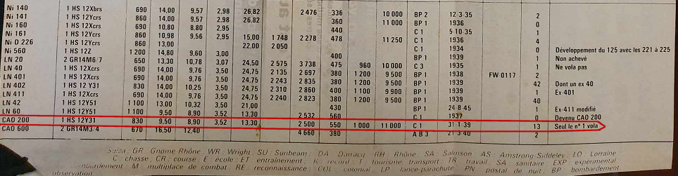

Was there really only one CAO 200? An old chart from Aviation Magazine claimed that 13 had been built, but only one flown.

For me, based on some testimonies, two CAO.200 were built. The second one was painted hurriedly for static presentation at Aviation show. Unfortunately, the paint was so difficult to strip that they finally gave up and scrapped this second prototype.
13 built: of course not. Only 2 were ordered. Maybe a confusion with VG.33?

2- Only two prototypes were built from CAO.200.

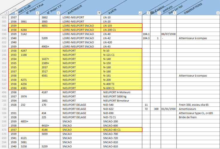

I made two captures of the Messier website at different times, and turned them into an Excel file.
Here are all the Nieuport-/Loire-Nieuport-/SNCAO-related entries:
As you can see:
All Nieuport Delage "NiD-" entries go back to the years 1928-1931.
All Nieuport "N-" entries are from the years 1934-1938.
All Loire-Nieuport "LN-" entries are from the years 1936-1940.
All SNCAO entries (none of which carries the "CAO" prefix here) are from 1937-1941.
I can accept the notion that the Messier database could hold a few typos. In fact I have found a few (on the spelling of some names), but they are the exception, not the rule. If the company held in its records no less than TEN entries for Nieuport types with the "N-" prefix, with no Delage, Loire or SNCAO involvement, I refuse to see it as a typo. Instead, it most likely indicates that at some point after nationalization, and before the CAO system was normalized, Loire-Nieuport projects were designated as "LN-" while Nieuport-only projects were designated as plain "N-".
Now I've purposely highlighted the entries that do not seem to fit designations we've been familiar with. Allow me to address them in chronological order:
N-121 C1 (1933): This clearly refers to what we know as the Ni-D 121 C1 of 1932. The name Delage was dropped when the company was made a part of the S.C.A. in 1930, so it makes sense that the "D" should be dropped.
N-140 (1934): Most certainly refers to what we usually call the Ni 140 carrier-based dive-bomber of 1935.
N-150 (1935): Probably refers to the unbuilt Ni 150 which was tested in the Eiffel wind-tunnel in 1934. This indicates that the project was still in the works a year later, which makes sense if the project eventually evolved into the LN-20.
N-160 (1935 and 1937): Of course, that is the Ni 160 fighter prototype of 1935.
N-161 (1938): It's the Ni 161 of 1936. It shows that both the Ni 160 and 161 were still under development in 1937-38.
SNCAO-60-C1 (1937): This can only be what we know as the LN-60, an optimised version of the Ni-161.
N-10 (1938): Was that the LN-10 (itself redesignated from the Loire 240)? Probably, unless it has something to do with the undocumented CAO 100...
N-200 / LN-200 C1 (1938): Now this one is a little more tricky. Assuming that these two designations from the same year refer to the same aircraft, could it be a development of the LN-20? Very unlikely, since it flew only in 1939. Besides, the LN-20 is a C3, not a C1. Therefore we can conclude that these two designations actually refered to what we know as the CAO 200 C1, also flown in 1939. The puzzling element here is that the CAO 200 is supposed to have been redesignated from "LN-60", but here we can clearly see that it was also known as the LN-200!
N-400 T3 (1938): This is of course what we know as the CAO 400 T3. Some sources even call it the "LN-400", which was assumed to be a mistake, but now who knows? It seems that between 1936 and 1938, all three designators N-/LN-/CAO- could apply to the same projects!
N-600 C1 (1938): This could be related to what we know as the CAO 600... except the latter is an AB3, not a C1! A change in mission is possible, but turning a 3-crew attack bomber into a single-seat fighter is a radical departure... The other possibility, of course, is that the N-600 was related to the LN-60, which happened to be a C1.
LN-105 (1939): Last but not least... This apparently mysterious designation was likely related to the LN-10. And indeed, if we go through the history of that airplane, there was a projected landplane version of the LN-10 with a Messier cowled landing gear and retractable tail wheel. Therefore it makes perfect sense that it must have been its designation.
To conclude... There doesn't seem to have been a clearcut separation as to whether projects were Nieuport, Loire-Nieuport or SNCAO. Several designations existed at the same time for the same aircraft depending on the sources (and possibly which facility produced them). What the above has established, as far as I'm concerned, is that the Nieuport projects of the 1930s, which we often designate as "Ni" were also found as "N-"... and that the whole thing was such a mess that I can understand why SNCAO would want to harmonize the whole thing into one single, coherent system!
