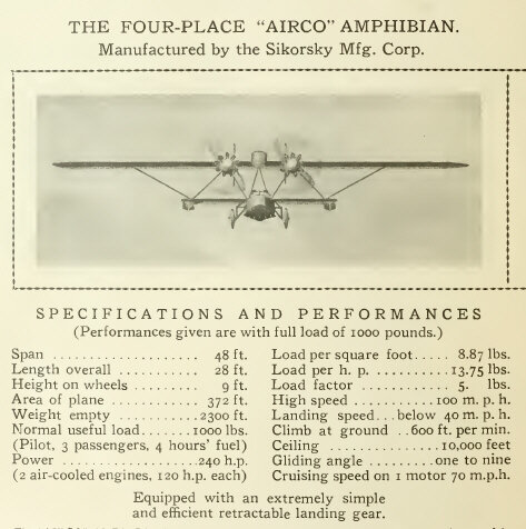

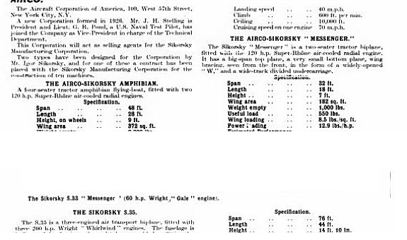

I shared this one elsewhere on the forum a few years ago, it's the Airco Messenger.
It was a smaller, four-seat version of the S-34 with two 120hp Super-Rhône engines and a simplified retractable gear. It was designed by Igor Sikorsky for the Aircraft Corp. of America (Airco), advertised in 1926, but not built.
By the way, Airco was to act as selling agents for Sikorsky Manufacturing Corp., but the deal fell through.
Since the Airco "Messenger" was not pursued by Sikorsky, it didn't get an "S-" designation.

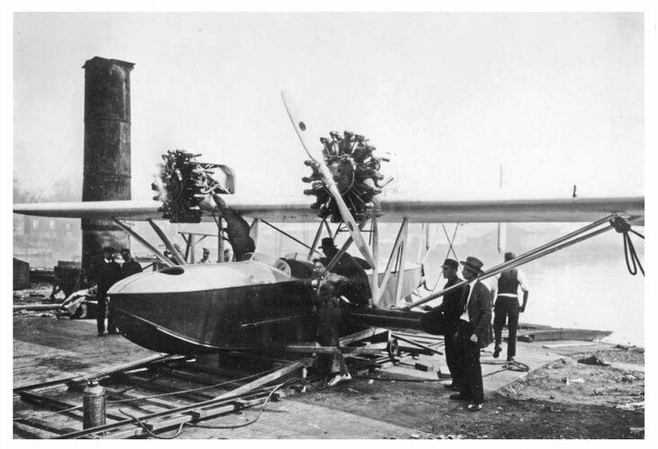

The Airco "Amphibian", of course, became the S-34.

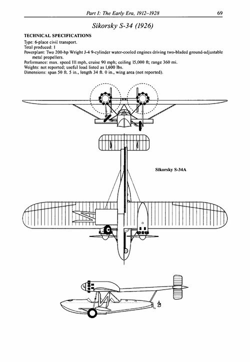

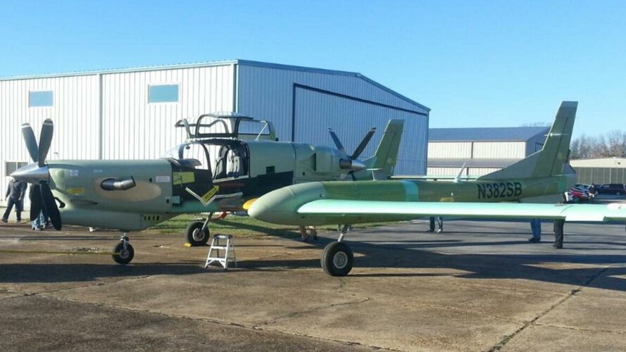

I'm surprised to have found a mysterious Sikorsky aircraft type that I had never noticed before in the FAA listings...
Sikorsky Aircraft Corp. SZ 338B
  • N382SB, MSN 0001
    Certificate Issue Date Oct 31, 2013
    Mode S Code (base 8 / oct) 51062112
    Mode S Code (base 16 / hex) A4644A
    Cancel Date 03/13/2018
    Reason For Cancellation Expiration
    Export To None
    Type Registration Corporation
  • N385SB, MSN 0002
    Certificate Issue Date Nov 1, 2013
    Mode S Code (base 8 / oct) 51067557
    Mode S Code (base 16 / hex) A46F6F
    Export To None
Another online source gives a more detailed account, which clearly gives it as a fixed-wing aircraft!
  • Aircraft: SIKORSKY SZ 338B (Category: Land, Engines: 2, Seats: 2, Weight: Up to 12,499 Pounds), Engine: Turbo-shaft
    N-Number: 382SB, N382SB, N-382SB, Serial Number: 0001, Certificate Issue Date: 10/31/2013
    Registrant (Corporation): Sikorsky Aircraft Corp, C/O John Zottola Mail Stop S212a / 6900 Main St, Stratford, CT 06614
    Deregistered: Cancel Date: 03/13/2018
    N-Number: 385SB, N385SB, N-385SB, Serial Number: 0002, Certificate Issue Date: 11/01/2013
    Registrant (Corporation): Sikorsky Aircraft Corp, C/O John Zottola / 6900 Main St Msc S212a, Stratford, CT 06614
Source: https://www.city-data.com/aircraft/air-Stratford-Connecticut.html
My first thought was that "SZ 338B" could be related to the S330/S333 helicopters. Yet it couldn't be the Firefly electric demonstrator, since it was a single-engine, single-seater... And why "SZ" when the other former Schweizer models used a simple "S" designations?
Then another detail caught my eye: the letters "SB" at the end of both registrations, as in "Sikorsky Boeing". Could these registrations have been reserved (and not used) for the SB-1 Defiant? All the details correspond: two turboshaft engines, two seats...
However, the site AviationDB, which gives even more detail, claims that the SZ 338B was a "Fixed wing multi engine type"...
although Sikorsky hasn't built fixed-wing aircraft for over 80 years!
https://www.aviationdb.com/Aviation/Aircraft/3/N382SB.shtm
My best bet is that these two aircraft were never completed, despite the regs being reserved for them, but that doesn't make them any less mysterious! Ideas, anyone?

I have finally worked out what the mysterious "Sikorsky SZ 338B" was ! Since the former Schweizer SA 2-38B Shadowhawk (RU-38B Twin Condor), became the Sikorsky SA-38B, I had a hunch, that the former SA 3-38B could be it... and after looking specifically for that particular model, it turned out that I was right: Kevin Hritz, Senior Principal Electrical Engineer at Sierra Nevada, who worked from 2006 to 2012 for Sikorsky Aircraft as Senior Electrical/Avionics/Systems Engineer, posted a photo of [N382SB] on his profile (the only one I've ever seen), and designated it as the "Sikorsky (Schweizer) SA 3-38B MCSA ISR Aircraft, powered by PT6A-34 engines."
Source: https://www.linkedin.com/posts/kevi...r-aircraft-activity-6389631563683889152-N8Tl/
More about the SA-338B:
The SA-338B Shadow Hawk aircraft is a two or three-seat, fixed gear, low wing, twin boom aircraft. The SA-338B aircraft is designed to fly slowly along a coastline at an altitude of about 1,500 to 2,000 feet. Its primary mission applications include border protection, counter drug activities, intelligence collection against regional instabilities, fisheries patrol, environmental monitoring, and search and rescue. Sikorsky is marketing the SA-338B to the United States Coast Guard and the Department of Homeland Security.
Source: https://www.airframer.com/news_story.html?release=9750
It would appear (notably from the various comments on the LinkedIn page I mentioned further up) that assembly started in 2010 and that 150 hours or PT6A ground tests were performed, but that the project was abandoned before the aircraft could fly. Also it is more than likely that the second airframe was never completed and that the registration reserved [N385SB] was never actually used.

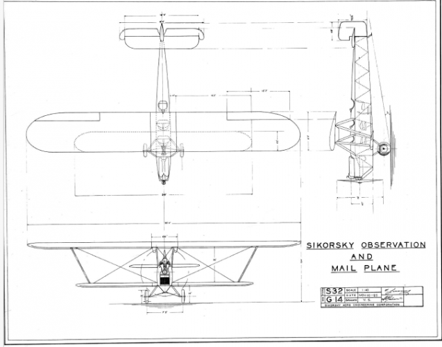

  • S-32.png S-32. Four-seat transport biplane with a 400 hp Liberty 12 engine, built for Ancol, a subsidiary of Standard Oil (1926) [no registration, c/n 1].

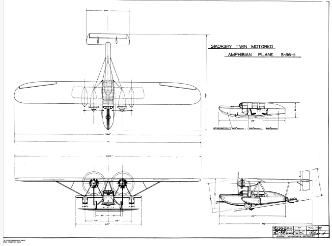

  • S-36.png S-36. Development of S-34 with two Wright R-790 (J-5) engines, open cockpits, the very first US twin-engine amphibian (1927). One to US Navy as XPS-1 patrol aircraft [BuAer A-8005, c/n 1].

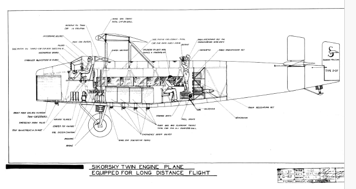

  • S-37.png S-37-1 "Ville de Paris". Similar to S-35 but longer range and 500 hp Gnome-Rhône Jupiter engines. Built for René Fonck as replacement, but flight canceled after Lindbergh won Orteig Prize (1927) [X1283, c/n 2]. Became the 18-passenger "Southern Star" [R1283] as first commercial transport between South American capitals and across the Andes, mostly on floats (1927).
  • S-37B.png S-37-2 (S-37B) GUARDIAN. Second aircraft built as a bomber with Consolidated (their Model 11) for an Army bomber competition [(N)X3698, c/n 1]. Evaluated at Wright Field as XP-496 but unsuitable, and subsequently sold as 20-passenger aircraft to NYRBA, Pan American's competitor on South American air lines [NR942M].

as we know the prefix "DS",as a series for primary designs,and that
was chined from begining of production helicopters,but the early
series for aircraft as I know was prefix "G",can anyone shed the light
on this ?.
on this ?.
Probably Gluhareff, as in Serge Eugene Gluhareff
No,he joined Sikorky in 1944,
You have confused the son - Eugene Michael Gluhareff (1916-1994) - with the father - Michael Evgenievich Gluhareff (1892-1967). The former joined Sikorsky in 1942, the latter in 1924 (together with his brother Serge who, along with Igor Sikorsky, was one of the initial test pilots of the VS-300).
I don't think so,here is a Sikorsky G 14,58,63 & 98 ?.
These are simply company plans for the S-31, S-38, S-35 and S-37B, respectively.
What you consider to be designations is probably just drawing numbers.
Your would-be G- designations are confusing enough, but it's even worse with the numbers you give to your attachments, which can be a further source of confusion (e.g. image "27" is also your "G 58" and in actual fact just the S-38). I wish you would make an effort to properly designate your attachments instead of using numbers like you always do.
Your would-be G- designations are confusing enough, but it's even worse with the numbers you give to your attachments, which can be a further source of confusion (e.g. image "27" is also your "G 58" and in actual fact just the S-38). I wish you would make an effort to properly designate your attachments instead of using names like you always do.
I said a series,not designation,and I didn't always do that,of course
the prefix "G" is meaning anything,drawings or sheet numbers.
I said a series,not designation,and I didn't always do that,of course the prefix "G" is meaning anything,drawings or sheet numbers.
It could represent "anything" but why the continued resistance to 'G-for-Gluhareff' drawing numbers? After all, Michael Gluhareff became Chief of Design for Sikorsky (then, the Sikorsky Aero Engineering Corporation).
And the use of 'G-for-Gluhareff' had a known precedent as a component in GS-1 - the JN-4D sesquiplane conversion. That Gluhareff-Sikorsky "wing design was used on almost every airplane, amphibian and flying boat that the Sikorsky Aircraft Company developed from that point forward."
-- https://sikorskyarchives.com/sikorskys-other-aviation-pioneer-michael-gluhareff/
