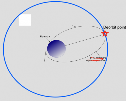

_Del_ said:
Also where I first realized the HEO with the commsat orbits spending most their time over an operational area (something I already knew) is another benefit in the context of orbital bombardment.
Physics don't make that work. Any thrust to deorbit an object in a geostationary orbit is also going to make it move out of sight from the target. Technically, deorbiting from GSO (with the minimum propellant) is going to put the object 90-180 degrees away from the original stationary point.
Look at the diagram below. This is what entry from HEO (GSO) would be like.
Byeman said:
HEO is Highly-Eccentric orbit. A geostationary orbit has zero eccentricity...
ETA: I also do not see why you couldn't deorbit from GSO into a stable HEO and then deorbit orbit over the same location you held GSO over on the next pass (even though absolutely noone is suggesting that because it involves a lot more fuel than deorbiting while approaching a higher apogee, lower velocity in a HEO).
HEO is High Energy Orbit.
There is no such thing as a " stable HEO" (either definition) when it comes to ground tracks. Any orbit other than GSO means the ground track is going to move. Even deorbiting from the apogee of a Highly-Eccentric orbit means the entry is going to be 90-180 degrees away from the target.
