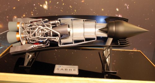

I had a looong talk with the Reaction Engines representatives, a very usefull one, so when I will have some free time to spare, I will write some extract of it.
EDIT: Oh found already some spreadsheet materials on their homepage so my questions have been partly answered at least.

Nice pic of the SABRE, lots to get right and lots that can go wrong there!
