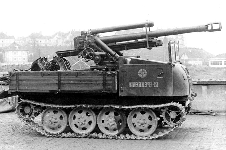

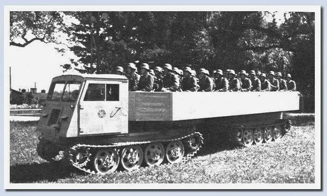

According to Spielberger's "Halbketten-Fahrzeuge des deutschen Heeres 1909-1945" it's the RS 1500 Waldschlepper built by Kloeckner-Humboldt-Deuz AG shortly after the war.Not quite sure about that one. An experimental halftrack version?

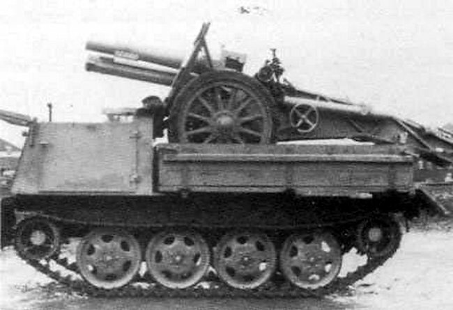

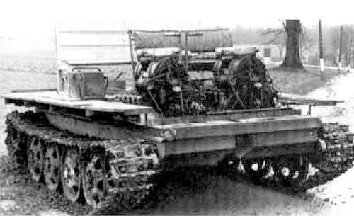

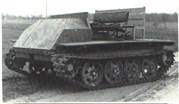

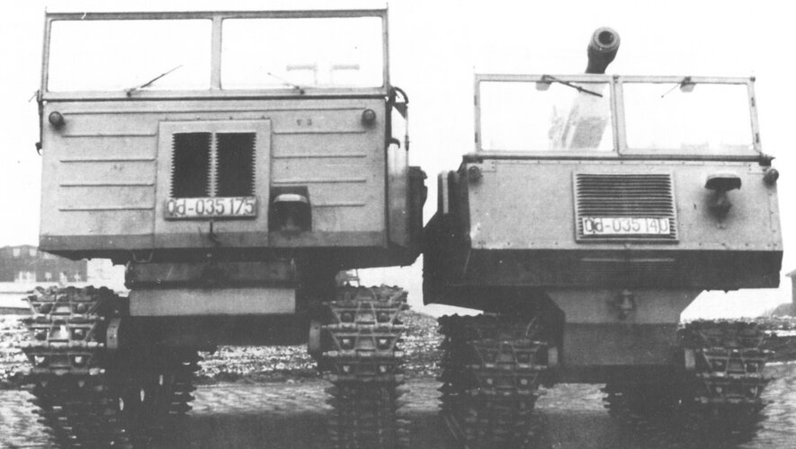

This one might be some sort of test rig for those waffentrager SP guns that showed up late in the war as prototypes.For the double, not sure how this would be used, maybe towing artillery or mounted with a flak.

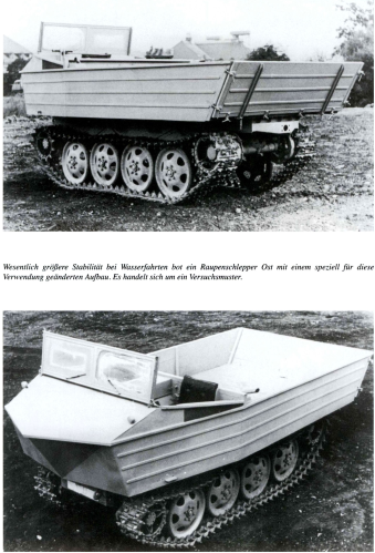

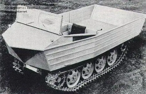

This is, I believe a civil version bulit after WW2 as a forrest-tractor. It was based on the RSOThe amphibious version

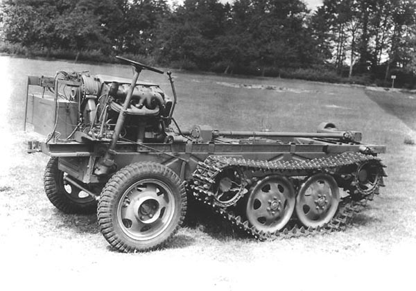

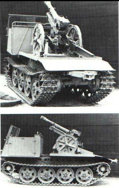

A photo of the chassis of that variant.

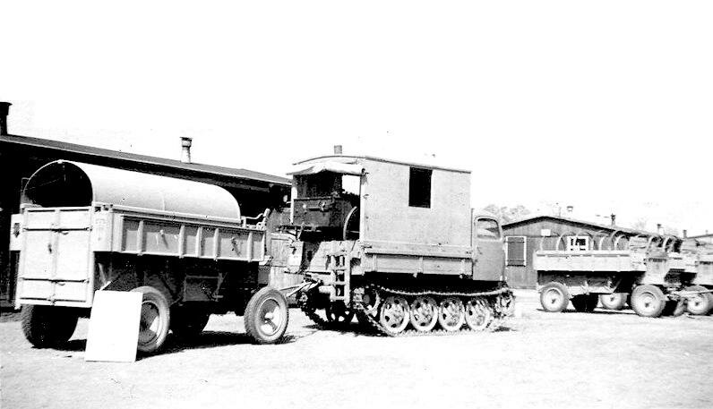

Not real clear shot, but RSO's with wood fuel conversion kits on them
