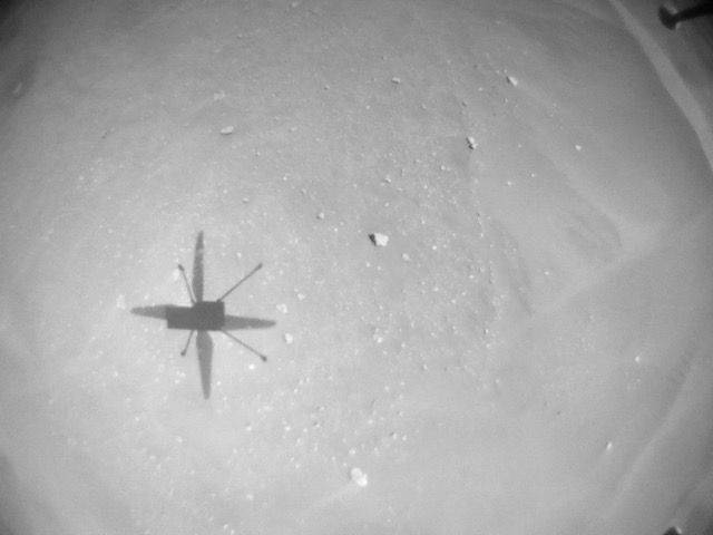

#MarsHelicopter is breaking records again!
Ingenuity completed its 25th and most ambitious flight. It broke its distance and ground speed records, traveling 704 meters at 5.5 meters per second while flying for 161.3 seconds. http://go.nasa.gov/2U43zuH
View: https://twitter.com/NASAJPL/status/1514016381435482113
Good news for Ingenuity, let's hope that the 26th flight goes further and faster still.

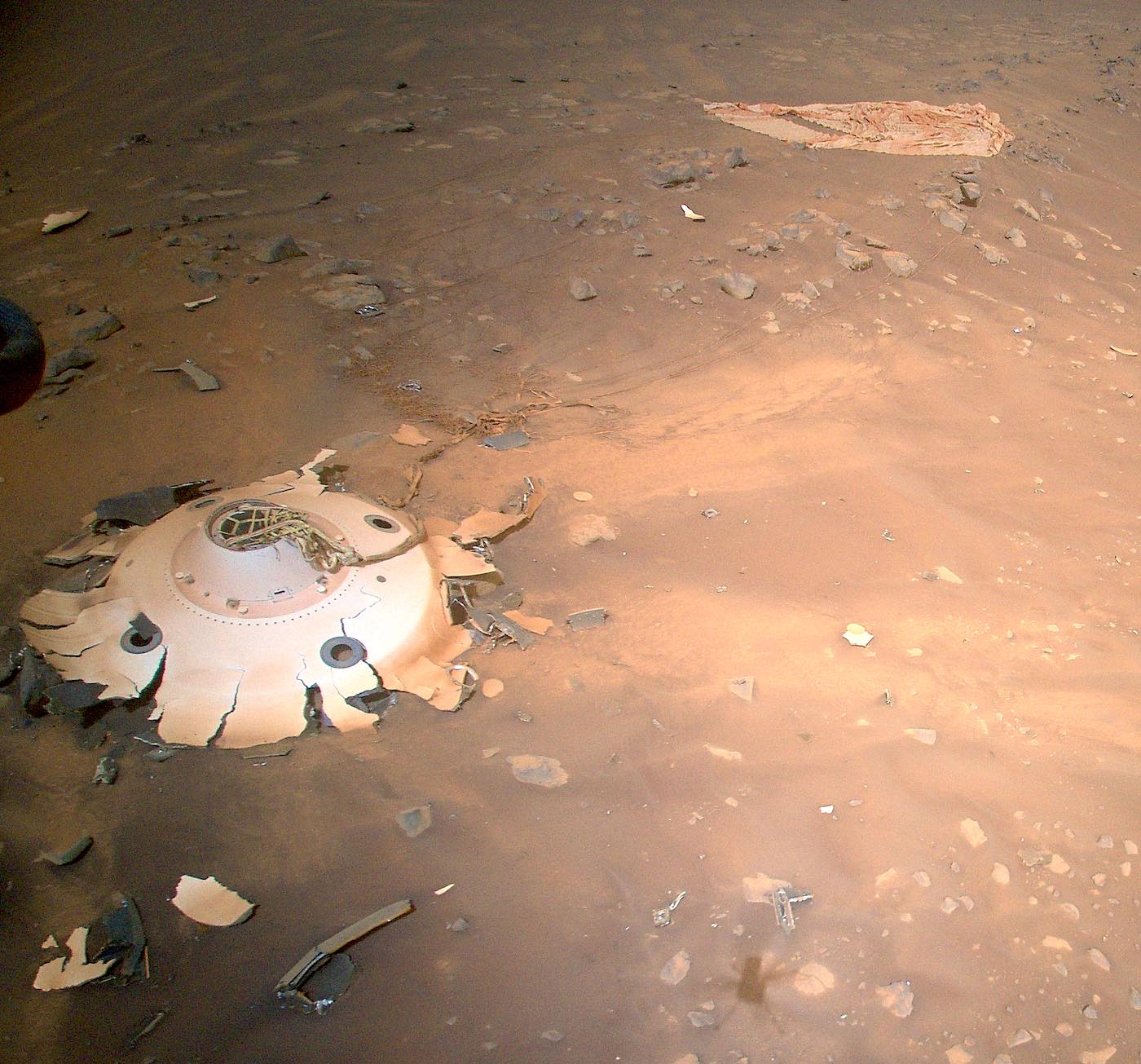

Another stunning set of images:
