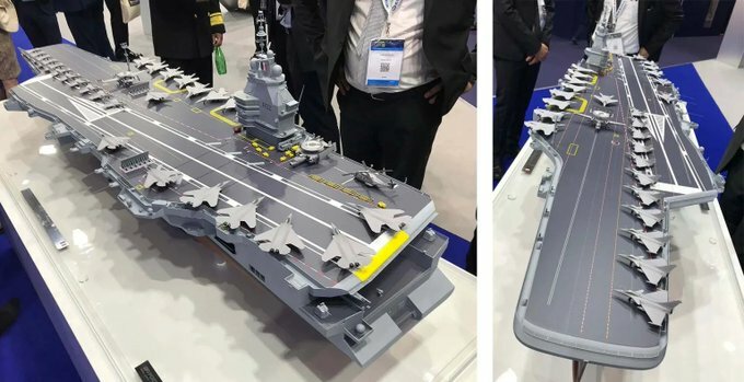

Yeah the Ford and Fujian do have a notch but it seemed less dramatic than the PANG one.
The Queen Elizabeth has a square-ish deck with no notch though. Is that beacause the flight deck isn't angled and so it is less bothersome for the landing planes if you park planes there?
Yes, it's because the QE flight deck isn't angled.

A bit of a porker - as has been observed for some time, the PANG design has the outline of a third catapult on the hull port side forward.
Whether that catapult gets installed or not is a different matter…

Perhaps, still the outline of the third cat is there.
