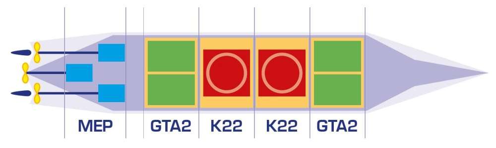

PA-NG: a nuclear electric propulsion
With the PA-NG, propulsion is fully electric thanks to a new Steam Energy Conversion system (CEV) developed by TechnicAtome, Naval Group, and Chantiers de l’Atlantique. All of the thermal power generated by the reactors will be converted into electricity through turbo-generator units.
A redundant power plant will manage distribution to all of the ship’s systems and equipment, from lighting and air conditioning to sensors, weapon systems, kitchen cold storage, as well as the electromagnetic catapults and arresting gear on the flight deck. But also—and this is the major innovation—to the propulsion system itself.

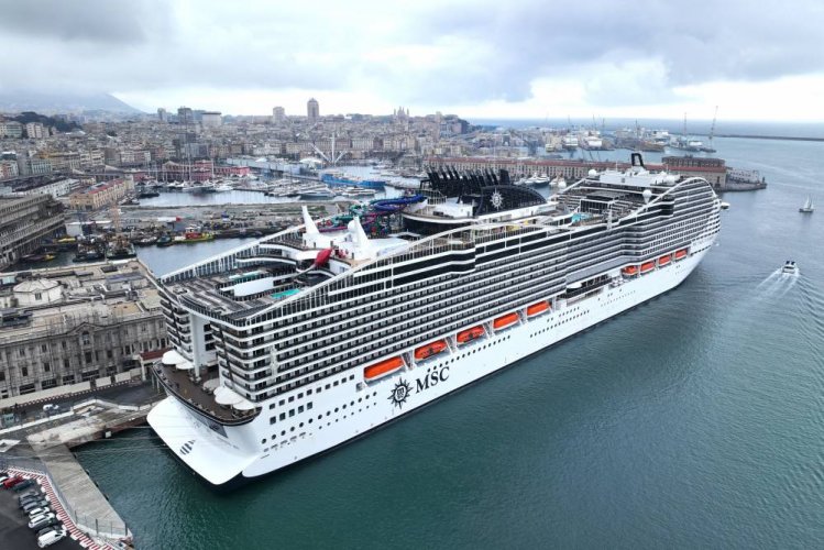

This fully electric architecture, already mastered by Chantiers de l’Atlantique on large cruise liners, is a first for a major warship.
The main advantage of the CEV is its flexibility of use
: it allows power to be instantly distributed according to demand, optimizing energy consumption as well as reactor performance, especially during changes in operating regime when increasing speed. As a result, the reactors will be less harshly stressed by power surges.
Thanks to optimization of the energy/propulsion systems, as well as the hull design—whose hydrodynamics have been refined to minimize drag—the power required for the PA-NG to move is significantly reduced compared to its predecessor.
In fact, the installed power amounts to only 440 MW (thermal) across two reactors for a 78,000-ton ship, compared to 300 MW for the Charles de Gaulle and its 42,500 tons. These gains are achieved in particular on propulsion thanks to the electric architecture.
Given the power generated, it is necessary to move from two to three propellers. But once again, thanks to electric drive, one major constraint of traditional propulsion systems can be avoided: mechanical transmission requires long shafts running through much of the ship to connect to the engines.
Here, energy is carried simply by cables to three electric propulsion motors (MEPs), which drive much shorter shafts. This greatly eases the layout of onboard spaces, offering considerable volume savings.
Electric propulsion is also quieter, an advantage for warships in terms of acoustic stealth, making it a major step forward for the PA-NG program.

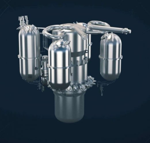

Finally, it should be noted that the large energy reserves of the K22 reactors will extend the interval between nuclear refuelings. Instead of every 8.5 years, as with the Charles de Gaulle, they will now take place every 10 years.
As for the ship’s operational availability, it will be able to reach 300 days per year.

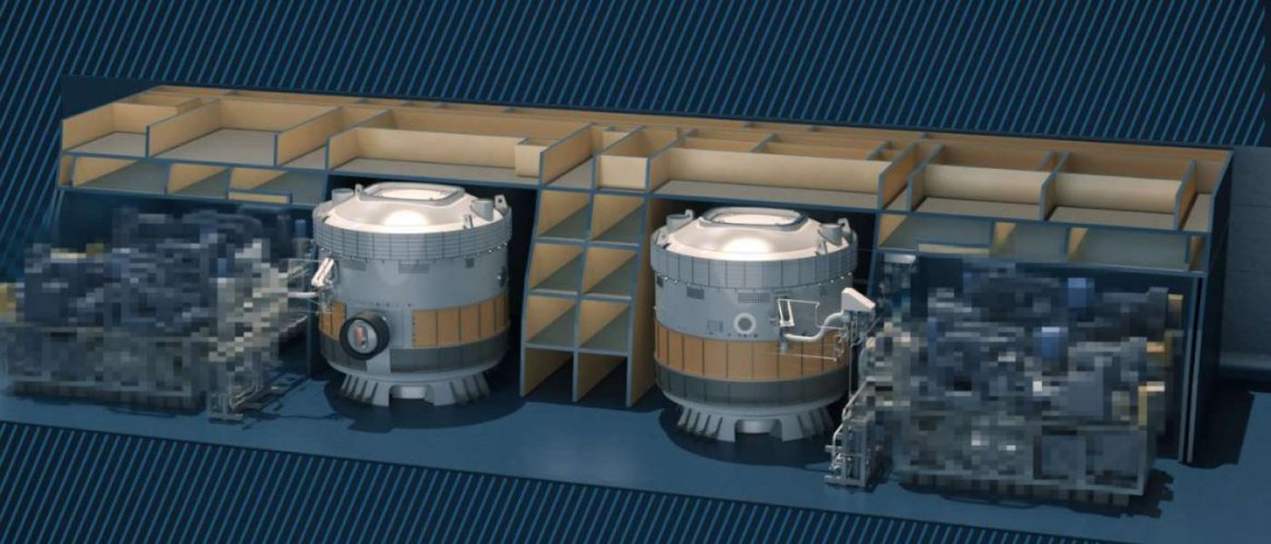

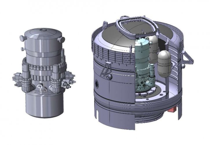

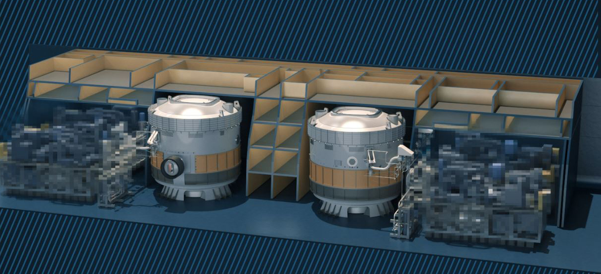

K22 with their shell (pic nº1 above) are 15 meters high and weight 2000 tonnes (vs 800 tonnes for K15)

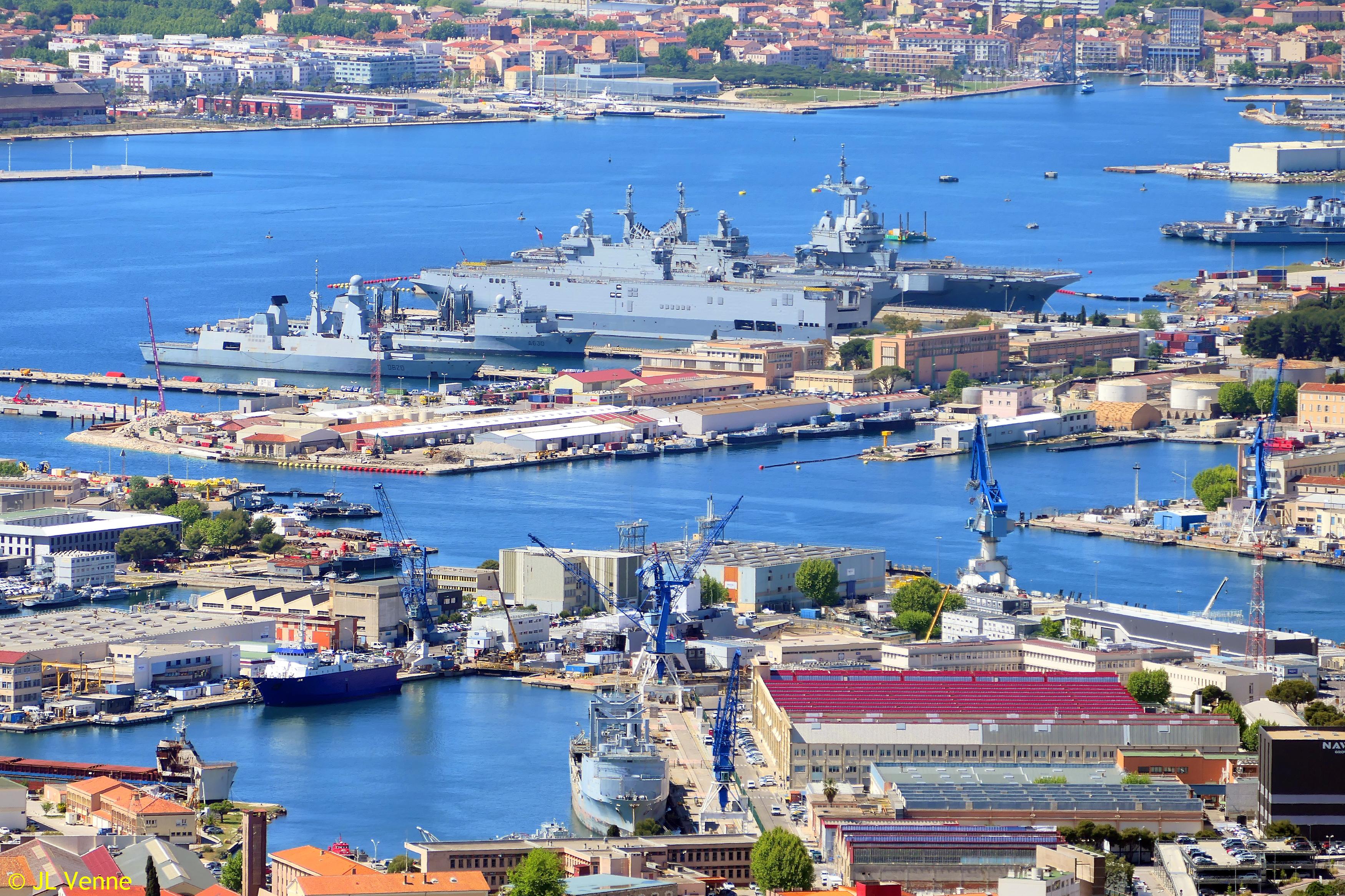

Incidentally, we know that the new facilities being built in Toulon are already designed to accommodate 2 PANGs, namely 1 dry-dock and 2 piers

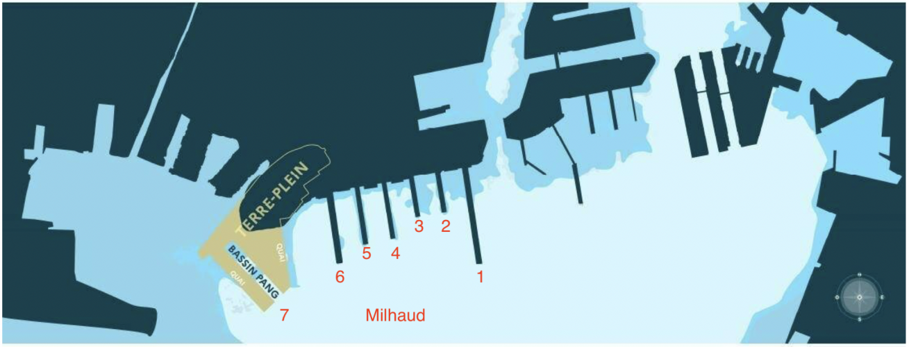

This new hub, called Milhaud 7 (the area already includes six berths, including Milhaud 6 where the Charles de Gaulledocks), will be developed on brownfield land and on a section reclaimed from the harbor. It will cover an area of 10 to 15 hectares (Vauban covers 15 ha) and will include a large dry dock, two piers, and a vast hardstand area to accommodate hangars and workshops. The nuclear facilities will remain those already in place for the SSNs and the Charles de Gaulle at Missiessy.
The new dry-dock is expected to measure over 350 meters in length and around 60 meters in width.
It should also be noted that the decision to build two large piers of about 400 meters each at Milhaud 7 will leave open the possibility of accommodating a second aircraft carrier if France decides to give the PA-NG a twin.

EMALS/AAG alone is already ~1.5 billion €, same for the 2 K22 nuclear power plants...

EMALS/AAG alone is already 1-1.5 billion €, same for the 2 K22 nuclear power plants...

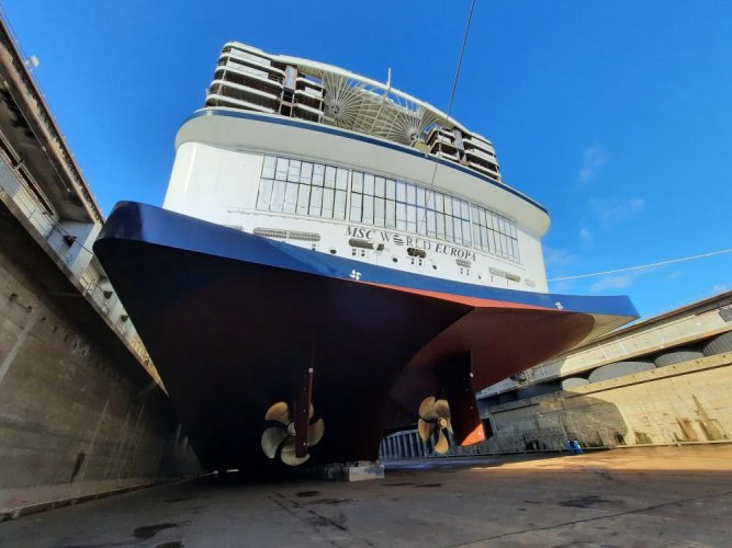

On the “ducktail” feature of the PANG, which is used to increase the waterline length
Any idea as to why other carriers aren't using the same trick? Could that indicate that the K22 reactors are somehow a bit underpowered?
They are indeed really pushing for maximum efficiency,
Thanks to optimization of the energy/propulsion systems, as well as the hull shape—whose hydrodynamics were refined to minimize drag—the power required for the PA-NG to move is significantly reduced compared with its predecessor. In fact, the installed power amounts to only 440 MW (thermal) from two boiler rooms for a 78,000-ton vessel, compared with 300 MW for the Charles de Gaulle and its 42,500 tons. The gains are achieved in particular in propulsion thanks to the electrical architecture
This design approach may also reflect some of Chantiers de l’Atlantique’s DNA. They hold a 35% stake in the PANG joint venture (with Naval Group at 65%).
Just look at the World Class cruise ships currently under construction at Saint-Nazaire
After all, the PANG will be built in the very same dry dock.
Yeah, this is just lenghtening the waterline without lengthening the ship itself.
There's several of such tricks to lower resistance: The Dutch are looking at fitting hull vanes (basically a carefully shaped hydrofoil) to future warships. IIRC these basically lower the wake wave for decreased resistance.
Not sure if it's structurally feasible on the scale of an aircraft carrier though...
