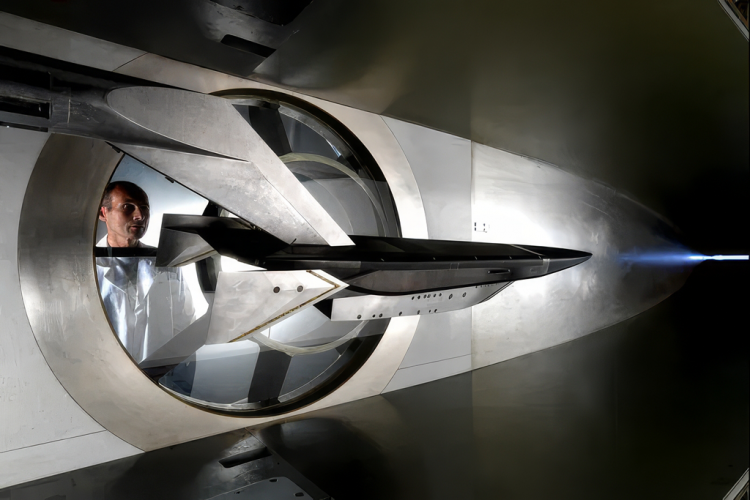

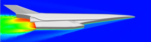

For the ASN4G it's hard to tell how large the missile will be, but it does seems to have a larger cross section than ASMP.
ASN4G will be constrained by Rafale centerline carriage constraints to approx 6.3m x 85cm (missile body size). Height likely no more than 50cm given the need for a flat glider profile. Fin size TBD... the fins will likely have to fold if the goal is internal carriage (which is not confirmed).
https://rafalenews.blogspot.com/p/rafale-weapon-load-out.html
The plan is actually to have 2 versions of the ASN4G :
  • a "small" version for the F5 Rafale, still probably larger than ASMP
  • a "full size" version for NGF
So the latter version of ASN4G will be much larger than ASMP or even the ASN4G fitted to Rafale
Full quote from French parliament : https://www.senat.fr/compte-rendu-commissions/20241021/etran.html#toc4
The F5 is essentially a new Rafale. This latest aircraft is designed to carry the ASN4G, a future hypersonic missile — its speed will indeed exceed Mach 5 — and ultra-high-velocity, with maneuvering capabilities throughout its entire flight. This represents a true technological breakthrough.
The Rafale F5 will need to carry this missile, which is significantly heavy. As such, it will require a new engine, conformal fuel tanks, as well as enhanced radar detection, connectivity, and electronic warfare countermeasures.
Its successor, the SCAF, will in turn carry the final version of this missile, whose range will meet the specifications we initially requested.
Looking at the drawing above I doubt it can be made much longer (<0.8 m ~+14%) or larger without potentially hitting the front wheel/-cover or aft hook or even main wheels (if wider).
The hook being the greater concern with emergency landing... ofc the pilot could drop the nuke before landing (imaging the political trouble that would follow).
A minor issue: it could shift the center of gravity somewhat away from the ideal attachment location on the pylon.
