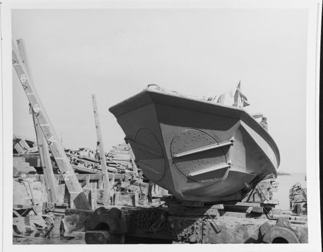

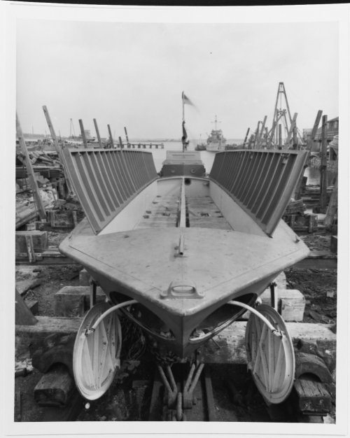

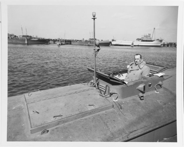

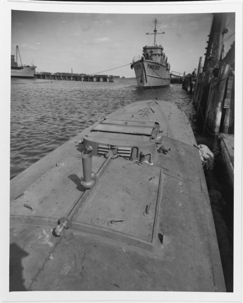

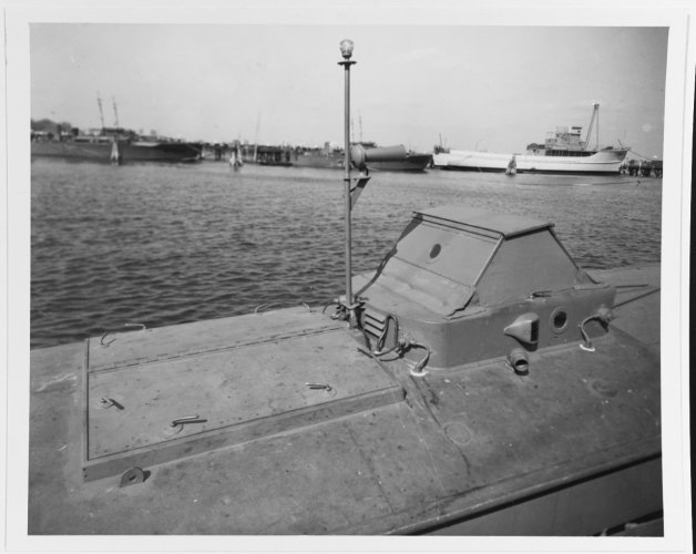

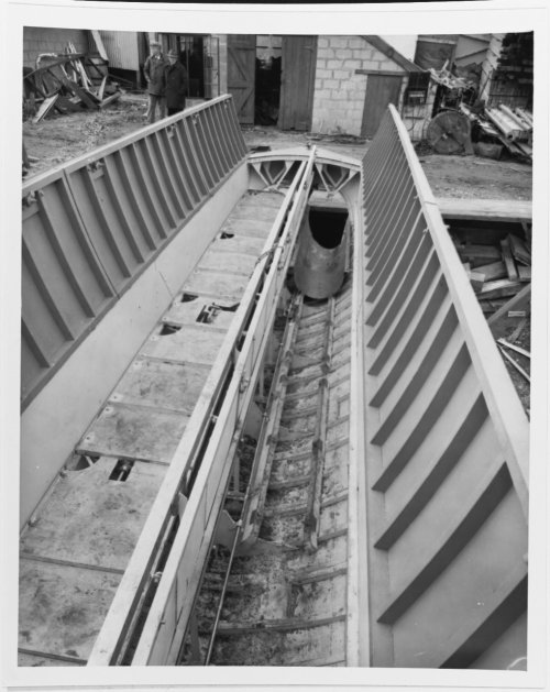

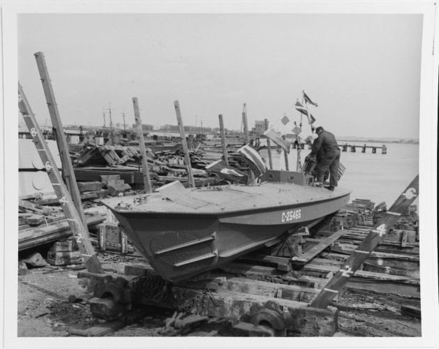

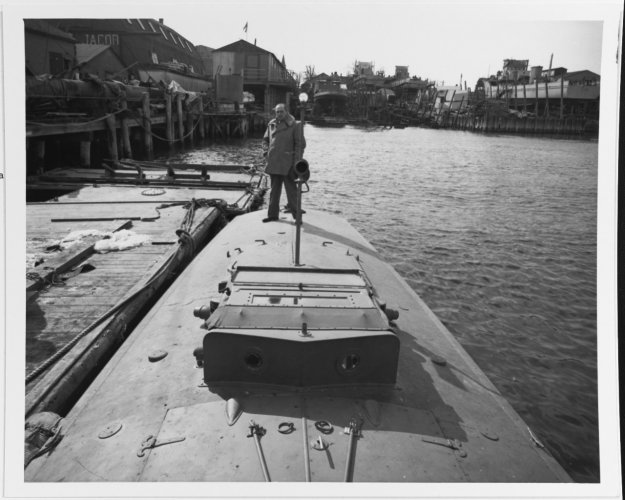

Howdy everybody, got a mystery for someone to solve. I found the following images on the history.navy.mil site by chance when doing research for my earlier Shinyo post, made elsewhere. I ended up with a bunch of photos of a mystery US naval craft, that according to the website, is only called "USN boat no. C-25465". The other description for the photos is "semi-submersible torpedo craft". It says the photos are dated to March 1943, and were taken in the Robert Jacob Shipyard, City Island, New York. Thoughts? I have never heard of this craft. It doesn't look like anything I am familiar with. A one off prototype?

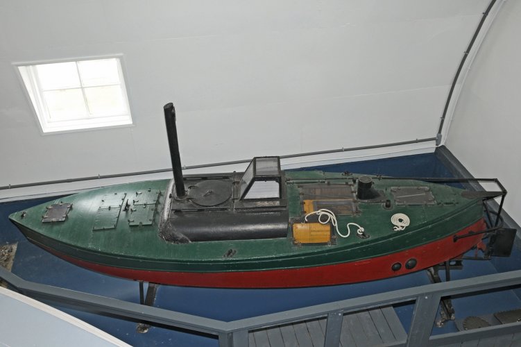

If I recall correctly, this boat had been on display at the Battleship Cove Museum in Fall River, MA. It had been used in the South Pacific during WWII in support of OSS operations.
That would be fascinating if true
UPDATE: I checked into EurekaBoat's lead, and the boat mentioned at Battleship Cove is a Gimik, which does not resemble the vessel in question. :(

This is pictured and mentioned briefly in Friedman's "U.S. Small Combatants: A Design History." It has origins back to the Shearer Submersible MTB of 1918. There is a drawing of the craft in this post on this page:
https://www.naval-history.net/PhotoZHinds.htm
I have photos of the 1918 design which looks nothing like this drawing so there may be more than one in WW1.
My guess is the subject of this post is the 1942 Shearer prototype.
why not follow through with the design? The concept seems sound to me. They clearly built a whole vessel too, just to cancel?
You probably wouldn't be able to tell just how bad your situational awareness would be until you built it. Even a periscope would be higher above the water than the operator's eye level, especially when running closed-up. And if it's got any kind of high-speed planing ability the bow is going to completely block the operator's eye-line as soon as it starts to lift.
While there are a couple of semi-comparable designs - the Italian MT/MTMs and the British Boom Patrol Boat, they were all short-range designs designed for special operations, so even if the concept worked you also needed a delivery system. The Japanese Shinyos were different in being a defensive system where the target would come to them.
Operationally, with the majority of PT targets in the Pacific being barge traffic - Daihatsus and the like, the design only featuring torpedoes is a major limitation. The more experienced the PT fleet got, the more they emphasised guns, not torpedoes.
(See also a whole slew of WWII fighter aircraft the US built and then ditched without production orders).

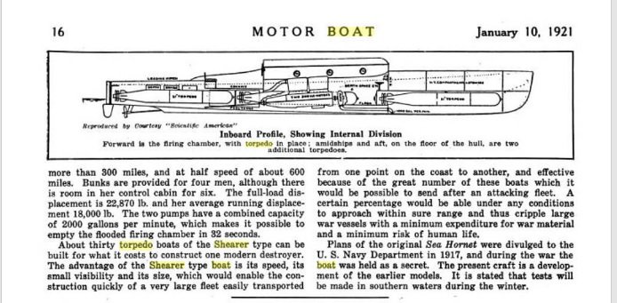

Gave this fascinating craft the Covert Shores treatment, http://www.hisutton.com/USN-Semi-Submerged-Torpedo-Boat.html

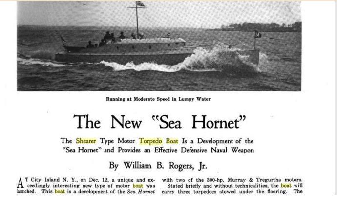

I think that the suggestion that its a Willian B Shearer design, or at least inspired by his earlier designs, is likely. But I have not found any additional info on this 1943 design beyond the original post here.

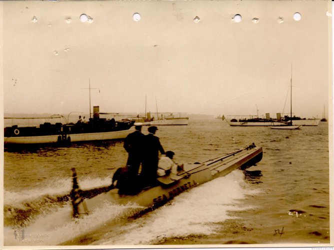

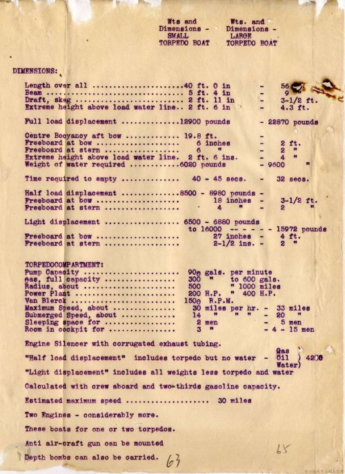

Shearer did a second boat that was bigger- 58' long- after WW1

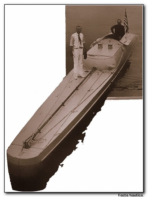

MR.W.SHEARER'S ONE MAN TORPEDO BOAT

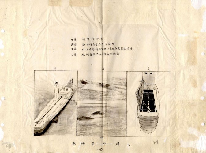

Similar principle to RN's X-class mini-subs.
Near-unique, high-value targets, a scary-mary delivery system...
