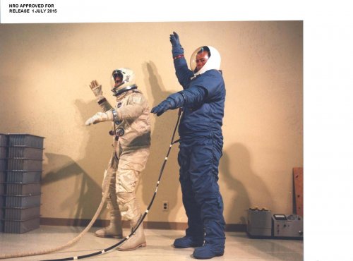

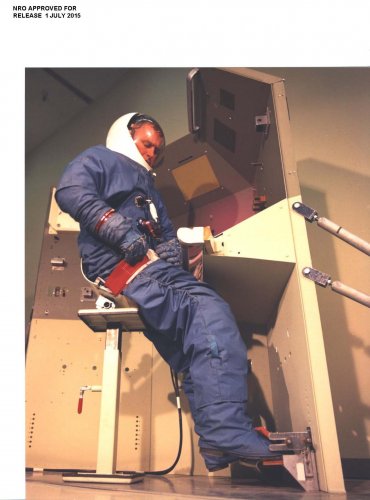

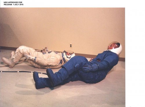

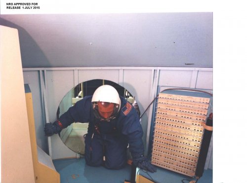

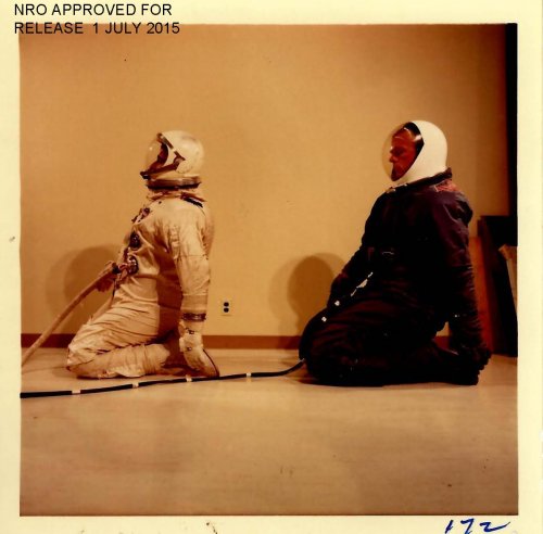

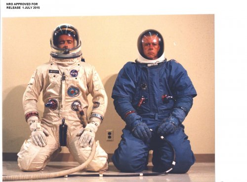

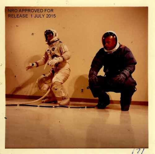

MOL space suit.

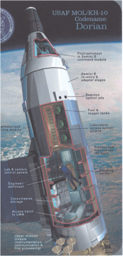

The color artwork at the top of the flyer is really misleading. This was NOT the MOL spacecraft. In fact, this was something that the contractor produced to try and sell the basic MOL design to NASA as a space station (in competition with the Apollo Applications Program). So it's not MOL, not military, and not even something that they were building.
NRO released that image without a caption, and because the artwork is so good, lots of people jumped to it and assumed that it is the MOL. It was only a proposed civilian version.

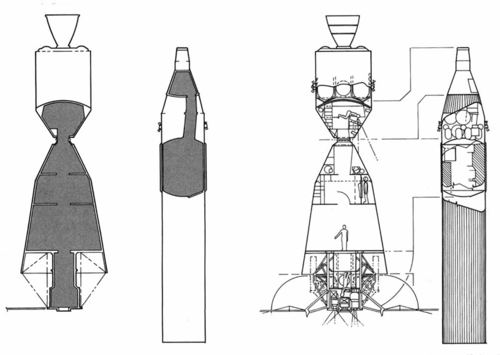

Was a proposal,but NASA was not interested.
Right.
NASA wasn't interested because, at that times, it had already its plans for civilian space station.
First place was MORL, to not mistake with MOL, otherwise the "Manned Orbiting Research Laboratory", with emphasis on "research".
The study was carried on by Douglas, and evinsioned the use of a spent Saturn C5 third stage.
Such concept was later adopted by NASA within its AAP (Apollo Application Programme) first in the form of "wet workshop" (an empty third stage used as it is), later in the form of "dry workshop" (a customized third stage), eventually the later concept made it leading to the actual Skylab.

MORL was from begin a dry workshop and to be launch with Saturn IB (Saturn V for higher orbit or Mars fly by)
it had to use spent S-IVB stage either as counterweight for Rotation for artificial Gravitation experiment or as test bed for wet workshop.
What happen to MORL is unclear to me, but NASA switch to S-IVB Wet workshop under AAP, i think it's because Apollo hardware since MORL used Gemini hardware
MORL was two very different proposals mind you. One was based on using the MOL as a basis and a Titan as a launch vehice, (with the assumption it would 'compliment' the USAF MOL program) and the other was actually a Saturn-1 (Apollo Lunar Adapter Module section being a 'dry' lab and using part of the SIVB as a 'wet' lab expansion) based system that NASA prefered. One major reason being that the Saturn MORL could use either Gemini or Apollo for servicing and crew transfer while the Titan MORL could use Gemini but not Apollo without extensive, (and expensive) modifiction.
NASA prefered the Saturn-1/1B MORL due to the availabiilty of more pressurized space, experimental space and expandability than the Titan based MOL-MORL:
616588
MORL based on the Titan was ONLY 'cheaper' from Air Force accounting and assumed several other 'modifications' to NASA operations that NASA didn't like. (Including replacing the Saturn-1 with the Titan-IIIM and modifications there-on to fly Apollo and NASA was on the hook for those costs all by themselves since the Air Force didn't 'need' the capability) When it became clear that neither the Saturn nor Titan based MORL was going to be authorized it was decided to move away from all the 'wet' concepts towards 'dry' stations that would require minimum if any on-orbit work and be direclty ready for operations. Again NASA prefered more room and more capapablity since they were unlikely to get a continued "Space Station" program authorized so they went with the Saturn-V boosted 'dry' SIVB station concept.
