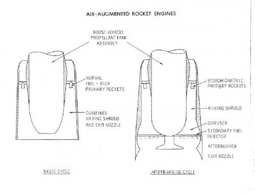

Yes. It's a form of ejector ramjet... a ramjet that can work at Mach 0 because of the ejector effect of the rockets. About 10 years ago i built one - granted, a small, crappy one - under contract to NASA.
