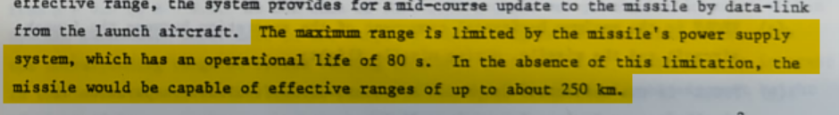

maybe most of the aim260's range comes from battery life. the US did a study with the aim120A and basically if it had infinite battery life it could hit a non maneuvering target at 260~km away while still having some energy for maneuvering. but now with GPS guidance and much more fuel and potentially better fuel it reduces losses and better kinematics. if the same infinite battery was also assumed it may reach out as far as 500km with a very rough estimate
this probably assume it is launched from Mach 2, altitude of 65kft against target with similar speed and altitude. Very massive max range but useless in reality. Against targets that cranking and diving down to lower altitude, I doubt it can go pass 100 km
I'm a bit skeptical of these figures simply because it seems unlikely the rocket motor could hope to take it that far. The rocket motor used on the AIM-120A is likely somewhat better than the one used on the AIM-7M, but not greatly-so.
If you launched the missile at very high altitude while being well over Mach 2 at a non-maneuvering target approaching head-on you might get a pretty impressive number but in no way can that be considered the "practical" effective range of the missile.

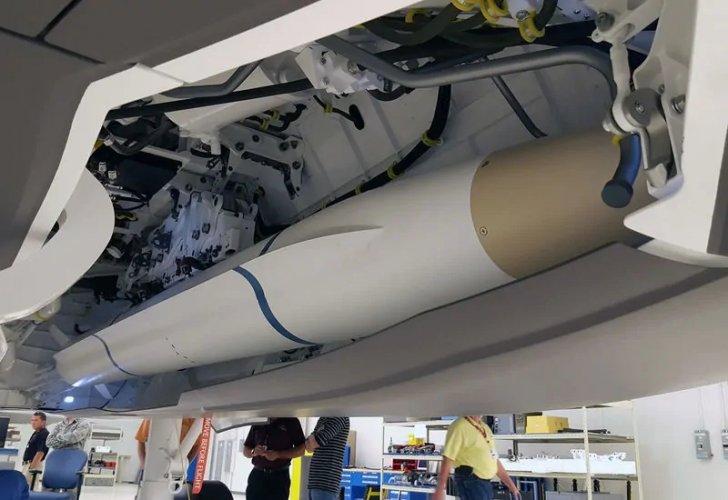

Has it been spotted in the wild yet? I know those "official" CGI renditions of it seen in Powerpoints and such but I'm always a bit doubtful of those.
not sure about the launch conditions but the whole premise is infinite battery life meaning you can loft that missile above 100,000 ft let it slowly loose speed fall back down to earth and hit a target
Yes but that also require both the launcher and the target at very very high altitude and high speed head on. In most case the enemy will go low or crank to defend which mean the range go down significantly.

that doesnt have much todo with what i said. the whole point is maximum range is mostly limited to battery life. with modern batteries its possible to just increase max range from going from 80 seconds to 120 seconds. some suspect this is partially how the aim120D gains its 50% increase in range while producing no figures in motor or energetic improvement
My point is that if “AIM-260 gain its range only from increased battery life” then that probably not very useful and far inferior compared to range gain with bigger motor (R-37, PL-17, AIM-174) or unique propulsion method (Meteor, PL-15).
I think it is a lot more likely that AIM-260 gain its range from having more fuel, lower drag and more energetic fuel, maybe it can also control the burn rate.

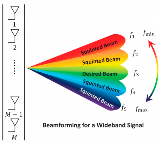

Radar bandwidth is significantly narrower compared to bandwidth of ESM system.. Even 500MHz can already be considered ultrawide band for a radar whereas average ESM can detect signal between 0.5-20 GHz.
Because ESA radar suffer from beam squinting when its frequency are too far apart.
And you don’t even need AESA for frequency hoping, you can also do it with mechanical steered radar, it nothing new.

What is beam-squinting?
In an AESA/PESA beam steering is done by applying phase shifts across antenna elements. However phase shift corresponds to a time delay only at one specific frequency, at other frequencies, that same phase shift translates into a different effective delay. So the radar will point at wrong direction if the transmit frequency is too far from center frequency
