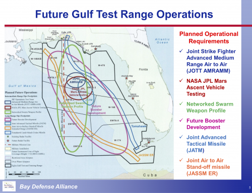

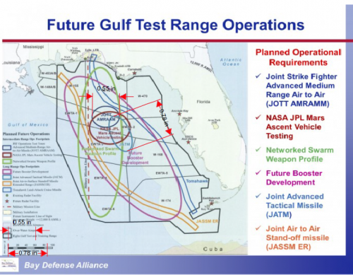

JASSM ER is what it's supposed to be in the small text and somehow transformed to an air-to-air missile on the right. JATM's range doesn't seem to be much more than AMRAAM's in the chart above.

Anybody know what, "Future Booster Development" is?

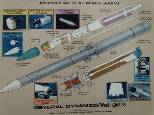

Just a thought.... LM bought GD (did they get the missile division along with the F-16?) so maybe they started with the old AAAM studies & tech.

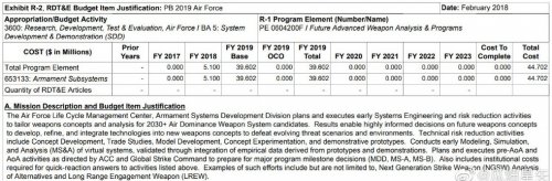

Was it? Happy to be corrected if so, I haven't seen a breakdown of where LREW funding went, just the line items Flateric found showing it's existence. Those were talking broadly about assessment and architecture investigation at OSD level, implying they had a concept in-hand (in 2017) they were trying to flesh out/refine before giving the green light to start building hardware. They also mention handing off to services after 2017, which could mean that they handed off to USAF and the Air Force handed it to LM in the subsequent years.

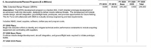

Some people say the LREW program has merged into ERWn program which is a rapid prototyping program aimed to develop a long range air-launched advanced multi-role interceptor (mainly used as a boost phase interceptor to counter BM).
But the ERWn program has some trouble and is temporarily stuck now (but the program is not dead).
May 30, 2019
"Defense Department plans for a new kinetic boost-phase interceptor, an air-launched weapon envisioned for fighter aircraft to attack enemy ballistic missiles, stalled this month after the Air Force and an unnamed contractor failed to agree on contract terms to develop the new capability. .... Asked if it was now fair to characterize the ERWn program as a project that is now over, Stefanek said: "A more accurate characterization is: The ERWn program was a rapid prototyping project that was funded and had an approved acquisition strategy, but we were unable to agree to contract terms." "
Not sure I follow the remark about JASSM-ER since it's consistent with other charts.
On the right hand of the slide, it says "Joint Air to Air Standoff Missile." On the left, it's back to the more usual (and correct) "Joint Air to Surface Standoff Missile."
