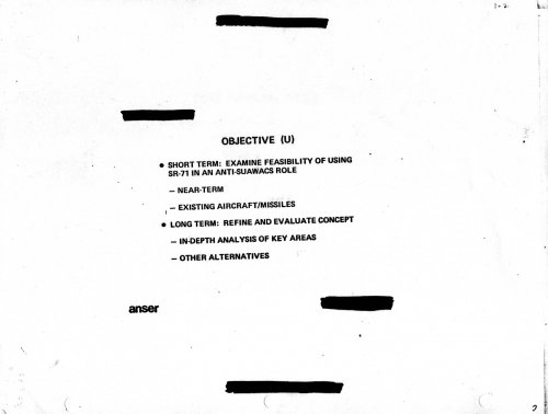

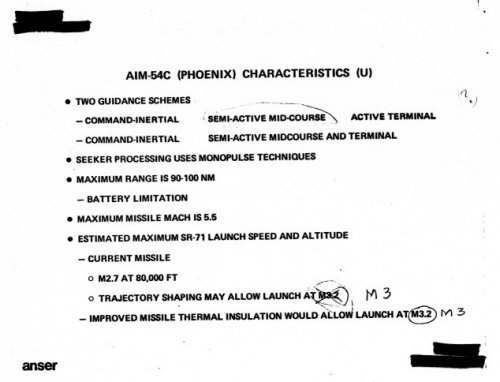

The second SR-71I proposal should still be available at the bottom of page 2 as a PDF (image files for that one are TIFs).

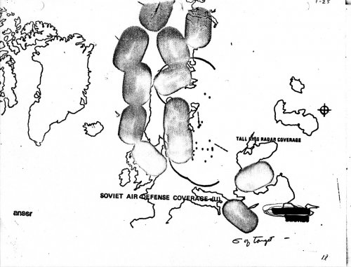

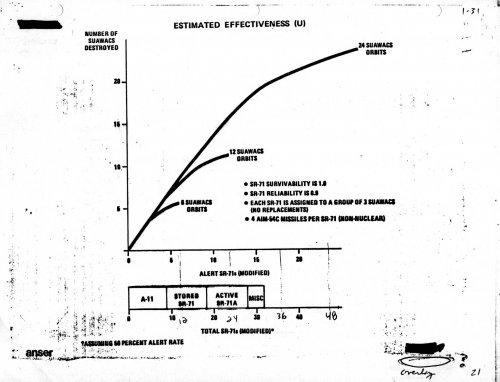

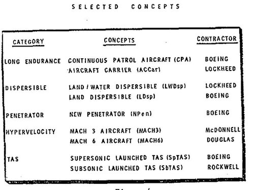

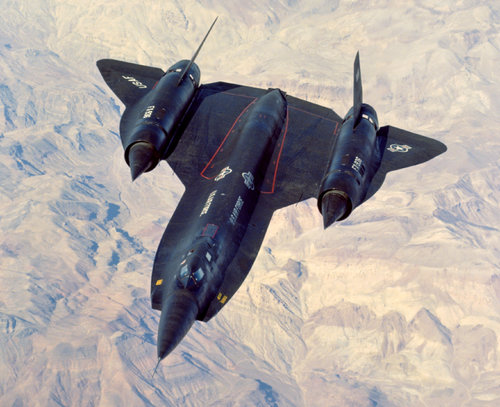

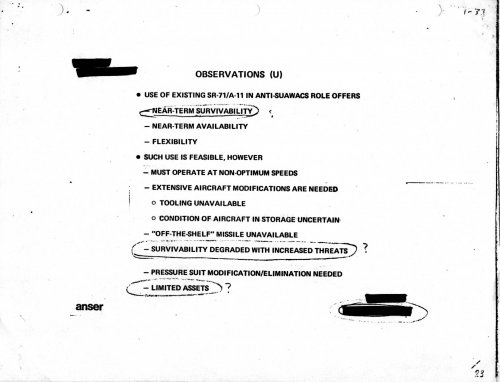

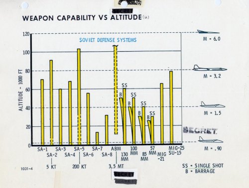

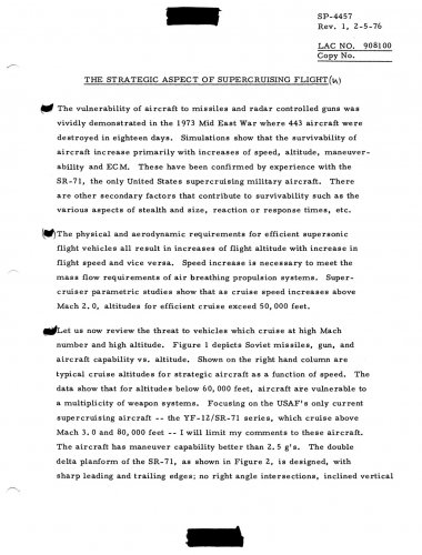

sublight is back said:

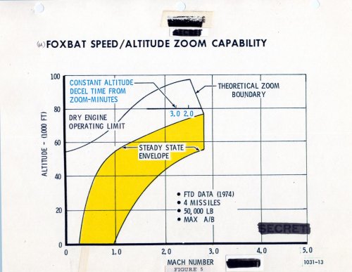

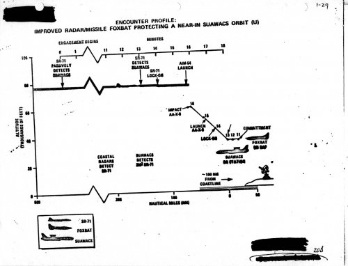

What is the aircraft in figure 1 that goes Mach 6 @ 120k feet?
The one that was flying way higher and and far faster than the SR71 as it was doing a sprint run across the USA would be my guess.
The crew mused iver the fact that their last high speed flight was indeed a cover for a classified airframe test.
What? :eek: Do you have anymore details on this? Which crew? Book? Interview?
Pretty sure it's just there for comparison purposes.
I doubt its notional of Ben Rich fantasy. He was definitely in a position to know otherwise.
Probably just notional.
But there were some studies. Anyone know what projects these models belong to?
https://crgis.ndc.nasa.gov/historic/1251_Models_M-P#Mach_6_Bomber
Figure 1 is almost certainly a notional concept intended to show a performance regime capable of entirely ignoring the ground-based SAM/AAA threat.
But not if the whole point of the presentation was an attempt to keep the SR71 platform relevant in the wake of the new Mach 6 program.

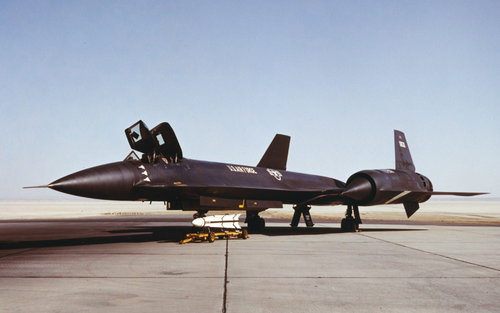

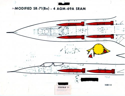

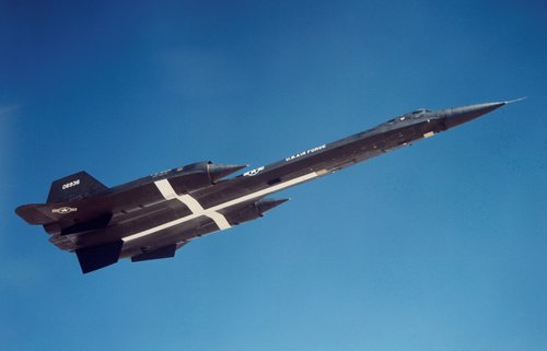

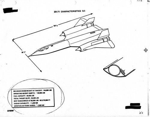

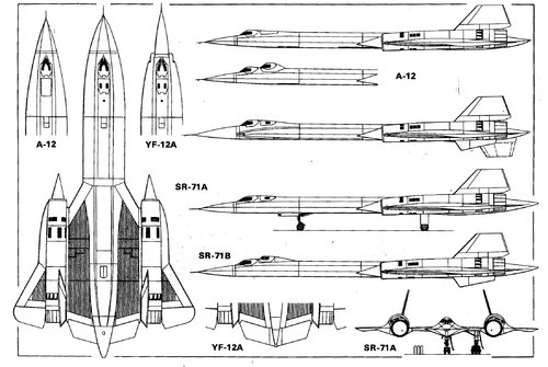

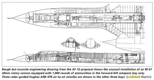

I seem to remember a post around here that detailed air force proposal to develop an SR-71 variant that was faster with longer range and more maneuverable. Lockheed came back saying that faster and longer range were feasible but more maneuverability would be very difficult.
Hi! F-12B.
And YF-12A 1/12 scale wind tunnel test model.
Thanks to Blackkite for posting the SR-71 or R-12. F-12B and YF-12A.jpg.
In looking at this, the top image appears to be the A-12 as it only appears to have One Seat.
Does anybody know of higher resolution images that were used in this composite?
Thanks in Advance

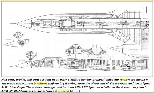

Were there ever any plans to modernize/overhaul the SR-71 fleet before they were retired?
(was quietly perusing that thread, and then...)
Whaaaaaaaaaaat da fraaaack ? are you freakkin' kidding me ?
This blew my mind and made my day. You know what ?

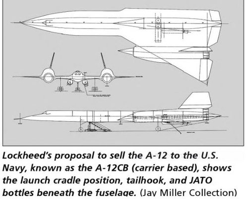

Everybody knows about those videos of U-2s landing on a carrier.
Every time I watched them, I thought "easy, the U-2 is a subsonic, straight-wing, glider look alike. Imagine, if they tried the same trick with a Blackbird: a carrierborne SR-71, ha ha ha..."
Well... they proposed it.
Damn you, Lockheed ! o_O o_O o_O o_O o_O

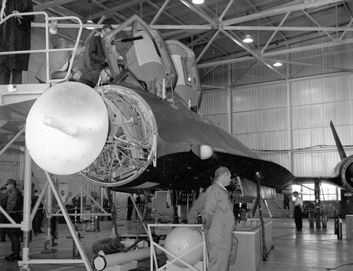

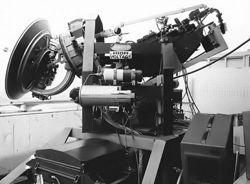

Hi!
https://modernwartech.blog.hu/2015/...a_kepes_elfogovadaszunk_3_lepesben_2_resz_146
"Excellent but complex weapon system for complex interceptors
The AN/ASG-18 was the first coherent pulse-Doppler radar in the United States. According to the specifications, the carrier, which flew 21 km, was able to conduct missiles from zero to 30.5 km, i.e. it had a full downward view. (It is much more difficult to detect targets flying against the background of the earth's surface, as radio waves reflecting from the ground are quite disruptive to the radar.) It detected a B-47 target from 185 km and was able to track one target at a time according to the computing capacity of the time (i.e. its trajectory is constantly calculated so that it can be launched with a rocket). The 41-unit radar was 950 kg and naturally reached a high range with high radiated energy, so it was cooled liquid. The infrared sensors were parallel to it. The antenna was 101.6 cm in diameter, so it was huge in size. Navigation and fire control were provided by a digital computer, while the manoeuvres needed to get into the firing position were provided by an analog computer. It was a huge step forward for the radar to be able to self-check both on the ground, both in the air and in the air, and to detect inappropriate components. This was a very important feature compared to the previous MX-1179. In principle, during the last pre-missile test, if the radar is dropped by an error signal, it will be sent to SAGE's command centres as an encrypted message and therefore immediate action can be taken to replace the fighter jet. According to the statistics from experience, the delicate electronic units were exchanged individually before their expected time of failure, so that the fighter on the take-off had to always be in working order at all times. This, of course, meant a warehouse-like component base for the fleet of hundreds of machines in every municipal location."

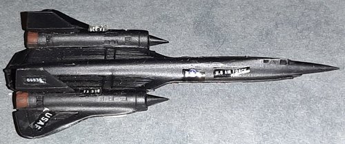

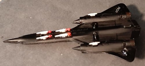

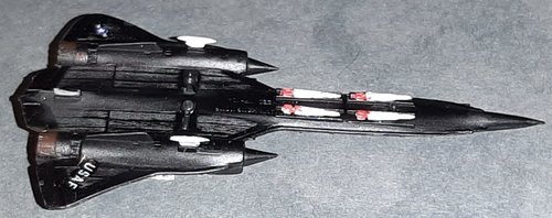

Back in the 1960s the American Toy Company Bachmann produced this 2 in long plastic toy YF12A..It even has missiles in the bay under the fuselage but Ebay did not show them
could you show us the missiles? I had one years ago, but the tailfins broke
Yeeeeaaaaahhh, this has got "Sure we can make the F104 an efficient ground attack aircraft" written all over it.
I would think it is far worse. Sticking iron bombs on an interceptor was pretty straightforward business - add some bomb racks here and there, tweak the sight a little, and here yah go. As long as there are 30 mm guns of course, to straff and anihilate anything standing...
The Israelis who were not rich enough to get Mirage III-E (and were screwed of their Mirage V later) did exactly that with their Mirage III-C - and we all know how well that worked against the Arabs a day of June 1967.
But throwing a SR-71 off a carrier with JATO bottles... ??!! really ?
I could see it as a special purpose application, like the WHALE TAIL U-2Gs, to get an A-12 into position for a sortie that wouldn't be otherwise possible.As a routinely embarked naval aircraft, in any role, not so much. It would be interesting to know exactly what Lockheed were proposing.
I agree with this. As suggested upthread, closer from the JATO-Neptune-nuclear bombers. A one-shot, silver bullet but jury-rigged contraption.
But really, risking an A-12 and a supercarrier this way... :eek:
