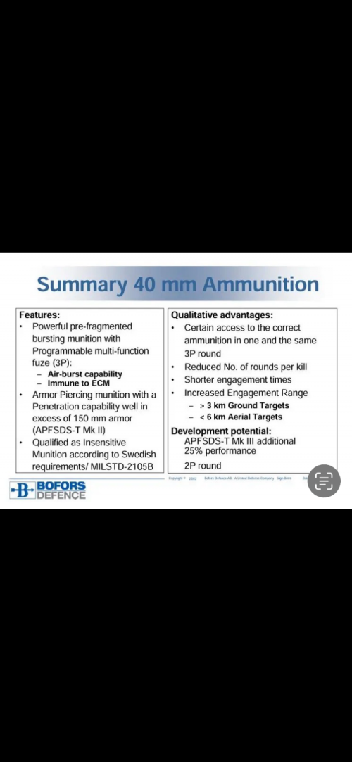

The bofors 40 and 57mm guns can penetrate more than 6” of armor…not sure when that capability will be necessary though lol
Well I can tell you that the 57mm does in fact have that capability. As per former Weps on a freedom.Naval 40mm Bofors guns don't use the APFSDS-Tround cited here. That round was developed for antiarmor use in the CV9040 IFV.
It's not clear whether there even is an equivalent round for 57mm Bofors, since there are no current ground applications of that gun. There was apparently some sort of APDS or APFSDS for the German Begleitpanzer support tank (if War Thunder players are any guide) but it very likely is not available today.

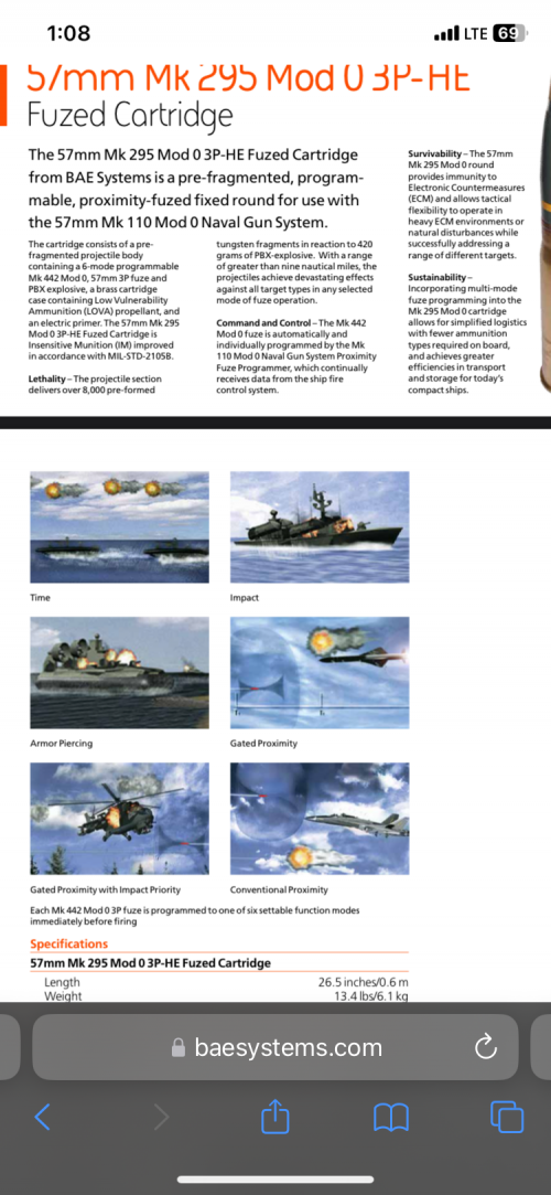

3P has an armor penetration mode…it’s literally on BAE’s page for the 3P ammunition. The amount of penetration just isn’t listedYour source is telling sea stories, I suspect. The Navy's budget docs talk about procurement of the 4G bolt guided round (ALaMO), prox-fuzed HE (the 3P round), an HE-PD (point-detonating) round, TP (training), and dummy rounds. No sabot.
Maybe the Russian VLS is a bit more heavily protected, but I don’t think that’s necessary for ours.VLS stack?
You can believe it or not, no skin off my back.The value in the slide you uploaded and called out is specifically for a tungsten AP sabot round. It has zero relevance to 3P penetration.
A 57mm 3P round isn't going to get through 6 inches of RHA, even in AP mode. The original 57mm SAP would penetrate about 2 cm; 3P maybe a bit more but absolutely not 15 cm.
