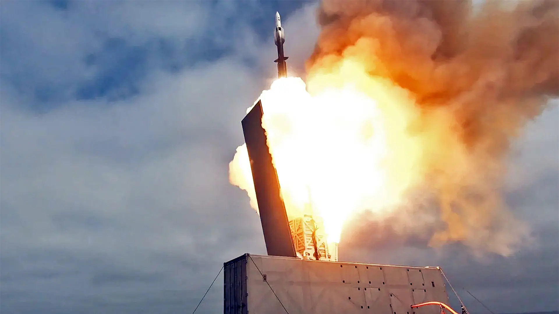

Other than a one or two off emergency mission, it’s a pretty bad addition to LCSes.![]()
Littoral Combat Ships To Sail With Mk70 Vertical Launchers Strapped To Their Decks
The LCS is notorious for lacking firepower and the modular launcher could help with correcting that, but there are tradeoffs in doing so.www.twz.com
Fouling LCS-2 flight decks…after touting those same flight decks as a rare tangible LCS virtue for 15 years…?
- Will a subset of LCS-2s not be equipped as MCM vessels due to the inability to operate MH-60S? I thought we needed a bunch of minesweepers?
There are UAVs that use lasers to detect mines in the modules, but depending on size they may still be able to take off and land on what remains available of the flight deck.Fouling LCS-2 flight decks…after touting those same flight decks as a rare tangible LCS virtue for 15 years…?
- In the spirit of ‘distributed lethality,’ will the Navy install Tomahawk control systems / stations and employ a subset of LCS-2s to attack the Chinese South China Sea island bases w/ TLAMs (& shoot PLAN warships w/ NSMs, & later AShM Tomahawks)? Is it fair to assume that sensors beginning the kill chains will come from, or mount on, non-LCS platforms, especially since the Navy retired its MQ-8Cs after only a few years in-service?
- Will the Navy update the LCS-2 CMS to enable initial targeting for SM-2/SM-6? Is it customary for AAW missiles outrange the radar? What will standard-missile equipped LCS-2s be escorting or protecting?
- If the Navy wants the LCS-2 to have AAW capability, why didn’t it develop a smaller container for ESSMs that might not prohibit flight operations? Could someone bolt Mk.56 launchers to the deck-edge just behind the hangar, and preserve the ability to launch & recover MH-60R/S?

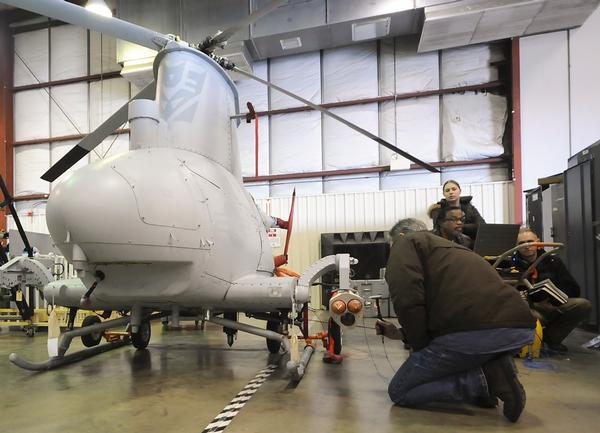

Not all that much once you packed the cabin with all the computers and radios to run the thing. Same problem as Kiowa Warrior.The -8C was an unmanned Kiowa; it had plenty of payload. It was supposed to be armed with APKWS at least, but the Navy got cold feet and opted to use it strictly for ISR type tasks.
Apparently Northrop Grumman believed they had the ability to carry a bunch of sonobouys at the very least, which means without those they could also carry an MG of some sort with ammo.Not all that much once you packed the cabin with all the computers and radios to run the thing. Same problem as Kiowa Warrior.
The -8B only had about 600lbs lifting capacity. NG tries to say that the -8C has 2900lbs capacity, but the base Bell 407 has ~2350lbs capacity with no pax (5) or crew (2), so about 1000lbs over the pax+crew weight.
The current sea-search radars weigh in about 600lbs, so that plus an EOIR eyeball pretty much wipes out 1000lbs of load in the -8C.
Unless they’re proposing a whole new type of sonobuoy the lightest type is around 35lbs.
35x12 is 420lbs, and I think 12 is conservative estimate based on their rendering which appears to have 48.
Not sure where you get 4 and 6 kgThose Ultra Sonobuoy mission pods are sized for G or F-type buoys, which are 1/3 or 1/4 size, weighing between 4 and 6 kilograms. A single SMP-24 pod carries an expendable payload of 24 buoys, so around 120-150 kg. Plus the weight of the pod and processor. That's easily 200kg a side on an MQ-8C.
"Each SDS pod can carry and dispense up to 10 A-size sonobuoys or up to 20 G-size sonobuoys"Not sure where you get 4 and 6 kg
The G class each weigh roughly 23lbs based on this.
Pod 290lbs, full pod(20 bouys) weighs 750lbs.
750-290=460 460/20=23 almost twice the heaviest weight you claimed.
The article I linked says it uses G"Each SDS pod can carry and dispense up to 10 A-size sonobuoys or up to 20 G-size sonobuoys"
You're assuming two G-size weigh the same as one A-size, which doesn't necessarily follow.

Most of the G-type buoys are around 5.1-5.6 kg. There's one weird outlier of an active G-type at 7.8 kg.
F-types are a bit shorter than G types (they are A/4, while Gs are A/3) so they should end up a bit lighter.
Your maths is wrong. They explicitly say the pod can take 10 A or 20 G, you are assuming the weight is for the pod with 20 Gs, when it's clearly for the pod with 10 As if you bother to go check the weight of a G from easily available sources you've been pointed at twice.I’m just reporting the numbers and the claims in their article.
The math says at 20 per pod, they weigh 23lbs a piece.
