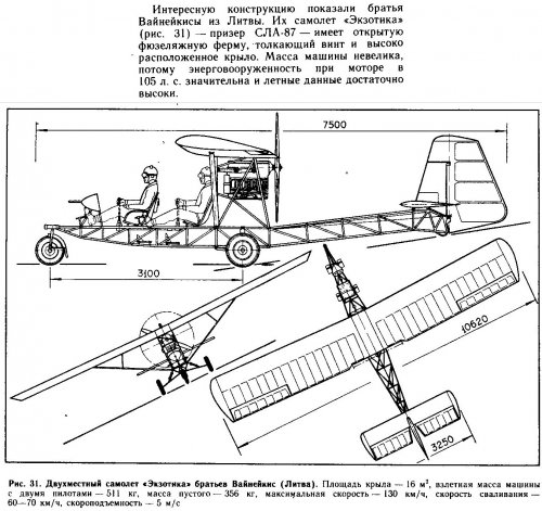

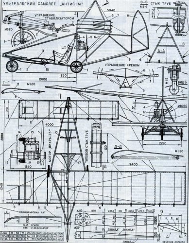

I am by no means conversant with the aviation of Baltic countries, but I have a handful of Lithuanian aircraft on my HD, all from the 1980s... perhaps these may be of interest to some? Maybe some more light could be shed upon them?
  • Kyansgayl Aushra
  • Kizhis Varnye
  • Konchus Antis
  • Vaineikis Exzotica

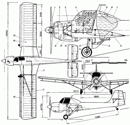

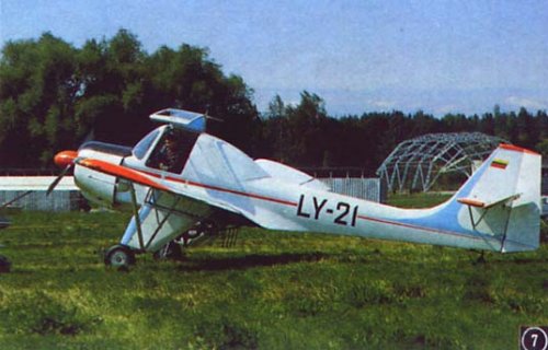

I have the two seat agricultural aeroplane Kyansgayl Aushra recorded as the Kensgaila VK-8 Aushza or Austa (Sunrise).
Design of this two seat agricultural homebuilt was undertaken by Vladas Kensgaila in Lithuania. Work began in 1987 and the construction of the prototype began in 1989 and later that year the VK-8 appeared at the 5th National Homebuilt Convention held at Riga. At that time it was the largest homebuilt in the Soviet Union and carried the Lithuanian registration LY-21. The designer was hopeful of series production.
It was an aircraft designed for agricultural, training and transport roles, and conformed to experimental regulations. It was
a strut-braced low-wing monoplane, of composite construction. It had three axis control plus flaps and leading edge slats. Spray booms were carried below the wing trailing edges ahead of the ailerons. The undercarriage was not retractable and the main wheels were fitted with trouser fairings and brakes.
It had a high raised cockpit, slightly forward of the wing which gave a good view. A 800 litre container was carried behind the cockpit and the VK-8 could spray a swathe of 30 metres width. The Vedeneyev 360 hp radial engine drove a two bladed variable pitch wooden propeller with reduction gearing. The airscrew diameter was 2.75 m. Either the M-14P or M-14PS could be fitted.
Designed as a potential An-2 replacement, only one was built. It fully complied to FAR 23 standards. Alternative versions were for patrol, photography and fire fighting roles.
General Characteristics
ENGINE: 1 x Vedeneyev M-14P Radial (268kW)
WING SPAN: 14.85 m
LENGTH: 9.57 m
HEIGHT: 3.74 m
WING AREA: 28.4 sq m
EMPTY WEIGHT: 1,140 kgs
MAXIMUM TAKE OFF WEIGHT: 2,200 kgs
MAXIMUM FUEL: 180 litres
MAXIMUM PAYLOAD: 1,000 kgs
ACCOMODATION: 2
CRUISING SPEED: 180 km/ph
ECONOMIC CRUISING SPEED: 160 km/ph
MAXIMUM SPEED: 220 km/ph
STALL SPEED: 70 km/ph
RANGE: 450 kms
ENDURANCE: 3 hours 40 minutes
SERVICE CEILING: 4,000 m
TAKE-OFF RUN: 60 m
LANDING RUN: 40 m
FIRST FLIGHT: 1989
RATE OF CLIMB: 300 m per minute
G STRESS: +3.5 & -2.0
AIRSCREW DIAMETER: 2.75 m
Sources
Janes All The Worlds Aircraft 1991-92 (Edited by J.W.R. Taylor)
Air International October 1996 [Page 251]

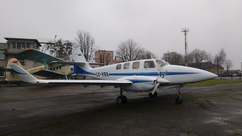

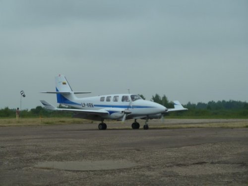

Following on from the post from Skyblazer and my reply about the VK-8, here is another offering from Vladas Kensgaila in Lithuania.
Kensgaila VK-9 (Utility Transport)
Lithuanian Vladas Kensgaila began work on the prototype VK-9 in 1994. Compared to contemporary aircraft like the Tu-24, it looked very modern with a streamlined fuselage, winglets and a retractable tricycle landing gear. Much of the aeroplanes structure was made of class fibre plastic composite material. It was a low wing monoplane and was built at the Kensgaila Aircraft Plant (factory?) at the former Lithuanian Air National Guard field at Stetiskiai near Paneveyzs.
ENGINE: 1 x M-14PS (360 hp)
WING SPAN: 14.0 m
LENGTH: 10.24 m
HEIGHT: 3.94 m
WING AREA: 26 sq m
EMPTY WEIGHT: 1,200 kgs
MAXIMUM TAKE OFF WEIGHT: 2,400 kgs
ACCOMODATION: 6 passengers
PERFORMANCE -
CRUISING SPEED: 350 km/ph
RANGE: 2,000 kms with 45 minutes reserve
TAKE-OFF RUN: 200 m
LANDING RUN: 250 m
FIRST FLIGHT: 1996
PRODUCTION: 1
G-LIMITS: +5 / -2.5
Hi Cy-27 :)
Thank you for your excellent and detailed post. I am somewhat puzzled on the VK-9 as I always though this was a "Cessna"" like twin with two Lycoming O-540s. Please see attached photo of LY-VRK.
Where did I go wrong?

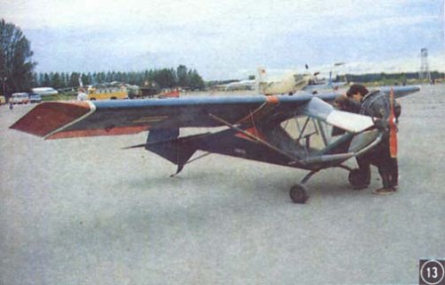

To add to the very interesting thread on Mr. V. Kensgailis, please find photos of the VK-4 homebuilt and the VK-6 Lituanica.
The VK-4 Žhuvédra was completed in 1961 and had a 22hp Dnepr M-72 motorcycle engine. The red star on the tail was common due to Lithuania`s Soviet history. The VK-6 was designed/built in co-operation with Mr.

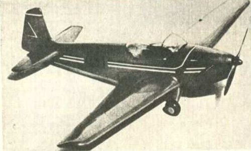

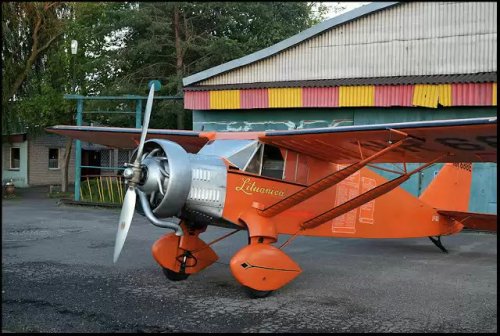

S.Noreika and an externally very accurate replica of the Bellanca Model CH (I-65, CH-300) used in 1933 by Lithuanian pilots Steponas Darius (Darių) and Stasys Girėnas (Girėną) for a 1933 (July 15-17) record breaking flight from New York to Lithuania. Sadly the non-stop flight ended in a fatal crash in Germany (now Poland), killing both aviators. The Lituanica was first flown in 1983 and had an Ivchenko M-14R radial engine.

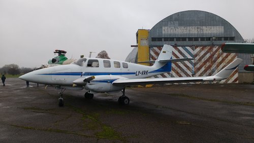

-- Vladas Kensgaila crash-landed LY-VRK, 04 June 2016

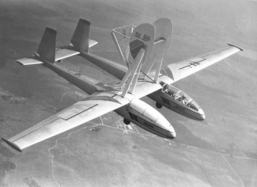

I guess this is the VK-7 (?). Hope that anyone can share a photo of the VK-5 motorized L-13 Blanik.

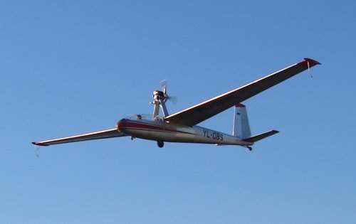

Is this the VK.5 ?
Maveric said:
Is this the VK.5 ?
I don't think so. [YL-DBS] is a Latvian, not Lithuanian registration (otherwise it would start with LY-).
Registers have this as a 1977 Blanik L-13 (c/n 027027), in fact an L-13M (the motorized version).
Aka Sportinë Aviacija SL-2P test rig for airfoils. It is mentioned in the Let-13 Blanik Wiki page: https://en.wikipedia.org/wiki/LET_L-13_Blan%C3%ADk

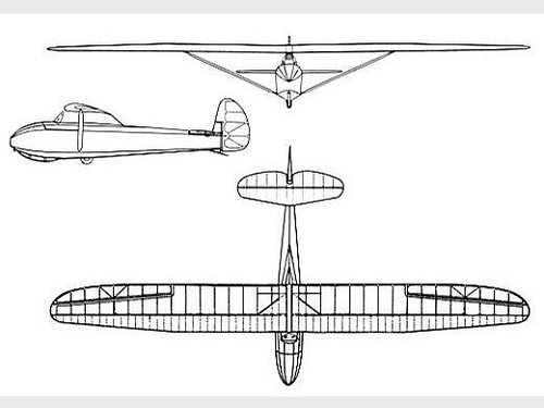

Name: Kaunas Polytechnic Institute KPI-1
Purpose: Training Glider
Description: Encouraged by his first achievements, A. Kuzmickas designed his first dedicated training glider, the pioneer of the great KPI series gliders the KPI-1. The Institute was a continued support for the gliders of the Antanas Kuzmickas.
The KPI-1 was lifted into the air by a self-propelled tow truck. This glider was not rebuilt after an accident.
Year: 1954
In the name of the constructor: A. Kuzmickas
Name: Kaunas Polytechnic Institute KPI-2
Description: When the KPI-1 was not rebuilt after its accident the next design, the KPI-2, proved to be a failure.
Year: 1954

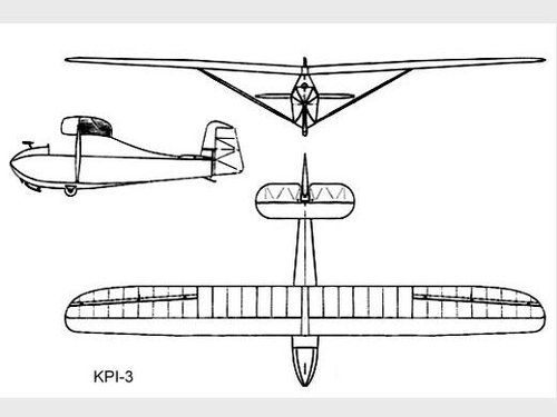

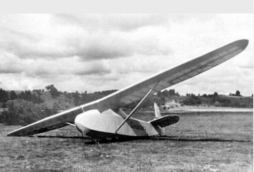

Name: Kaunas Polytechnic Institute KPI-3 "Gintaras"(Amber)
Description: The KP-3 was one of the best works of an aircraft designer. The sleek KPI-3 Gintaras was characterized by agility, climbed well, and rose to a height of up to 1,000 metres above the starting point in Kulautuva. It served a long time for the gliders of the institute and it was as if specially constructed for the specific conditions found at Kulautuva.
Year: 1955
Wing length: 9.20 m
Wing area: 9.2 sq m
Profile: 10.8
Wing load: 19.9 kg/m2
Empty weight: 85 kg
Loaded weight: 175 kg
Aerodynamic quality: 18.5
Sink rate: 1.16 m/sec

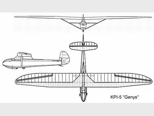

Name: Kaunas Polytechnic Institute KPI-5 "Genys" (Woodpecker)
Description: In 1958 near Prienai, Kuzmickas saw his new glider KPI-5 in front of the Soviet state commission for evaluation. It was deemed a high-class device with good flight characteristics, aerodynamic shapes, designed together with KPI graduate engineer S. Jonušonis , who performed a large part of aerodynamic and endurance calculations, worked a lot with the project drawings.
Kuzmickas constructed the fuselage and the tail, with Janušonis working on the wings. The fuselage of the new glider was the same shape as KPI-4, only longer and with a glass cover, the wings were springy, but longer (12 m) and wider (1.2 m). The profiles were also different an R-III with a transition at the ends for better quality at higher glide speeds.
The construction of KPI-5 was disrupted when Kuzmickas in March 1958 was transferred to Vilnius as the Chief Engineer of the Grinding Machine Factory. This was the last fruit of A. Kuzmickas' constructive activity, as a number of excellent Soviet and foreign construction apparatus appeared in the Republic.
Year: 1958
In the name of the constructor: A. Kuzmickas & S Janušonis
Wing length: 12.0 m
Wing area: 13.2 sq m
Profile: 12.0
Wing load: 16.5 kg/m2
Empty weight: 128 kg
Operating weight: 213 kg
Aerodynamic quality: 20
Sink rate: O.85 m/sec
Wing Profile: R-III

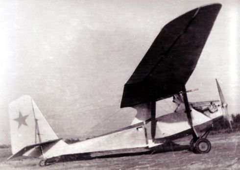

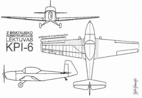

Name: Kaunas Polytechnic Institute KPI-6
Purpose: Light aircraft
Description: In 1959 saw the Kaunas Polytechnic Institute KPI-6 powered aeroplane make an appearance. Led by Zenomas Brazauskas and Juozas Zujus. Later Zujus (1930-2020) was one of the few Lithuanians to teach at the Moscow Aviation Institute.
Year: 1959
In the name of the constructor: Z.Brazauskas & J.Zujus
Wing length: 9.0 m
Fuselage length: 6.9 m
Wing area: 12.4 sq m
Ceiling: 3000 m
Speed: 158 km/h
Landing speed: 69 km/h

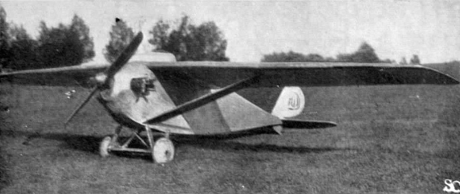

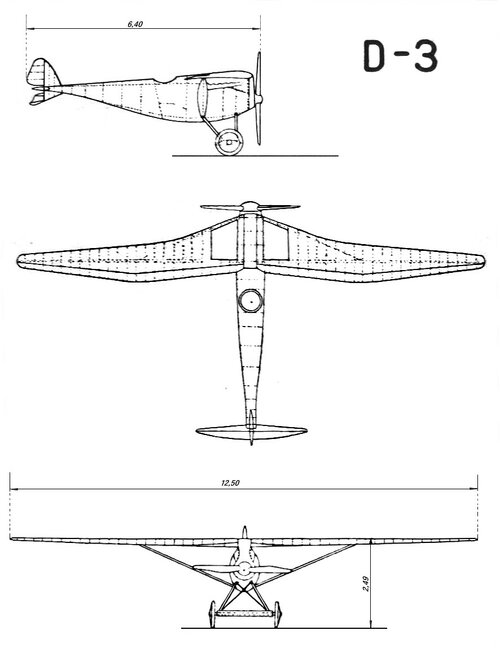

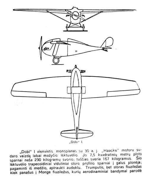

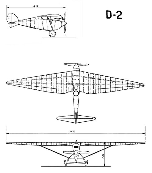

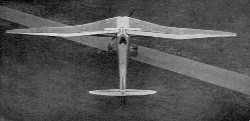

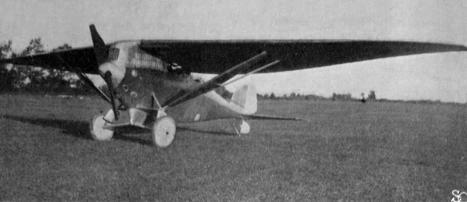

The little-known monoplanes of engineer J. Dobkevičius during the 1920s (three-view arrangements in attachments):
"Dobi" I
"Dobi" II
"Dobi" III
