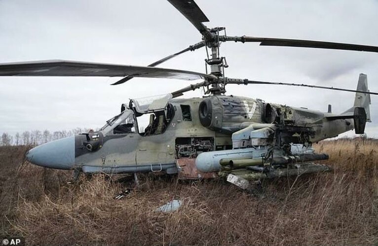

Certainly the Ka52 appears more durable than its predecessors. Of the four I have seen in disrepair, two made it to the ground intact, one went into a river (with at least one aircrew successfully using the ejection system it appears) and one appears to have made it to the ground intact before burning.
The attached picture demonstrates the durability as it is clear that the pictured aircraft was hit by a MANPAD in the wing tip ASE pod. Note the significant overpressure damage to the intermediate section of the tail boom. Rotor system has had better days as well.
