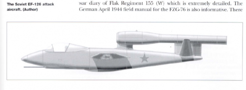

and may be it took the "EF' designation.
here is the Junkers EF.126 in Soviet development.

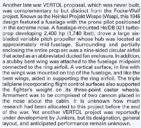

A big Surprise in my Files,until get the source,
Junkers had a project for VTOL fighter,rather than Focke-Wulf Triebflugel and Heinkel Wespe & Lerche,but no
more details are known.
Junkers had a Project for VTOL fighter,rather than Focke-Wulf Triebflugel and Heinkel Wespe & Lerche,but no more details are known.
No my dear Jemiba,
the Junkers VTOL fighter Project was from 1944/1945,and no details available about it,
but EF 50 was from 1941/1942,and this Project was not related to EF 127 ?.

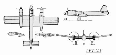

Also from my files,
the Junkers intended to fit Ju-88 & Ju-188 with two addition turbojet engines,for each,installed under the
inner wings,probably looks like this BV P.203 in configuration.
http://www.luft46.com/bv/bvp203.html
Junkers had a project for VTOL fighter,rather than Focke-Wulf Triebflugel and Heinkel Wespe & Lerche,but no more details are known.
The source;
Jet Planes of the Third Reich - The Secret Projects-volume one

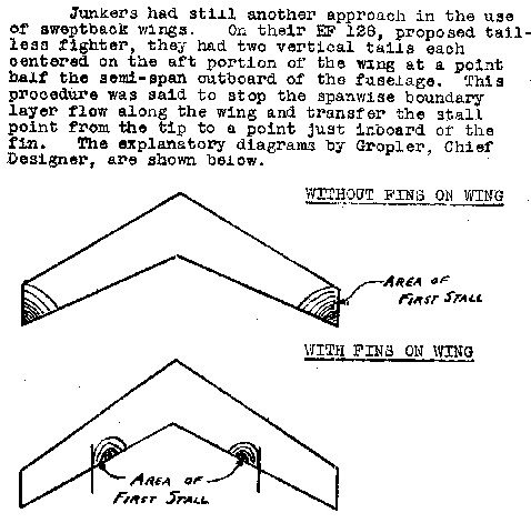

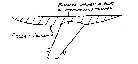

First image is explaining the idea behind the 128s tails, essential fences to stop tip stall

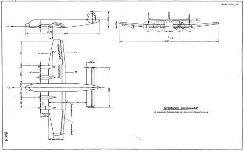

The second image is a drawing of a junkers windtunnel model that is almost area ruling. It was said to increase the critical Mach from .75 to. 78

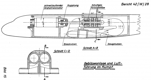

DVL testing carried out at the behest of Junkers.
Pretty extreme example of boundary layer control for the time.

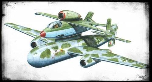

Hi
Here a Junkers patent
It shows the EF.101 carrier aircraft with an unknown fighter/bomber.
Patent Nr. DE911457
Title: Mutterflugzeug mit selbstständig fliegendem Tochterflugzeug
Year: 1941
https://depatisnet.dpma.de/DepatisNet/depatisnet?action=einsteiger
  • DE000000911457B_all_pages.pdf

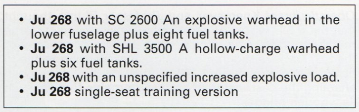

Also I found this,Ju-268 Mistel.
http://hugojunkers.bplaced.net/junkers-ju268-mistel-v.html

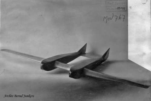

It looks even older than "entwürf für ein Doppel-Flugboot MIT propeller-fernantrieb", dated 1928. The RLM competition ending with the approval of the BV 138 started at 1933/1934.
OK my dear Wurger,
but the problem is that site is closed or changed the title,maybe someone has a
useful Info.

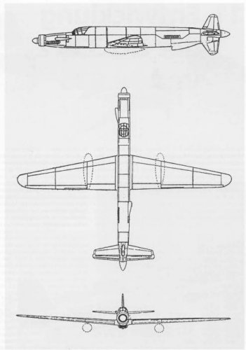

junkers 435,any more information on him,it's come from the manfred griehl book on the dornier do 335,435,635:

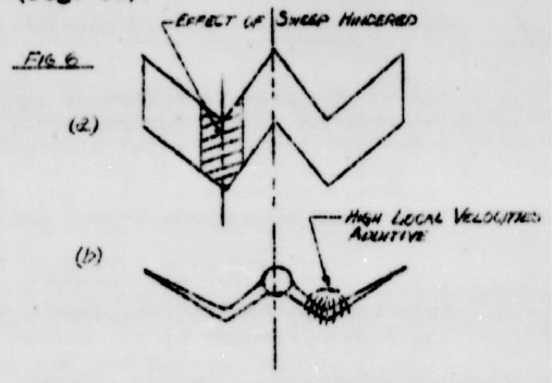

Well, yes, he studied them, and as a result, he says in page seven, that W or N planforms with high sweep angles are
unsuited for high speed. So, the shown wing design certainly cannot be regarded as a project, but as an example, why
such planforms shouldn't be used.

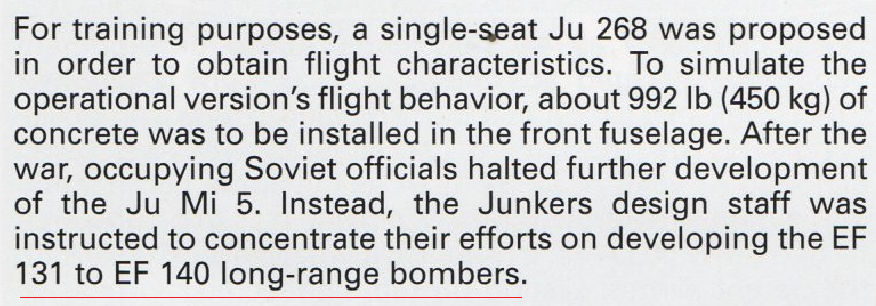

From, Jet Planes of the Third Reich - The Secret Projects-volume two,

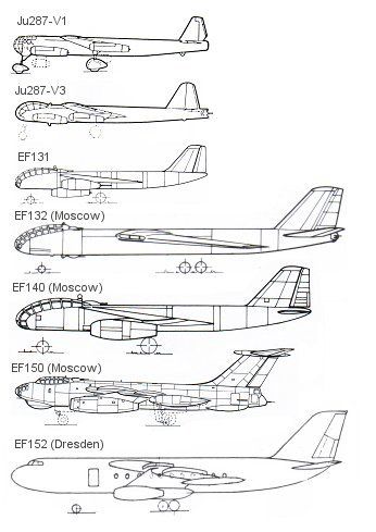

a strange Info,from EF-131 to EF-140 ?.

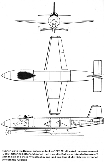

From, Rocker Fighter,
the Junkers EF.127 in details.

the Junkers EF.152 was a Bomber project,lated developed as GDR 152 civil
aircraft ?!.
Dear Zizi,
it was designed as Bomber project at first,then redesigned as airliner later.
Both of them (EF.150 & EF.152) were a bomber designs at first.
What is your source?
That's the problem,I will try to remember.
Let's stay with the known sources until then, and let the 152 be an airliner.
I am sure about it,just wait.
