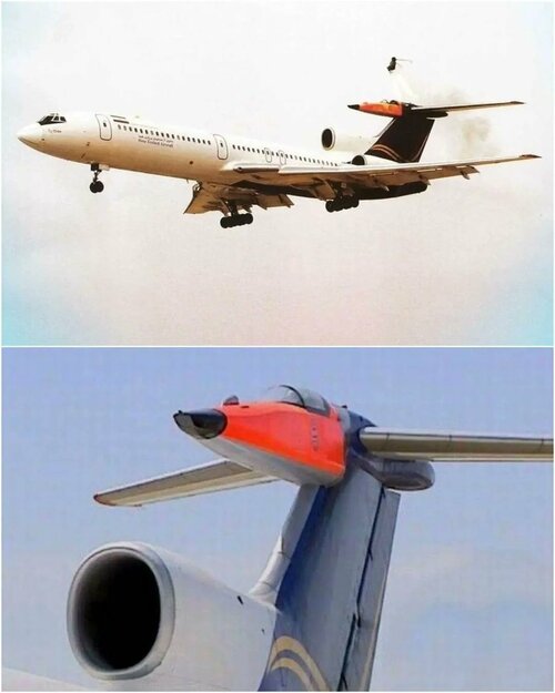

the Iran tested ejection seats in unique way
a F-5 cockpit bolted on Tu-154M
Source X https://x.com/timfarmer
