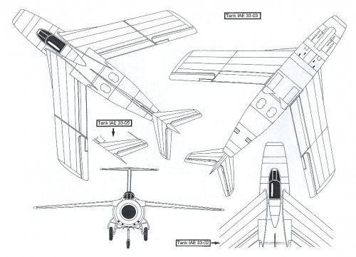

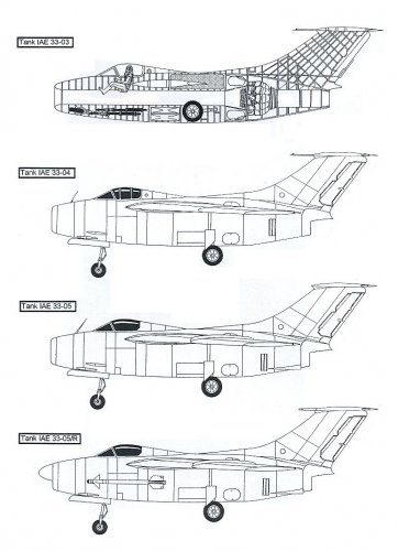

I think that Reimar Horten was also involved in the development of the Pulqui II's experimental glider when he arrived in Argentina, before switching back to his flying-wing designs (IAe-34, 37, 38, 41, 48, Pierniferos...).
Tank's Pulqui-II,
if brought to the stage of production could have been measured with their natural counterparts MiG-15, F-86 Sabre, There were no shortage of potentials Buyers outside the major alliances (USA-CCCP); The Spain of General Franco (friend of Argentina) needed replacements for their old fighters; There were some who need to begins to shoot right away, like the Arab countries or........... the explosive Indian sub-continent, of the time.
These could have been possible colors of the "Export" Pulqui-II.

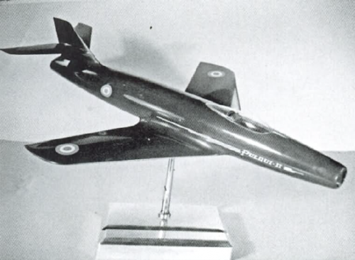

It seems to me to eat questions on a combination of the channel of an air inlet and a cabin, feet of the pilot couldn't is in an air stream, whether not so?
Whether saw you these photos
http://www.mincyt.cba.gov.ar/site/fabricamilitar/images/fotos/foto231z.jpg
http://www.mincyt.cba.gov.ar/site/fabricamilitar/images/fotos/foto230z.jpg
here:
http://www.mincyt.cba.gov.ar/site/fabricamilitar/fotos/fotos009.html
Judging by a photo the nasal part has slightly other rivets of a line!
According to the panel lines can be others?
here:

Clearly the air flow in the case of the Tank's Pulqui-II, goes to the sides of the cabin and not below it, with better aerodynamics.
The configuration of air flow of Tank's Pulqui-II is best fit, than that used in the Ta.183 Huckebein which in turn probably comes from the Saab Tunnan; These two have more frontal area, and therefore more aerodynamic resistance.

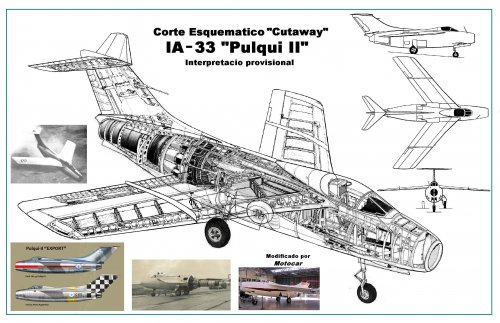

Ready...!
Cutaway IA-33 Pulqui II, modified by Motocar in free interpretation

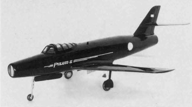

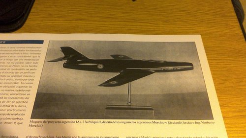

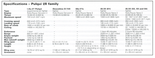

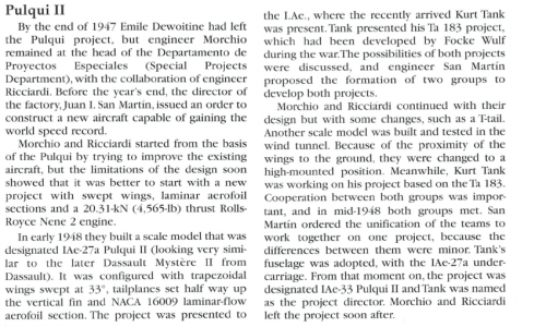

In the International Air Power Review Vol. 25 there is an article on Argentinian jet projects. Amongst others it briefly mentions what was designated IAe-27a Pulqui II and what was an intermediate phase of development between IAe-27 Pulqui I by Dewoitine and IAe-33 Pulqui II by Tank. Interestingly IAe-27a was designed by Argentinian (or Italian) engineers who had previously worked with Dewoitine on IAe-27.
Here you have cutouts from the IAPR article containing a photo of IAe-27a's modell as well as what the article says on the project and a table with specifications of all members of the Pulqui family, incl. the IAe-27a.

What the IAPR article says may be understood that original Pulqui II was IAe-27a. After Kurt Tank took over the design the Pulqui II designation was retained but the numerical one was changed from '27a' to '33'.
So apparently there were two Pulqui IIs: IAe-27a and IAe-33.
Piotr

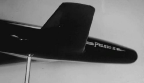

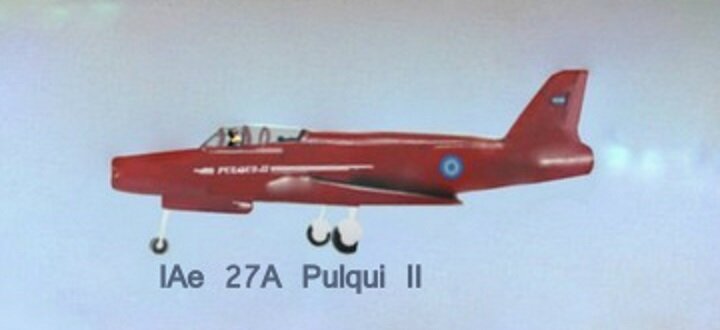

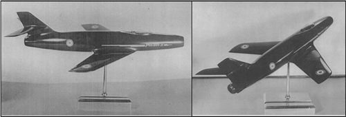

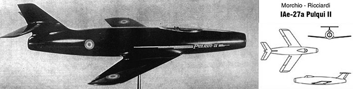

Here yet another photos (and a little drawing) of the IAe-27a model found somewhere on the Internet.
Piotr

Again on the IAe-27a.

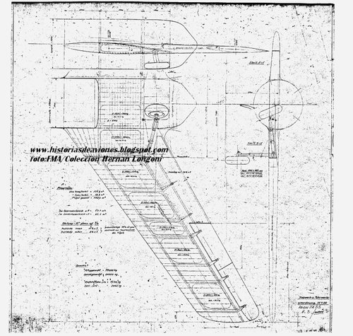

This time two photos of pages from an Argentinian magazine, in first of which you may see Mr Norberto Morchio in his home in Cordoba in 2012 beside models of 'the original design' of Pulqui II and Pulqui I and in the other - model of the IAe-27a (the same as above). Perhaps anyone can tell what magazine the photos come from?
In addition to that: from http://historiasdeaviones.blogspot.com/2013/11/la-genesis-de-las-flechas.html a drawing of the wing and undercarriage of the first prototype of IA-33 (you may see the "IA-33" in the right-lower corner of the drawing). It looks quite interesting as it clearly depict a mid-wing aircraft, not the high-wing (IA-33 as built). So I suspect that this was to be an intermediate phase of the design between Morchio-Ricciardi's design and that of Tank. Bearing in mind a remark from the article in the IAPR (https://www.secretprojects.co.uk/threads/argentinian-unbuilt-projects.211/post-347027) that "Tank's fuselage was adopted with the IAe-27a undercarriage", what may be seen in the drawing is the undercarriage arrangement from the Morchio-Ricciardi project. It may be also an indication that their project was in fact mid-wing rather than low-wing.
Btw does anybody have the drawing with higher resolution?
Piotr
