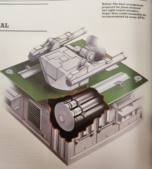

drawing of the Jason SAM :
http://s193.photobucket.com/user/davidtou/media/NavalizedROLAND-IISAMsystemJason_Fr.jpg.html

That's a great drawing nickd

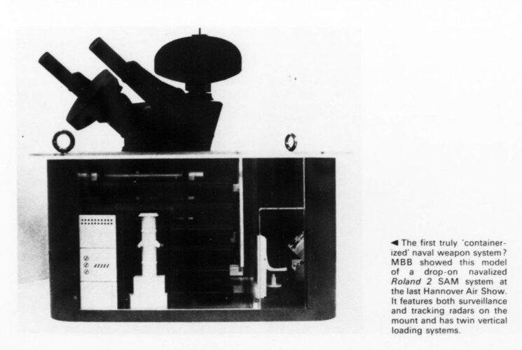

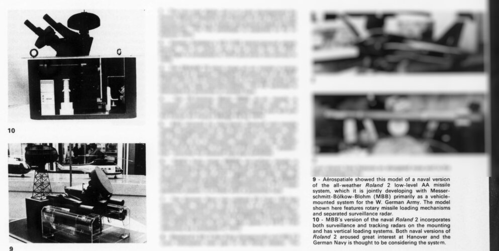

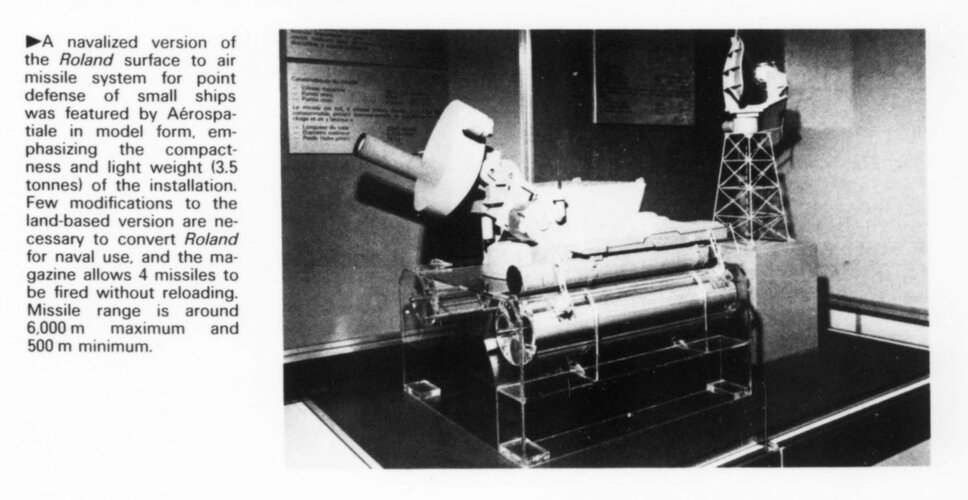

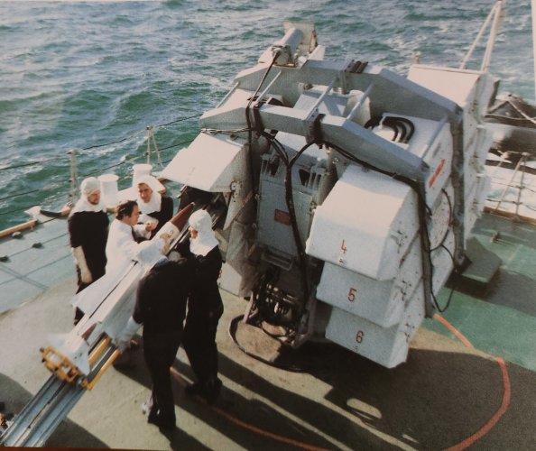

There were at least two different navalized Roland 2 proposals:
One from Aerospatiale using horizontal rotary magazines and a separated surveillance radar and one from MBB with vertical magazines and both tracking and surveillance radars on the mount.
