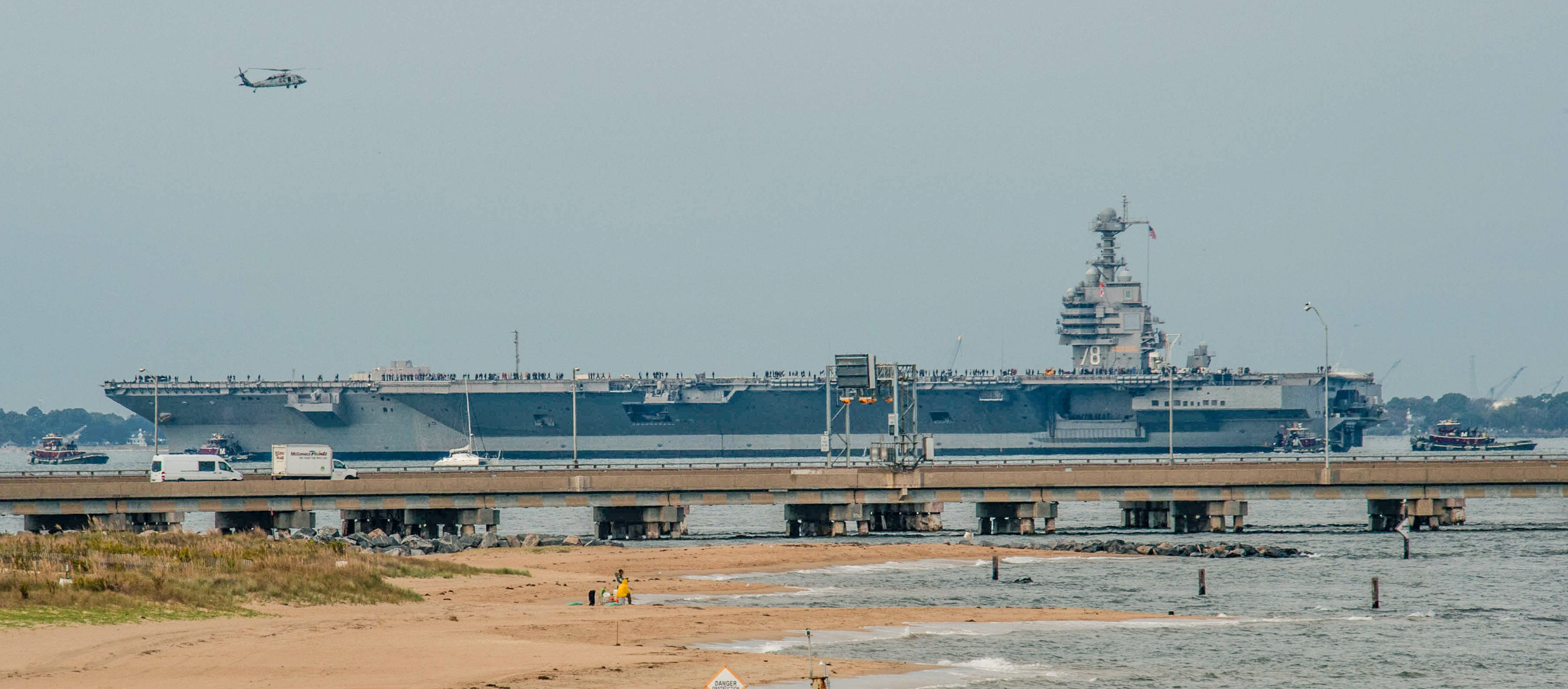

Carrier Ford Turns the Corner, Officials Say
BY MARK D. FARAM NAVY NEWS
On Board the USS Gerald R. Ford — The skipper of the world’s most technologically advanced aircraft carrier says the ship has”absolutely” turned the corner and is now ready to work towards full operational status.
After a 15-month stint back in the shipyard where the ship was built, most of its plethora of new technology is now up and running. The ship is now ready to begin advanced trials as the crew and the Navy will now learn how to take Ford’s high-tech gear to the next level and earn a spot in the deployment rotation.
Capt. John J. “Yank” Cummings, a career fighter pilot, took the helm of the aircraft carrier Gerald R. Ford just days after she ship arrived back at the Huntington Ingalls Newport News Shipyard last summer. Now, he’s says he and his crew are happy the ship is nearing a clean bill of health.
Naval Station, Norfolk — The aircraft carrier Gerald R. Ford prepares to pull into Pier 11 at Naval Station Norfolk, after a successful sea trials. (Mark D. Faram)
Cummings talked to media on boar the ship today, moments after their five-day at sea period ended as the ship tied up at Naval Station Norfolk’s Pier 11. While underway is that nearly all of her ship systems were put to the test, he said, and passed.
“Our readiness is leaps and bounds over where we were 15 months ago and a majority of the stuff that got worked on got fixed,” Cummings said.
“All the work we’ve done on the ship in the last 15 months all came to that point the engine room, the radar, all of our systems worked perfectly for the six days of high-speed tests — it’s a very proud moment.”
The past few day’s success is a shining moment in the development of the Navy’s next class of flattops that was designed to take naval aviation to the next level. The promise of the Ford-Class ships is more combat power arising from a totally redesigned flight deck where the Navy put to use NASCAR lessons learned, studying how teams quickly turn around cars during races.

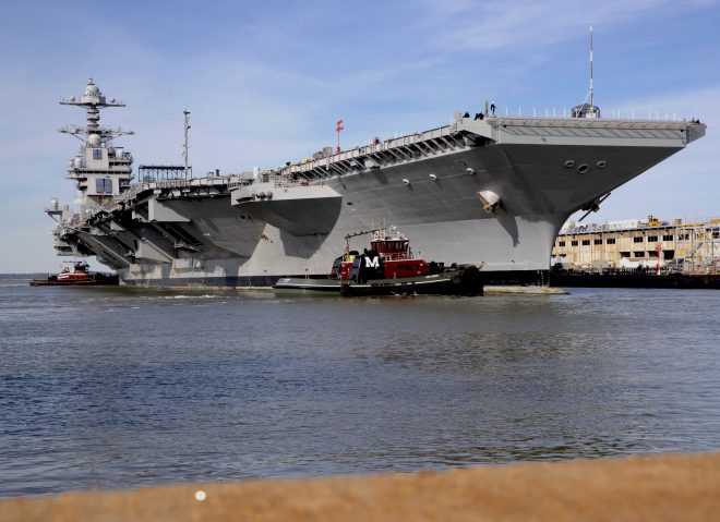

Naval Station, Norfolk — Sailors from the aircraft carrier Harry S. Truman prepare to help tie up the carrier Gerald R. Ford after a successful sea trials. (Mark D. Faram)
But before the Navy could start testing the reality of an expected 25-percent increase in the number of sorties the ship can fly in a day over what’s currently done on Nimitz-class carriers — the ship need to get all it’s parts and pieces up and running, first.
The past few days, according to to the Naval Sea Systems Command’s Rear Adm. Jim Downey, the man in charge of overseeing the building and maintenance of the Navy’s flattop fleet, have proven the ship has finally worked out most of the kinks that have plagued the ship since even before it was commissioned in July of 2017.
“The ship got underway right on schedule on Friday — conducted over 100 events over the the last few days and was very successful overall.”
Up and running, he said, is the ship’s propulsion system that was put through the full range of testing both forward and backwards and even high-speed turns. There was no sign of the thrust bearing issues that led to breakdowns before the latest overhaul started.
“Throttle control…performed very well, overall,” Downey said “All four [main turbine generators] were online all of those fixes were demonstrated at sea.”
The navigation system got a workout and combat systems, which features the ship’s dual-band radar worked fine through its initial runs where it “tracked multiple targets.”
