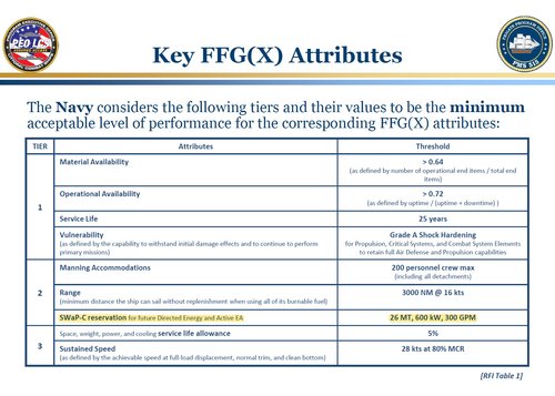

The FFG(X) designs were required to have weight margins and 600 kW of power reserve onboard for a future directed-energy-weapon so that coupled with the ALAMO is probably why the USN did not consider the LCSs surface warfare module.
