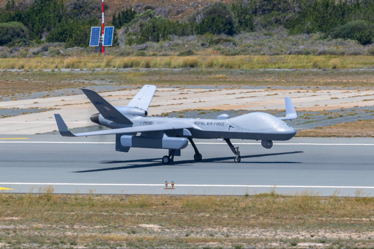

What are the chances of the UK buying the AEW pod for the Protector for use with the Royal Navy QE carriers to replace the Crowsnest Merlins?

For the STOL Reaper? I'd say really really good.What are the chances of the UK buying the AEW pod for the Protector for use with the Royal Navy QE carriers to replace the Crowsnest Merlins?

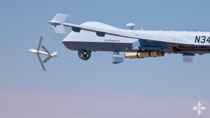

Fuel tank is standard for the Block 5 ER configuration. It's very rare to see one deployed without a tankAnother one downed,looks like it might be carrying an external tank under the wing.
