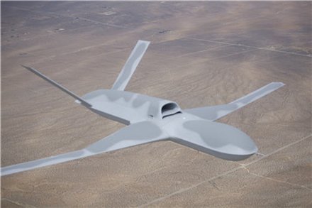

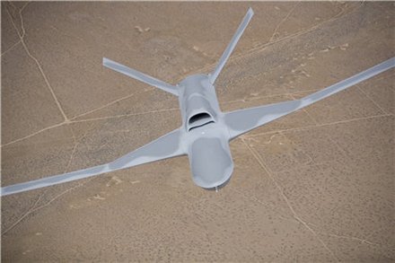

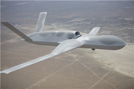

No weapons bay OR external hardpoints visible.
ummm....the landing gear is on the wings, so theoretically the fuselage under the wingbox is available for sensors - just a guess ???
A long, featureless underside further provides an ideal location for a sensor such as an all-weather, active electronically scanned array (AESA) radar. The wide-area surveillance system - to be provided by the U.S. Air Force - has yet to be defined. It would be carried by a specialized all-reconnaissance version of the Avenger.

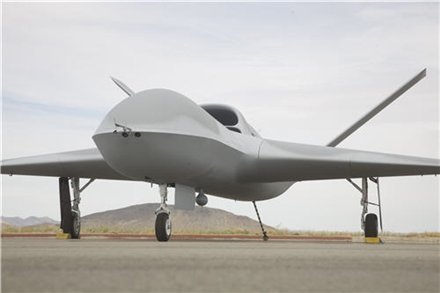

I'm assuming the football shaped C band LOS antenna is for testing only...
If this thing is really meant to land on a carrier, then it better have a twin nosewheel.

Thanks - but please attach images via forum rather than linking to image hosts. Its better for people on slow connections (thumbnails) and also means the pictures will be kept online.
Does anyone know if there is anyway of telling whether the tailhook is of the Navy type or Airforce type just by looking at it?

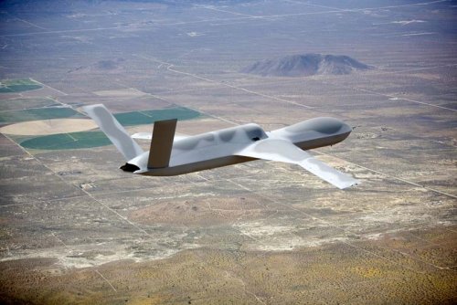

It does have a weapons bay, and, I would suspect, a pop-out sensor turret. I would say that it offers a covert option rather than being fully stealthy.
one really hi-res pic of Avenger
Any further information on this ??
