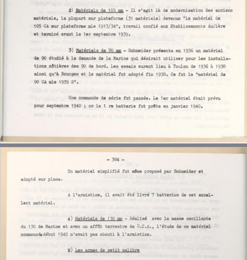

I don't have much further information, but this passage from the (Google Books preview of) Pierre Hoff's book on the armament programs of 1919-39 confirms that the conversion of the 130mm naval gun to land-based AA use was a real project. My French skills are very poor, but the relevant passage under "Matériels de 130 mm" essentially says that a design study for an terrestrial anti-aircraft mount of the 130mm naval gun began in early 1940 but was not completed before the Armistice.

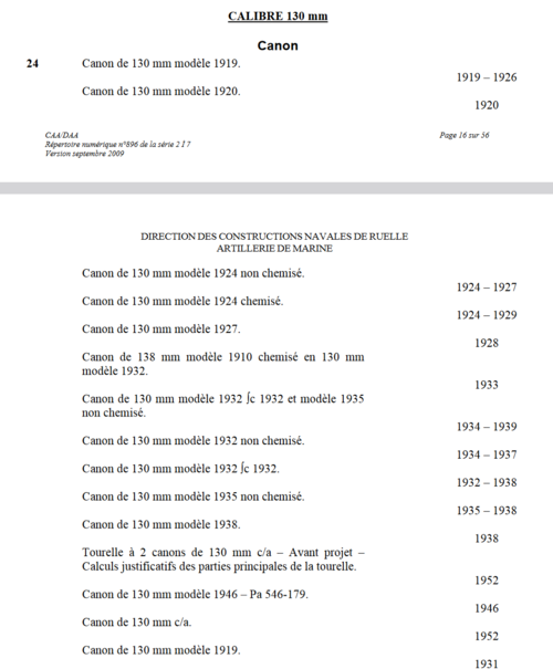

On this note, however, the Châtellerault naval guns archive index does have mention of a "Canon de 130 mm modèle 1946" and a 1952 "Canon de 130 mm c/a" (Contra-avions?) with an associated turret project. If anyone knows further information on this I would love to hear it.
