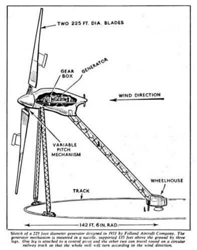

I just spotted three errors in the Fo list in post #6.
Fo136, 137 and 138 were not aircraft; the first two were related to aero-generation, i.e. wind turbines, and the last was unspecified research for the RAE.
Here is one example of Folland's research carried out as Fo136 and Fo137
Many thanks for this correction. Apart from the interesting project, (though no aircraft), it
shows, that lists with designations can misguide. Well, who reads about the "Messerschmitt KR 200"
shouldn't expect an aircraft, too ! ;)
