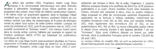

Okay, why? This article describes various Stipa concepts being proposed or tested in the wind tunnel at Saint Cyr.
I'm aware that the Stipa Type 203 Bn4 was assigned to ANF-Les Mureaux for réalisation (by the Ateliers Nord France). But do we have any evidence that these other Stipa concepts went beyond the IAT/STAé wind tunnel at Saint Cyr?

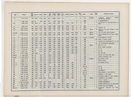

From Aviation magazine 1963,
the first time to hear about Potez-231 ?.
