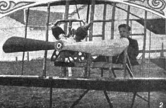

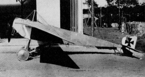

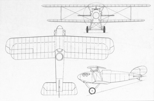

I have a picture to Daimler Lustosky No.1 monoplane,has anyone a picture to Daimler
CL.I ?.

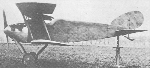

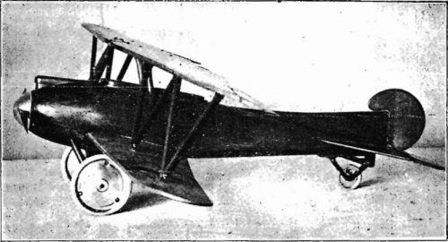

Boris Loutzkoy (Борис Луцкой) was a very interesting automobile and aircraft pioneer. You can find information on his aircraft in Vol. 1 of Shavrov's Istoriya and on the net on http://rusaviagold.narod.ru/HISTORY/lutskoi.htm (in Russian and with illustrations).
what was this Otto aircraft,and a project or not ?.
http://www.luftfahrt-bibliothek.de/zeitschrift-flugsport-oskar-ursinus-luftsport-luftfahrt-luftverkehr/luftsport-luftfahrt-luftverkehr-flugsport-1916/zeitschrift-flugsport-1916-luftsport-luftverkehr-luftfahrt.htm

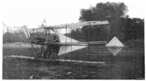

Grade Types:
Type A (1906)
In 1906 he built the Grade Type A, an unsuccessful light aircraft which did not leave the ground.

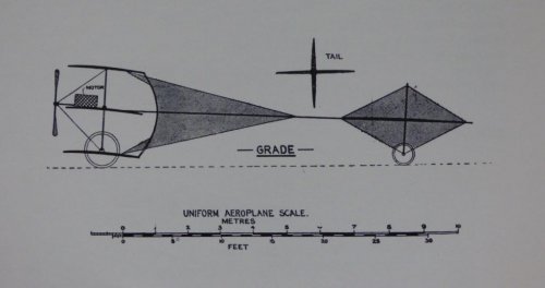

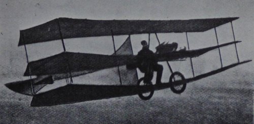

Triplane (1908)
The pilot sat behind the small engine and the aeroplane had three wheels, one to the rear and two apparently through the lower wing. The wings were bout 2 feet (0.6 m) apart. The top wing was straight with the two lower wings curved up slightly at the end. Steering was by means of a rudder behind the main wings. It had a cruciform tail.
This design flew on a regular basis and Janes All The World Aircraft 1911-12 stated that it “was the first German machine to leave the ground” on 28 October 1908 when Grade successfully conducted his first motor-flight over Magdeburg.
The basis layout was adapted for the monoplane of 1909.

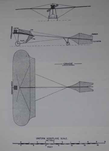

Monoplane (1909)
Developed from the earlier triplane design with the removal of the top and bottom wings. On the 17 August 1909 the first flight of the Grade Monoplane, named Libelle "Dragonfly", was made in Bork (now Borkheide).
In September 1909, he made the first recognized flight of a German designed, built and powered aeroplane from the Johannisthal Aerodrome in Berlin.
Grade had a mishap in late September 1909 at the Mars flying ground near Berlin when the airscrew detached when the monoplane was at 30 metres altitude. The aircraft crashed but the fall was cushioned by pine trees. Although badly damaged the simple design meant that the aircraft was repaired a few days later.
On 30 October 1909, flying the new monoplane design he won the 40.000 Reichsmark "Lanz-Preis der Lufte", for the first German to fly a figure of eight route in a German aircraft with German engine around two pylons 1,000 metres apart. Following his success Grade made four flights of around 5 minutes each the next day.
Although his first flights were little more than hops, by November 1909, he had logged a journey of 55 minutes duration with the monoplane design.
The design was refined, eventually ending up with a nacelle for the pilot replacing the seat hammock arrangement. Oyher early flyers built their own take on the original design including, Onigkeit, Riemay and Phoenix-Fliegerwerke mentioned in earlier posts.
On May 14, 1939 he re-flew his original monoplane from 1909, then 30 years old, at Berlin Tempelhof Airport for about 550 metres to celebrate his sixtieth birthday.
The monoplane had a tubular steel chassis with a single member which ran aft to support the tail. The aircraft had single spoke wheels forward and a smaller spoke tail-wheel under the tail. The landing gear had no springs or skids.
The pilots position was low down beneath the wing in a hammock seat. The used wing warping on the trailing edge. The main planes were strengthened by wire stays. The Grade monoplane featured a triangular vertical fin under a frame positioned just rear of the main tail planes.
The 24 h.p. engine weighed 35 kg (77 lb) ran the two-blade metal airscrew at 1,000 r.p.m. The propeller was directly attached to the crankshaft, Steering was via the elevator in the tail (which also contained a rudder) and control was via a hand lever.

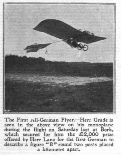

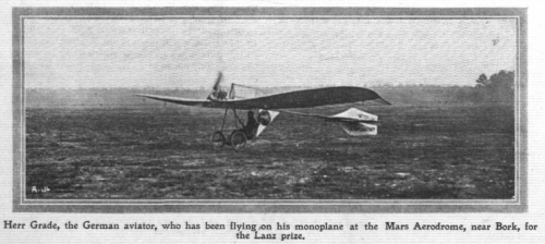

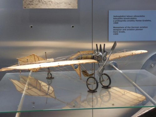

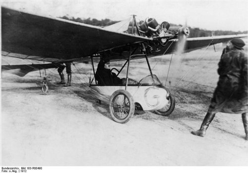

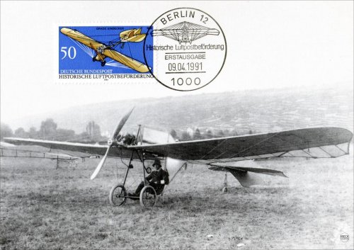

Some more images of the Grade Monoplane including a model in the Prague Technical Museum, special edition postal stamp issue from 1991, a modified Monoplane with a nacelle pod instead of the original hammock seat and a detailed view of the bracing arrangement.
Sources as in earlier post.

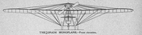

All sources agree that the 1908 triplane was Grade’s first aircraft, but you mentions a 1906 “Type A” as his first (but unable to fly). As in early German aviation history all things are possible, what are your sources for this 1906 precursor?
From my usual German sources:
“Grade genealogy”
1908: Hans Grade begins building aircraft (triplane and Libelle) in Magdeburg.

Dreidecker (1908). Triplane built in Magdeburg with 36 hp engine and 25 m² wings. Modified in Winter 1908/09: 50 m² wings.

Re: Grade 1906 design
Source: http://www.philaseiten.de/cgi-bin/index.pl?F=1&ST=2750&da=1&full=1
A stamp/postcard site referred to Grade having little success with aeroplane designs in 1906/07.
(Possible that my translation is poor)
Dear Су-27, your translation was indeed correct, but allow me a small nuance. The text comes from a letter of the grandmother of the writer, who was the wife of one of Grade's collaborators. She writes that her husband (occupied in Grade's engine factory established in 1905) didn't like Grade's unsuccesfil aircraft projects of 1906/07. She writes clearly about projects (Flugzeugpläne) and not about actually built aircraft. In 1906/07 Grade was primarly occupied with engine construction and motorcycling, but it is possible that the first ideas which led to his 1908 triplane arose in those years...
I wonder if we can consider this letter as a serious source, so much the more that serious aviation historians all agree about Grade's aviation career.
By the way, many thanks for the hint to the website. I really enjoyed the collection of old postcards.
The 1906 date may be my typo as well for the early Grade, Tuizentfloot. I did a bit of digging and the book by D.A. Sobolev on early aircraft (ISBN 5217002980 Pervye proekty i konstruktsii - Рождение самолета : первые проекты и конструкции ) was one of the sources used for my initial notes years ago and it quotes a date of 1908, not 1906. The book has been filed (in my attic) but has now been found!
I enclose a scan of the entry for the type he calls the Grade-1.
Sorry about the image but the paper used was not of a good quality, but it does show the type with its large paddle-type propeller blades.
I think we now agree, Су-27, and Sobolev is right (he’s a serious historian). The photograph of what he calls the Grade-1 is in fact the 1908 triplane.
Just one error or typo where he states B 1902 г. он начал строительство самолета. This is impossible: in 1902 Grade was still a student at the TH Charlottenburg, and after his studies in 1904 he began at first building his two-stroke engine which led to the foundation of his Motorenfabrik in 1905. Only in 1907 began his interest in aviation, and in Summer 1908 he began the construction of his triplane.
I also have a copy of Sobolev’s Рождение самолета, but I hadn’t seen it for years… Thanks to remind me…

And this was the Militäreindecker of 1912 with 70 hp Daimler and with engine and seats covered. After this single copy the military lost interest (problems with the chain transmission).

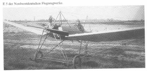

My dear hesham, I think I have found the answer ... (my usual sources).
Before WWI there were indeed light aircraft NFW E.1 to E.6, but built by another NFW, the Nordwestdeutsche Flugzeugwerke NFW, Heinrich Evers & Co in Bremervörde.
Heinrich Evers had emigrated to the USA, where he worked in the automobile industry, and where he became interested in aviation, witnessing the flights of Glenn Curtiss. In 1909 he returned to Germany, built aeroplanes from 1910, and founded the Nordwestdeutsche Flugzeugwerke NFW in 1912. Due to financial problems he closed his firm already in 1913, and went back to the USA, where he worked for Benoist. At the outbreak of WWI he returned to Germany, but on the way he was interned in France. He escaped and went working for Caspar. In 1924 he went back to the USA, working for Fokker, and returned a last time to Germany in 1936, to work for Junkers on the Ju-88.
In all he built six aeroplanes in the period 1910-1913 (plus one unbuilt project):
E.1: Single seater monoplane (1910) with 30 hp Hilz engine.
E.2: Single seater monoplane (1911) with 30 hp Hilz engine. Improved E.1.
E.3: Two seater monoplane with Hilz engine.
E.4: Single seater monoplane (1912) with 40 hp Hilz engine (also with Anzani). Copy of the 1911-12 Schulze Eindecker.
E.5: Single seater monoplane with Hilz engine. See photograph.
E.6: Two seater Pfeil-Eindecker with 50 hp Gnome.
E.7: Pfeil-Eindecker with Hilz engine. Project only.

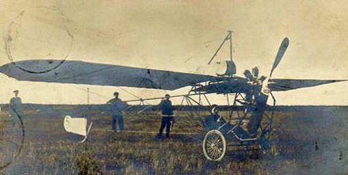

also the designer Hanuschke,which built a biplane in 1909,parasol wing monoplane
of 1912,followed by a single seat monoplane fighter of 1913,the later was based on
Fokker E.I.
http://flyingmachines.ru/Site2/Crafts/Craft28408.htm
http://flyingmachines.ru/Site2/Crafts/Craft28925.htm
http://flyingmachines.ru/Site2/Crafts/Craft29023.htm
Hanuschke was one of the smaller German early aircraft builders. The list of his aircraft is complete (biplane, high wing monoplane, Fokker-like monoplane), only there were three parasol or high wing monoplanes:

Dr. Waldemar Geest (1879-1944) was a medical doctor with a great interest in aviation, building model aircraft since 1896, and later gliders and motorised airplanes.
His first model aircraft of 1896 was of the flying wing type. Het continued to experiment with model aircraft and took a patent on his "Möwe" (Seagull) wing.
GEEST GLIDERS
1906 Glider: first full-scale construction by Geest, built by him during his medical training. Only short hops.
1908 Glider: wing area 11 m². Built in München in collaboration with Alois Wolfmüller.
1910 Glider: built by Gustav Lilienthal in Berlin. First flight in May 1910, crashed after a number of flights.
Weih (Harrier): his last glider (1910), built in Rathenow.
GEEST AIRPLANES
Möwe 1 (1910): two seater monoplane with 50 hp Argus engine. Built in Rathenow by a wheelwright Wietz. Short flights.
Möwe 2 (1911): with Gnome engine. Built by LVG in Johannisthal.
Möwe 3 (1912): with 50 hp Argus engine. Built by Wietz in Rathenow.
Möwe 4 (1912): with Arugus engine and arrow shaped tailplane. Built by Wietz in Rathenow. Very succesful.
Möwe 5 (1912): with 100 hp Argus engine and ailerons. Built by Wietz in Rathenow. Waldemar Geest had a flying school with the Möwe 3, 4 and 5.
Möwe 6 (1914): with 100 hp Daimler engine. Built by Richard Goetze KG in Treptow. First flight 17 June 1914. The wing was some kind of mix between his Möwe and the Taube, and had ailerons. A number were bought by the military.
D-Typ Doppel-Möwe (1917): experimental biplane fighter, built by Aviatik.
